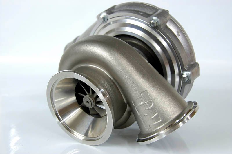

I would say "custom", and also experimental since if it flops I'll put my current setup back on....I don't expect it to flop, I think I'll really love this setup since it has the look of the twins that I like so much and with the smaller turbos the response should be very good. A few months ago I bought a nice used HKS twin turbo kit, knowing up front that I wouldn't use the GT2835's that come with it since they're too big/laggy for my goals. So now I have two Garrett GT2860's on order with those nice Tial stainless cast housings...like this:
We're going to cut the T25 flanges off the HKS manifolds and convert everything to Tial V-bands, including two Tial V-band wastegates which I'm routing back into the exhaust because no way I want my car any louder than it is.
