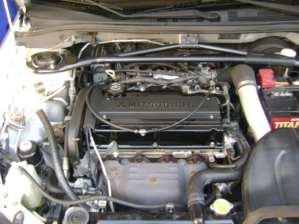

Here is a pic of my brothers evo valve cover we did at xmas. The cover was originally a maroon/burgundy color.
