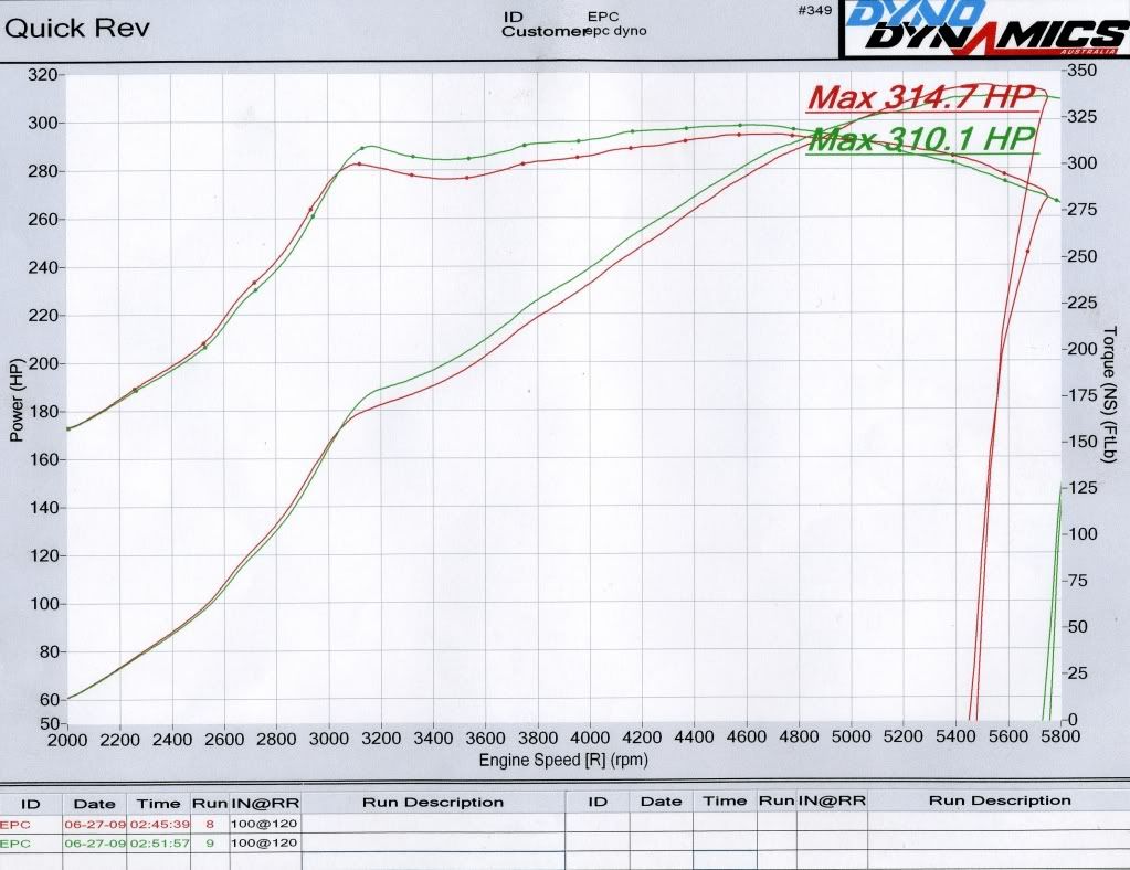

Stock Headgasket... not too worried on that one ither, already made 314whp on the 50trim with stock ecu on 90*F+ day
