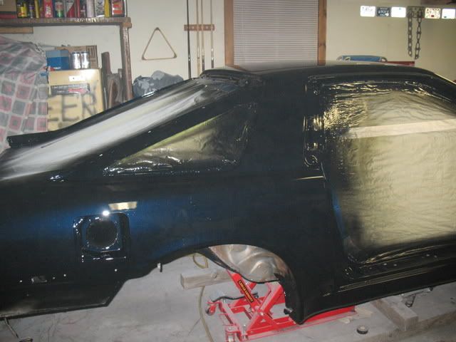

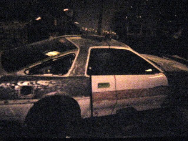

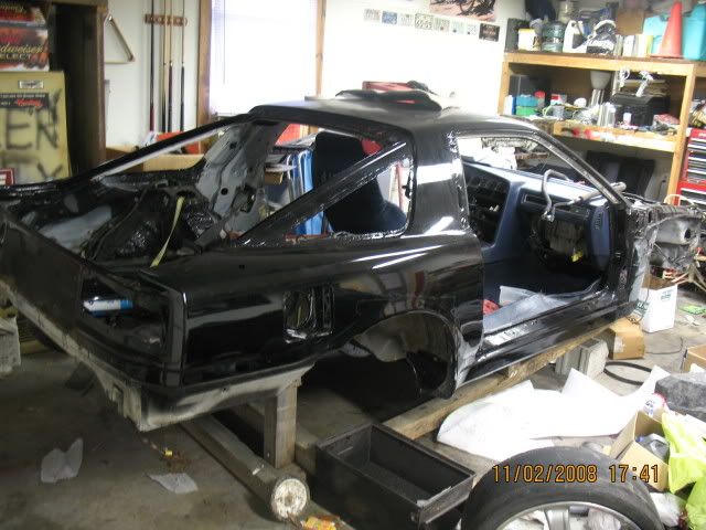

Looks damn near like mine when I started it.Found receipts for several paint jobs on it(all single stage white)there was areas with over 1/4" of paint build on them.Stripped the whole car to bare metal,then decided I wanted to go black,and got carried away. After I did the whole car black,I decided to add some blue pearl/candy to it over the black.It's close to finished,just been too cold to do paint work on it(just have to spray the underside of it now.)

Damn. I love how the blue pearl looks over the black!! i kinda wanna paint my car black. Because my last supra was black. good luck with the paint job though.
Thanks.It's kinda cool,as you walk around it the blue "follows" you,and fades back into black as you get farther away.

Yeah,been a REAL long road w/my car,I'm insanely picky for one,for two I really enjoy paint/body/custom work.That ,and I never want to have to worry about rust blistering through from anywhere,hence the bottom being done that way too.Actually been out in the garage tonight spraying all the fender wells and underside of the floor pans(that SUCKS)I've got a build thread somewhere,but have not updated it in quite a while,think it was still gonna be black at the time.
