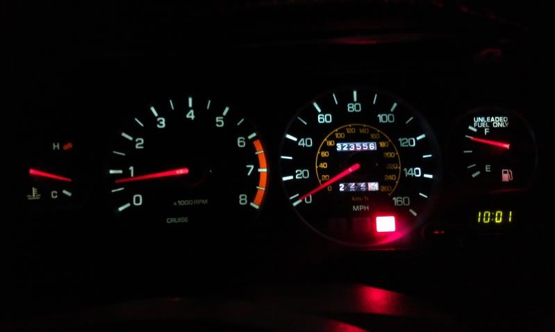

Do you guys have pics of these needles after they have been painted and used in your cluster at night time? I would like to see how well they still lit up after being painted over/under. Looks great during the day though!
Tons of pics in my lighting thread, here: http://www.supramania.com/forums/showthread.php?76463-Comprehensive-Lighting-Modification-Thread
Some of that info is here too, but I haven't updated everything yet: http://yotamd.com/toyota/mk3_supra/lighting.html
Scroll down through that lighting thread to see how well they light up with the LED needles. It makes a HUGE difference, but takes a lot of difficult work. Doing it cheaply with a lot of light "bleed" isn't too hard, but getting it as sharp as mine are now takes a good amount of extra effort.
Just painting the needles and with LED cluster backlighting:
LED needle lighting:

Wow the led lighting on the needles looks great. I'm not doing any extra lighting work so mine won't be anywhere near as nice.

I've had LEDs in my cluster years ago and i love them. I'd like to get the needle to look better but I'm afraid at night it doesn't get lit up being painted. You LED in needle set up is wicked but it's really hard to tell if the needle lit up well when they're painted paired with a LED cluster in a regular set up.
