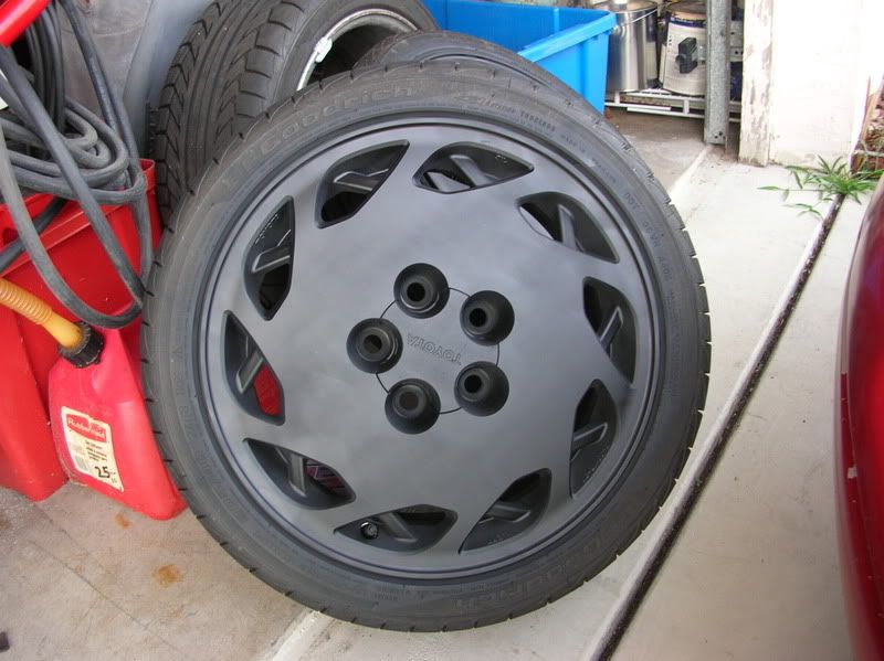

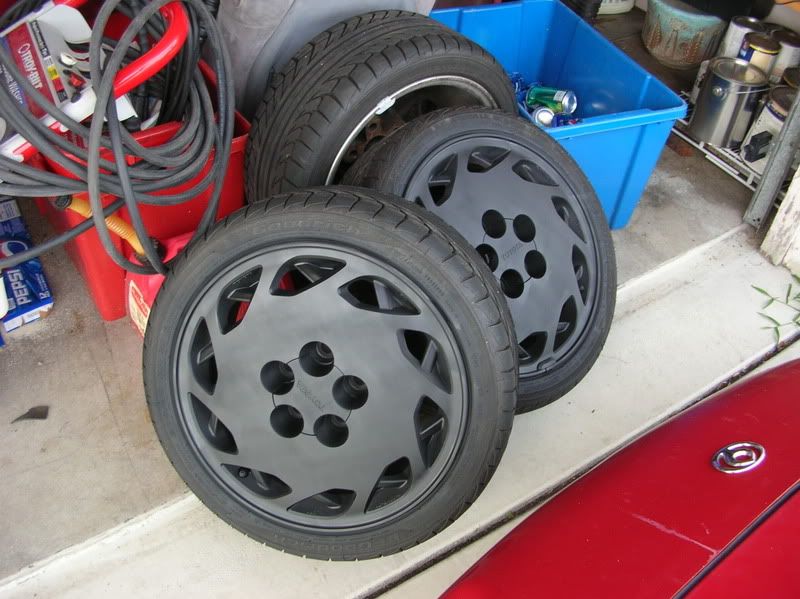

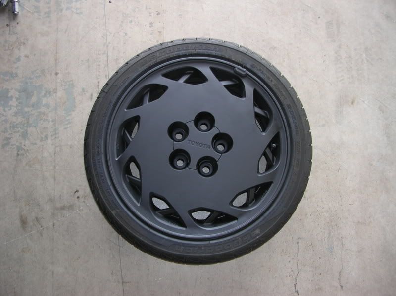

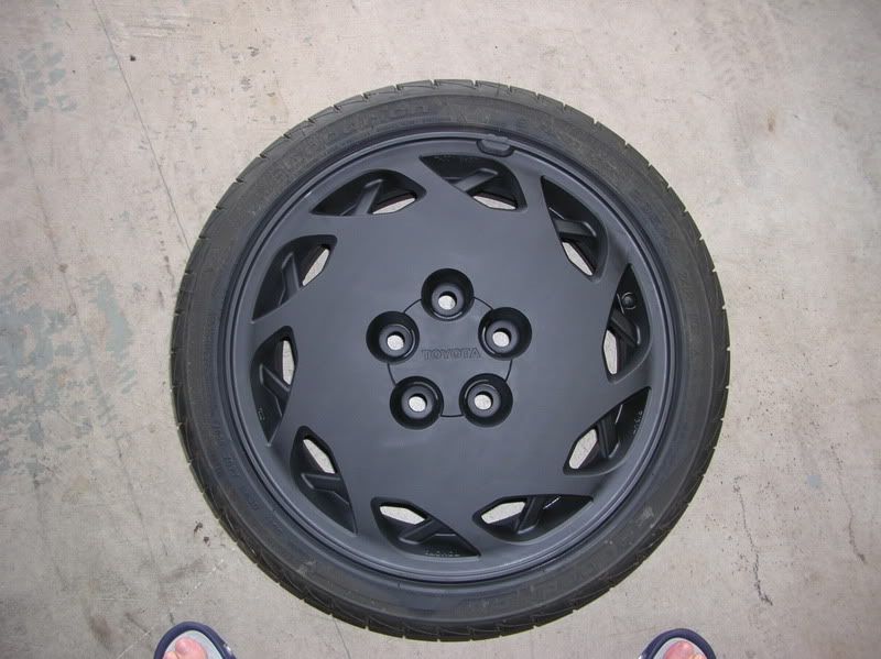

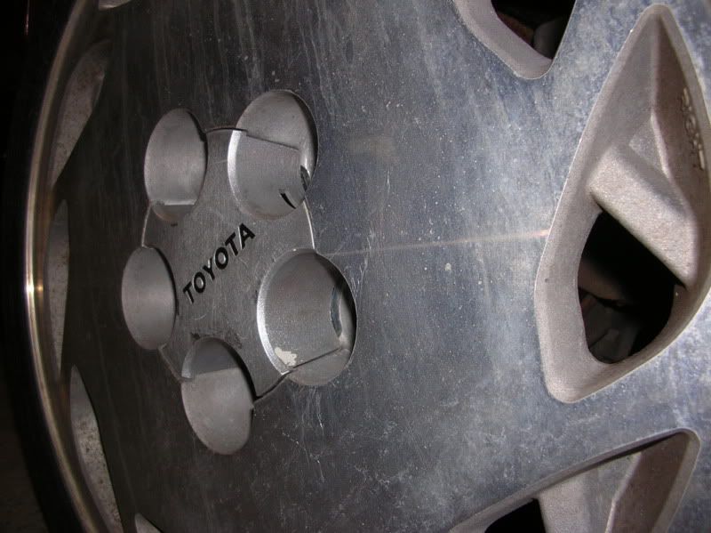

The newest update is now that I have painted my wheels finally.
At first I went through all sorts of trouble masking off the lip of the wheel. I would keep getting frustrated from it; enough to make it sloppy and useless.
After the first one, I said "fuck it" and didnt even bother masking the other wheels, which is good because the paint would not stick to the tire anyways! The spray was easy enough to control that it wouldnt matter much regardless.
I'm very happy with how it turned out. No sanding or prepping was necessary. I pressure washed the wheels after I found out about the intercooler, so they were as clean as I could get them without serious work.
One can of paint was just enough too. There are tiny spots that I'm not worried about which are hardly noticeable that could use some touching up, but I dont care enough; after all, they are sawblades and they look fine how they are now.
BTW, the paint was "flat black Krylon Fusion for plastics," which I was okay with using because it said "works with most metals" as well. I'll give them a clear coat later today.

well, you painted them flat, painting clear over them will make them gloss (unless you use a semi-gloss clear). I also think its funny how people think a layer of clear is somehow "protection". Unless your clear is powdercoat its just another layer of paint and if all you need is another layer of paint for protection, why not just put another layer of the paint you used in the first place. Like somehow clear is harder than other paint. I guess I could maybe see clear for UV protection, but on flat painted wheels that are going to get trashed pretty fast, I would just keep an extra can of paint around on hand to put a fresh layer on when they get banged up.
Not doggin ya, just trying to find the logic. I think you get the idea. No need to waste money on clear....UNLESS you WANT to add gloss to them. ;)

miekedmr;1099322 said:
there's a little bit of paint on your tires..
I was impatient when masking them off and didnt care enough to do it right because it wouldnt really matter. The day that I would do it professionally is the same day I'd put aftermarket wheels on anyways. If I were painting them some ricer lime green or white or something that wasnt close to the tire color, then I wouldve paid more attention, but those colors are gay anyways.

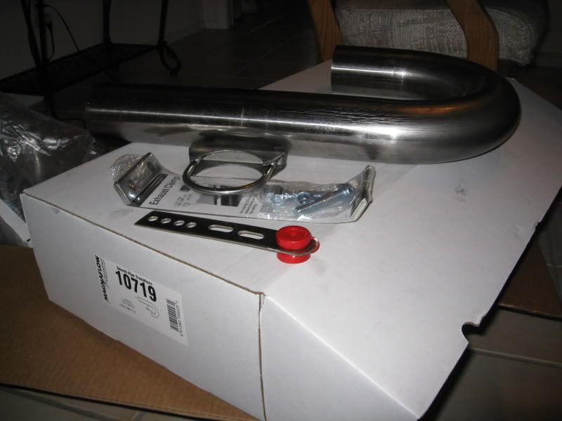

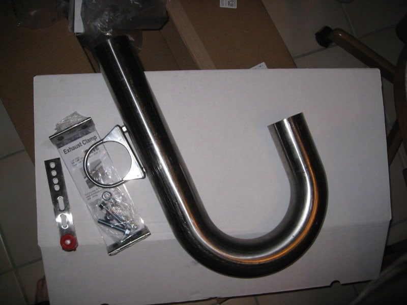

This arrived today. Tomorrow the Magnaflow muffler arrives (in case you were wondering, I went for this). Its one of the biggest ones they make in 3", though I opted for the 8" wide instead of 11" wide which is slightly shorter but probably bigger overall. I think it will help with clearance and such, since I'm thinking I will have it at sort of a V mount or as vertical as I can.
The idea will be to put my WBO2 at the end of the straight pipe, bolt the straight piping part to my downpipe, then use the bend as a turn down/turn off. I went for the 180* in case I need to replace some of my downpipe from an incident where I accidentally bent the bottom into a D pipe..

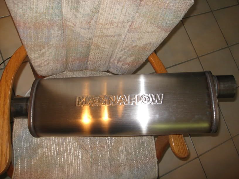

Muffler arrived! I've already done some crude test fitment. I'd really like to have it running next week, but we'll see. I still have to loop the power steering lines until I get a rack, rewire the e-fans, put the intake and dash back together, and obviously put the exhaust in.

Supra28;1210387 said:
I'm not a big fan of painted sawblades (I like them stock colored) but damn, yours looks real good. Flat black FTW!
Thanks man! It was just a krylon can with no prep work or anything and I'm happy how it came out. I'm not expecting it to last forever, but for $4 a can, its good enough.

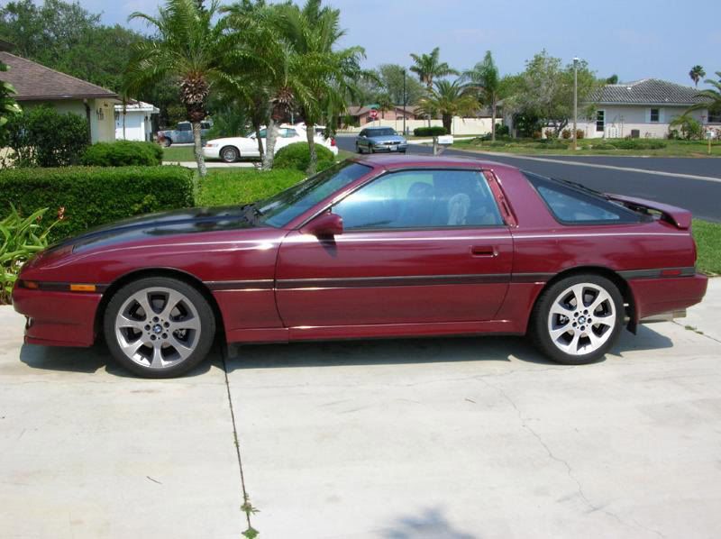

☼: I've been tinkering with the idea of switching to BMW hubs and using both the Ellipsoid 162 style wheels (330i/335i sport package) and the new 1 series 6 pot front calipers and 4 pot rears. Alignments will be easier with those wheels as well.
Here's a bad, lazy photoshop too:

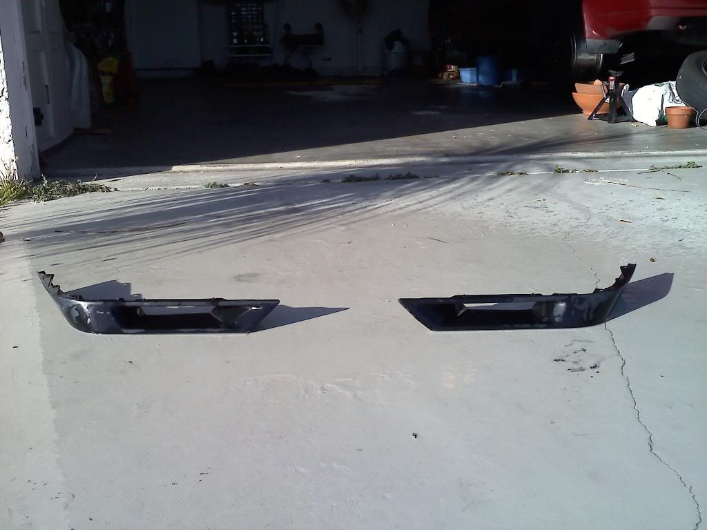

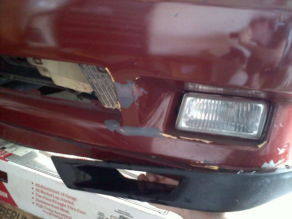

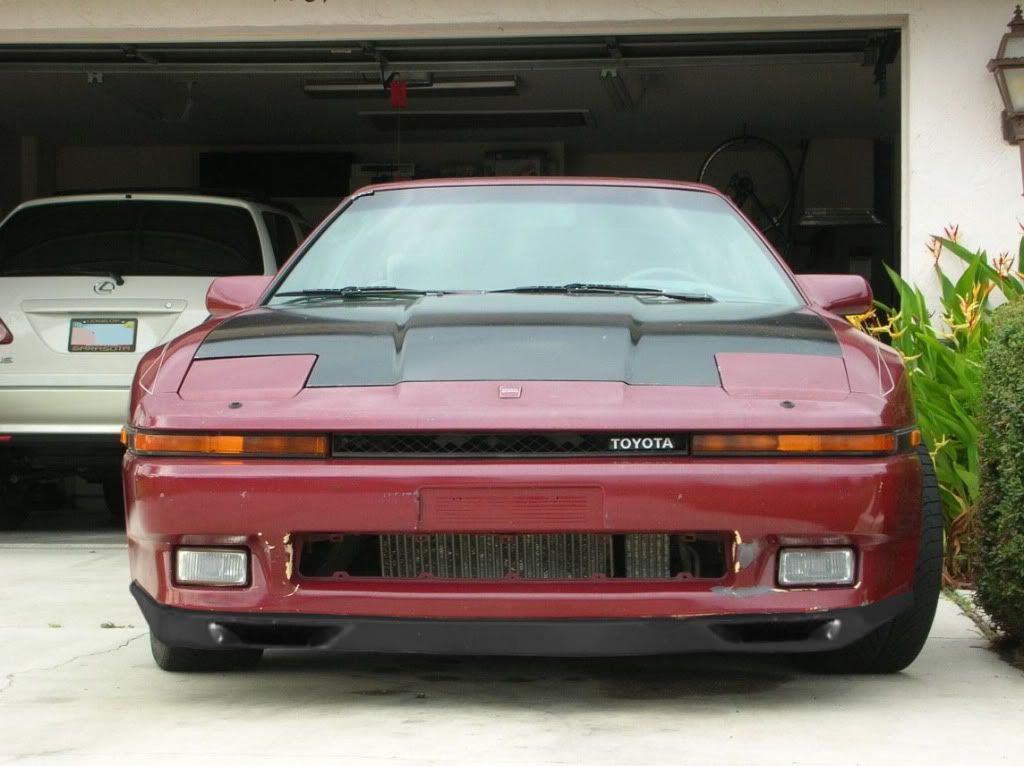

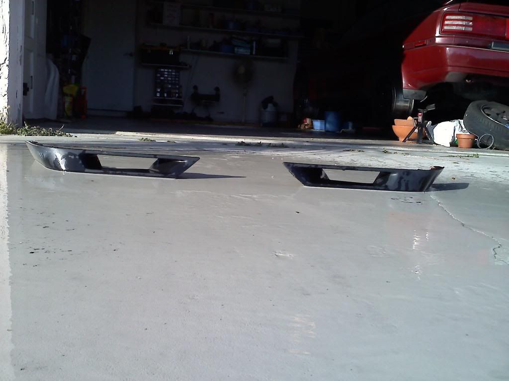

Okay, so I recently got the chance to grab some parts off of an E32 ('93 740i) before it gets sent to the junkyard. A BMW friend of mine wanted the headlights for his car, so we took those...and looked at what else we could grab. Taillights, roundel off the trunk, instrument cluster, airbag, turn signals, some interior trim...oh, and these:
I know lots of people like their 2 holes, their 3 holes, etc., but I never cared much for anything but maybe the JZA70 lip; but when I first saw this lip, the ducts caught my eye:
I plan on making a lip and molding them flush into it, so it doesnt look like they're just separate parts. The driveway shots are for dicking around with photoshop
