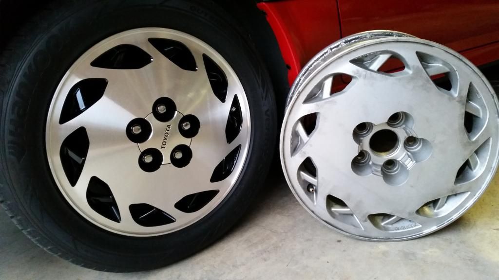

I received the can of Eastwood 2-stage clear coat a couple of days ago and shot the center caps today. They turned out great! Smooth and shiny. And I saved $177 by not contemplating that ridiculous quote of $200 the paint shop gave me. I already had a respirator with vapor filters so all it took me was a little wet sanding and fabricating a paint booth from a cardboard box. Not ready to repaint the Supra this way, though...I'd need to find a really big cardboard box!

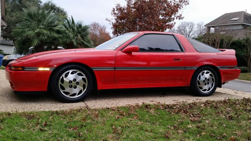

Well here's the final product. I think the wheels look great. The center caps are smooth versus the machined texture of the wheels but you don't really notice it until you are up close. What a difference from my original sawblades. The Fortune Auto 500 coilovers are installed and now comes the trial and error part of dialing them in to the ride I like. One thing I noticed immediately was the cornering improvement. Since the car has now been lowered an inch from stock there is a slight negative camber on the rear wheels. My mechanic compensated by giving the rear wheels a slight toe-in. He said this would prevent uneven wear and also give extra grab when cornering. It certainly does that. It feels like the rear end is following perfectly in line with the front tires. Feels smooth and very responsive.
