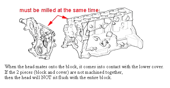

Ok i have a head i bought a few months back for a spare and to put together b/f the MHG gets here, to cut down on downtime. So we pulled the head apart yesterday, and the valvetrain is in GREAT condition. the parts im installling are, Titan 1.4mm, ARP studs, NA intake cam, and Brian Crower valve springs. Ok my big worry is getting the gasket to seal, im having the head milled by a friend, what RA should i get it to? As for the block, i was just planning on taking the head out, does the block surface need to be worked on too, i hope not?
