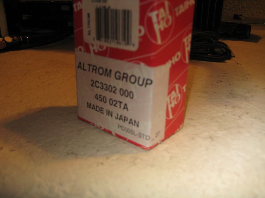

Yup I believe you are right about the lobe. There is even a hole in the side of the block for a mechanical fuel pump. I believe earlier versions of the block used a mech. fuel pump, IJ mentioned this somewhere, he will prob chime in on that. Also, the bearings are listed as Altrom, but they come in a TaiHo box. This is the box I got from Napa. They are special order more than likely but they can order them in for you. And more than likely they will size the bearing to the shaft rather than the other way around.

FWIW, Altrom is a napa "line" and not a manufacturer. They re-box OEM, OEM supplier, and "rare parts" manufacturer stuff. Some good stuff, some cheap stuff (like everything these days).
