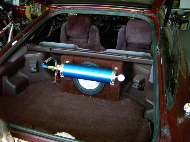

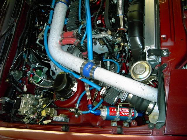

Adjuster
Hi Jetjock.
Where did you get the info on the Rotella T Synthtic oil being not a pure synthtic oil? (What I've read before says it is, and was compared to MobileOne, Delvac Synthtic and some others, and it came out tops price to quality wise.) I also use it in my KTM bike with no problems, but used MobileOne before that. I've used MobileOne in my cars for many, many years, always the 15/50 stuff, all winter long, no problems. Always used Wix/Napa/Purolator filters when I was not using the Canton stuff.
I agree the canton filter appears small, but it is the nicest filter setup for full flow I've seen in a automotive application.
I looked at the TP bypass filter, and ended up going with the OilGuard as I think it is built better than most TP units, and I don't mind paying a few bucks for a replacment filter v/s the price of a roll of TP.
Here is my oil filter setup. (Oil guard where the Evap canister used to reside, and the larger Canton/Mecca one on the apron.)
As far as dry starts go... There are none on my Supra :)
