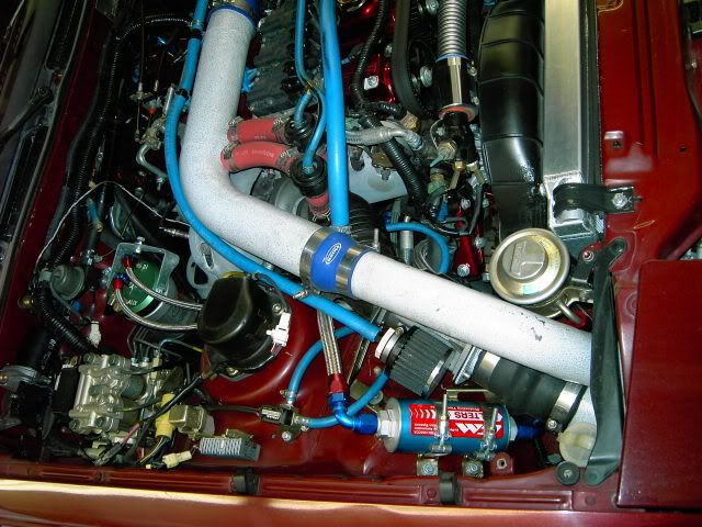

Supra's new fill is Redline 10 quarts, Canton/Mecca full flow depth filter, and Oilguard bypass. Should be good for awhile. :) In fact, I'll have it tested in this next year, and determine if it will need to be changed or not.

Here is my version of filter heaven. (Blue inline filter with the AN10 fittings on the apron is a Canton/Mecca full flow.) Stops particles down to about 8 microns, and has no bypass, so all the oil is filtered all the time. And it flows more than any paper type spin on filter, so there is less pressure drop even when dirty. (Green filter with the AN4 fittings and a sample port is from Oil Guard, it uses a wound cotton media depth filter, and stops particles down to one micron or better.) According to their website the average auto engine will pass most of the oil through the bypass filter about every 45 min. of use. Between the two excellent filters, and the Group V oil from Redline, this motor can't get much better oil or filtration IMHO.

About the same setup I went with thanks to your posts and my research. Don't think it can be beat short of a drysump setup.
