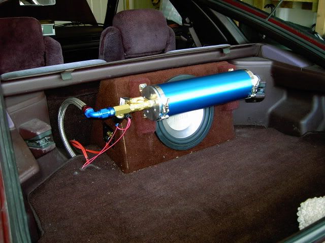

That stock, rare sub setup takes up the space I have my 5 channel amp located under the stock wood/carpet lift tray. (There is about 2" of space there, so you can fit a flat amp with careful planning...)
I made up my own sealed enclosure, and used a 10" Diamond Audio, magnesium cone/alloy framed sub in it..... (Running a 100watts to the sub, and 50w. each to the 4 diamond CF cone mid and tweeter combos and their crossovers in the stock locations, in modified boxes, and trim panels.)
Sounds pretty good. But then again, I'm not into rap, so the bass I wanted was just right from what I got/made/designed.

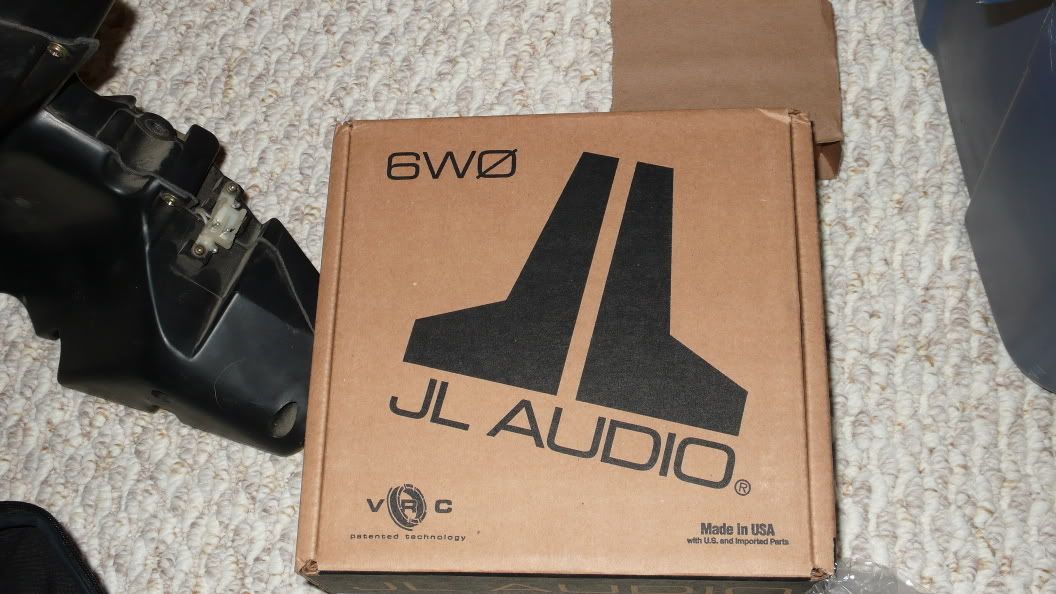

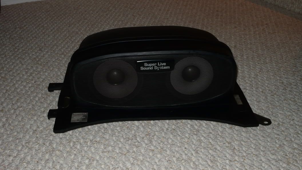

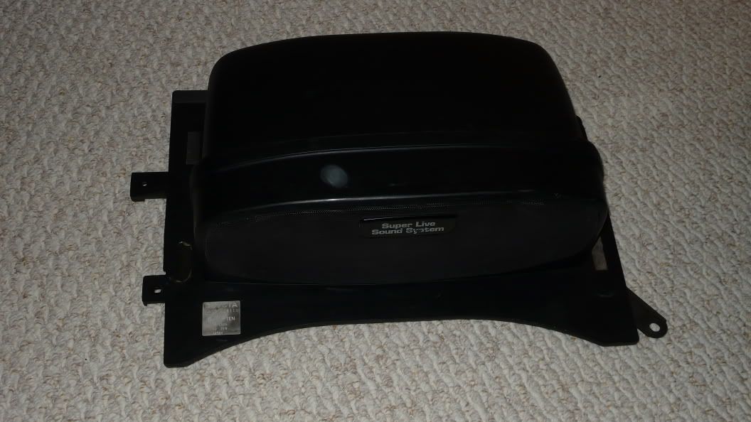

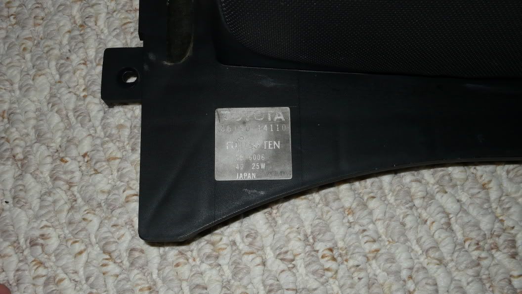

Look what arrived in the mail today!
For those wondering if the box comes apart, yes it does, and here is what is going in it. (just need to shave a little off the outer frames of the subs) The box volume may not be ideal for these, but they'll sound better than the paper stockers that are currently in the box.

that oem sub box look's like it's in nice shape.will the targa still bolt in with this thing in the back?
Adjuster
That OEM sub is in great shape..
On the subject of the way it's facing, the sub I built reflects the sound off the rear body panel and hatch glass, and I used the reflection technique to mount the rear tweeters, so they disperse the highs off the quarter glass, it works great.
I retained the stock jute and carpet, so the sound deadening is pretty good, and my spare tire is in the garage, so I keep a container with rags, a funnel, some wax and car cleaning products in that space, and that absorbs sounds too.
Also, my Subwoofer is oil dampened... LOL (There is about 3 quarts of oil in that blue tube that is my grille... The Canton Accusump.) When I installed it, there was a noticable reduction in vibration harmonics when playing music with lots of bass... So it's good for the motor, and oil damps my sub. ;)

That sounds awesome! However, when you open the subwoofer box, a pic of the inside would be nice! :)
Good choice on JL Audio. I bet that would sound awesome!

no carpet, but i did get the amp, and it is mint (too bad I'm not going to be using it) I'll get pictures of the inside of the sub box next week. The frames of the subs require a little bit of modification to fit the box, but it is just some trimming of the metal mounting flange, so it won't affect anything.
