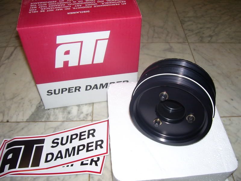

the only one the sell for the 7m that is stocked is good for 400hp-500hp at the crank SUSTAINED.
basically for every 100 above that requires 1 inch increase in diameter.
Ie for a sustained 800 hp at the crank requires a pulley with an 8 inch OD. ATI will tell you this right up front.
I have two of them in my hands, both rated to 600hp.

Rated by who? What is the OD of the belt grooves.
and if it was on my design, it is not a stocking part I can tell you that.
pn 918525 rated 600hp by ATI 5.5 inch Aluminum damper 3 pully

I don't have a pic of the paperwork or the lable but it says "600hp or less" right on the product lable and in the paper work. I would think these pullies are more than enough for most street driven 7m's
ok i don't think so
the 5.5 is the stock based one. When I designed mine. The engineers specifically told me what I posted. For every 100 hp increase the OD by and inch.
My ATI that is rated at the correct 600 hp is 6.5 OD not 5.5.

OK just got off the phone with ATI
that is the normal OEM based one. Keep it way UNDER 600 hp and you are good.
Figgie- Yep, I was just going by what the spec sheet on the damper says and what I was told bt ATI when I ordered them. Was told and read that they are good for 600 and under. Maybe they should stress the under part of that statement. Always good to jaw with you, remember all our debates we used to have over on I-supra.com back in the late 90's and early 2000's?
