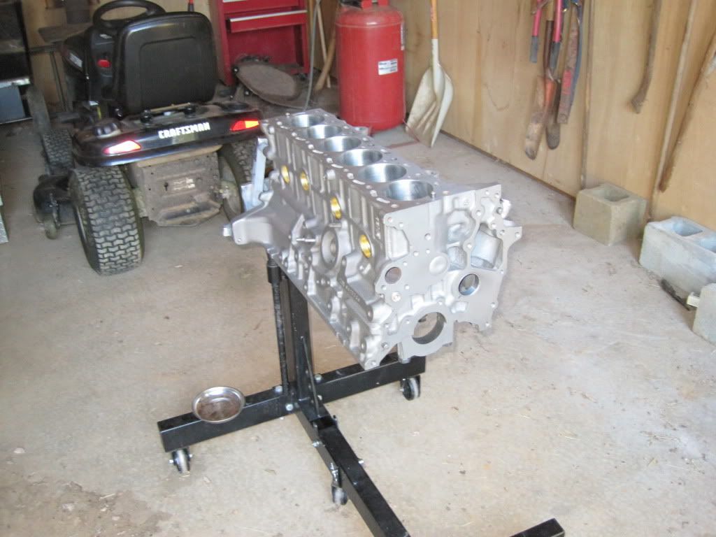

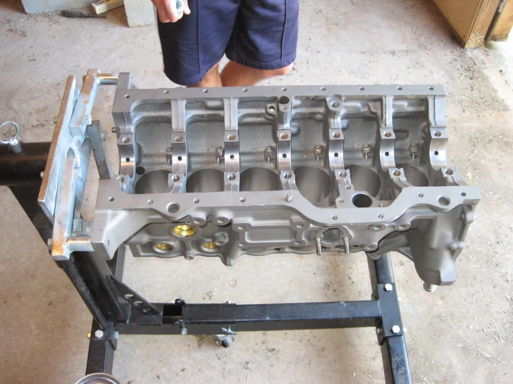

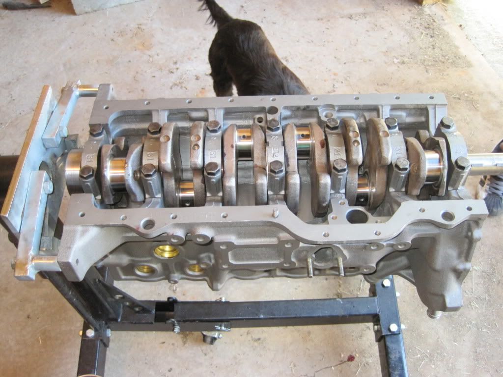

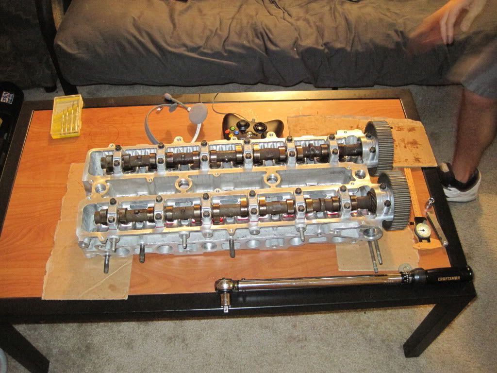

hornet7288;1631831 said:other than possibly getting new pistons I am just waiting on the MHG to come in and I should everything. Here are some random pics of the build.
mecevans;1632752 said:Ya post up some pics. Hopefully some other that have used them will chime in. I will be going with acl or federal mogul for bearings.
