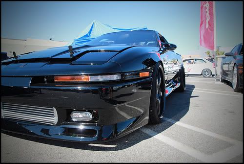

what was involved with the flaring of your front fenders Rodel? I'm assuming cut>roll>pump>bondo>paint?
No cutting. Just used a fender roller to completely flatten the fender and make it flare out, hammer and dolly body work, bondo, then finished it off with paint

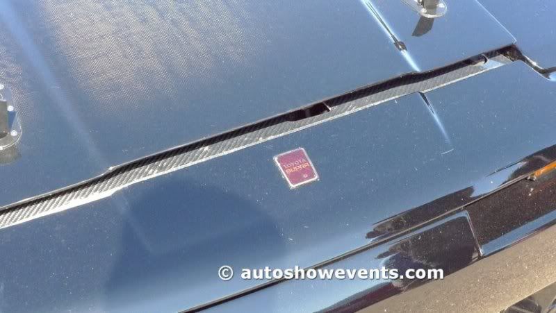

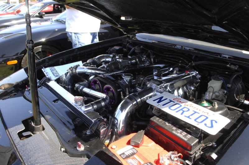

What went into "ghosting" the hood?

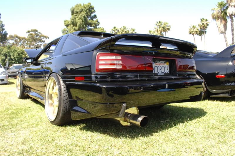

And the only nitpicky thing about your car that I can say is your exhaust looks a little low, other than that it's almost part for part what I wish my car looked like (but in red of course)

Ghosting is basically a fade. The edges of the hood are dark. The darkness fades towards the center of the hood.
The big canister, hanging low was my intention. The look I wanted.
The canister is actually mounted as far up as possible. Its a huge canister.

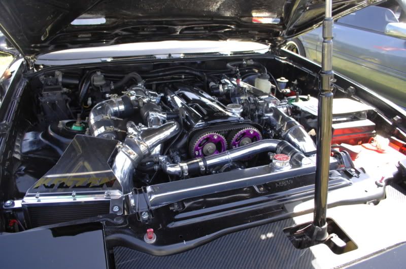

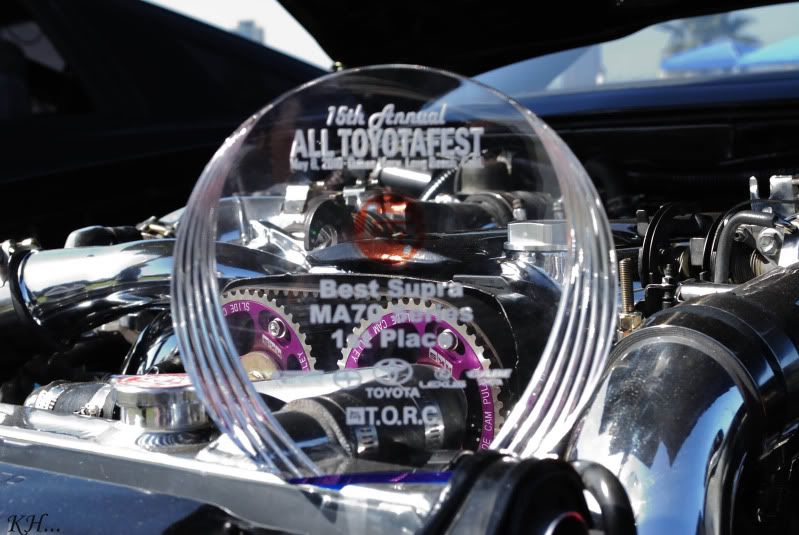

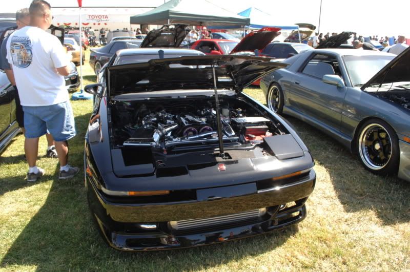

The next event for the Supra was Toyotafest 2010.
There were 2 major changes: the 2J swap and ARZ Performance front and rear brake upgrade. Props to Kaizen Motorsports.

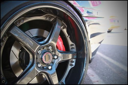

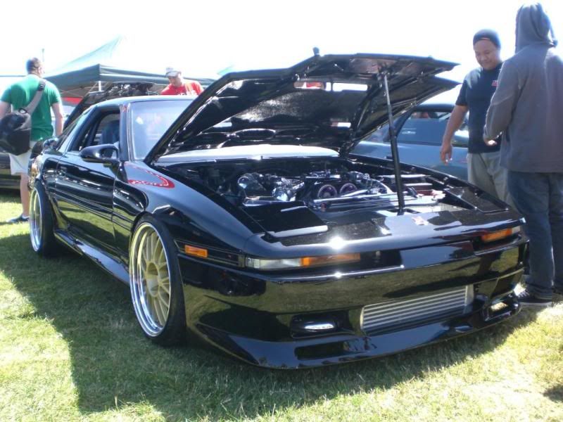

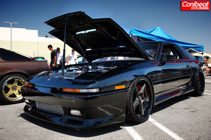

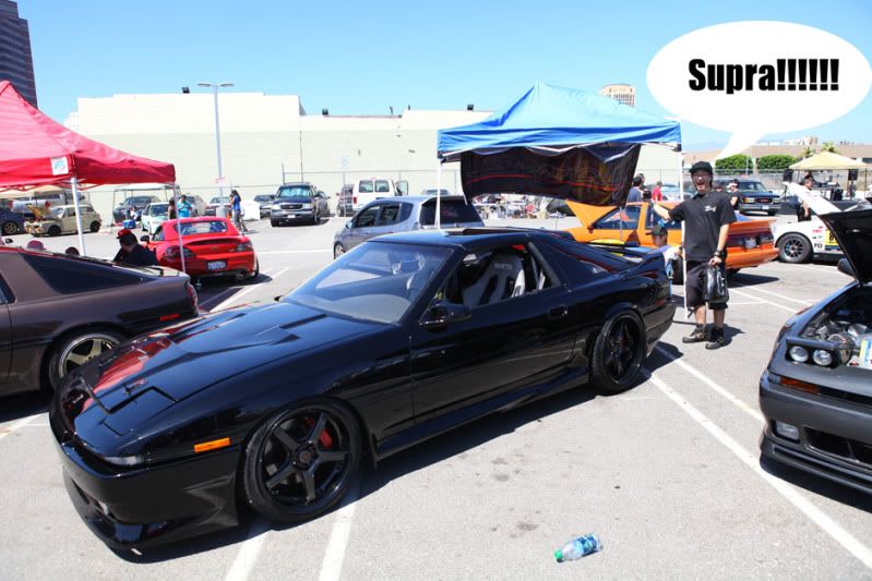

Thank you for the positive comments, gentlemen. Below are the most recent pictures, from the 2010 Nisei Showoff in Los Angeles, during the month of August. I didn't take pictures of my car, I found these in other websites.
The Supra MK3 enthusiast is not me (BTW, Nick's car is to my left.)

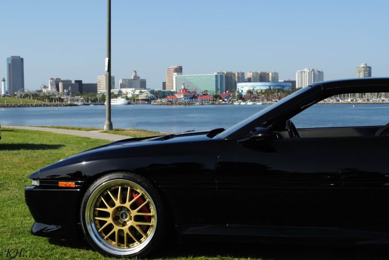

The only new addition from the previous meet, the 2010 ToyotaFest, was the Hella fog lights. Also I switched from the SSR MS1 to the Volk Racing GT-S.

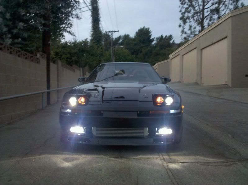

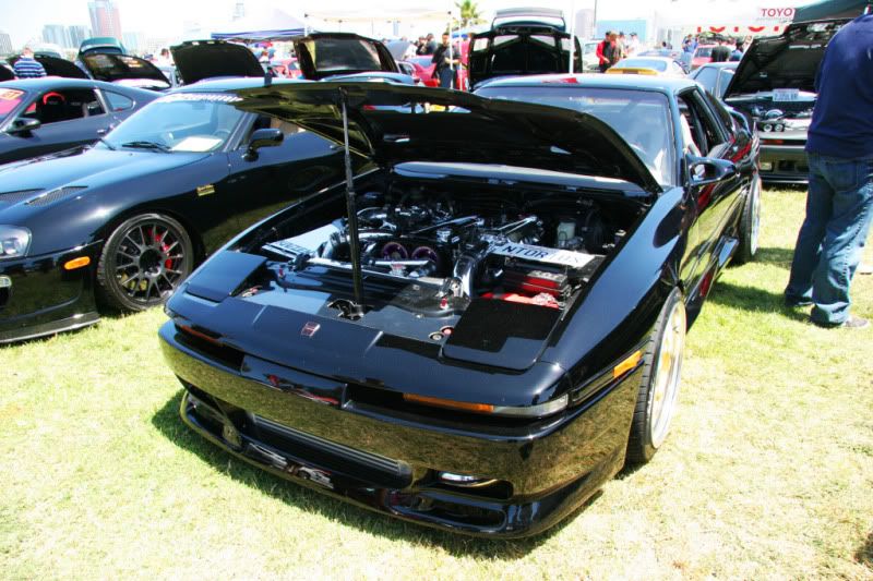

This is how they look turned on. I installed 6500K HID in them. I did the foglight mod. During day time driving, I turn them on for the daytime running light effect, but leave the driving lights retracted. In the evening, in the attempt to decrease attention from the po-lice, I turn the fog lights off.
These guys look either puzzled or curious about the "ghost" painted carbon fiber hood.

I assume those are the "city light" version of the Hella high beam modules? Explains the amber color if they are. Do you have them wired to have all 4 lights on when you pop the high beams?

The high beam lights are the D.O.T. without the city light provision. I have HID in the driving light projectors, so I never use high beam. There are H9 LED bulbs in the high beam lights, wired so that they come on with the driving lights.
I've actually had the GT-S wheels for over a year now. I switch between the MS1 and GT-S from time to time.

Engine
2JZ-GTE w/ JDM stock twins
550 RC Engineering injectors
Denso fuel pump
Aeromotive adjustable fuel pressure regulator
A.R.C. airbox
ARP headbolts
HKS metal head gasket
HKS adjustable Cam Gears
Drift Motion JZ Pulley Kit
Greddy Type-R blow off valve
Fluidyne radiator
Flex-A-Lite dual electric fans
CX-Racing intercooler w/custom piping by Kaizen Motorsports
CFX intercooler block-off plate
Exhaust:
Apexi Worldsport exhaust
Custom downpipe by Kaizen Motorsports
Transmission
Fidanza light flywheel
ACT clutch
C's short throw shifter
Electronics
AEM Standalone ecu
AEM UEGO wideband
AEM serial datastream gauge
Apexi turbo timer
HKS boost gauge

Hella 90mm projector driving lights w/ HID
Hella 90mm high beam lights
Hella FF75 fog lights w/ HID
