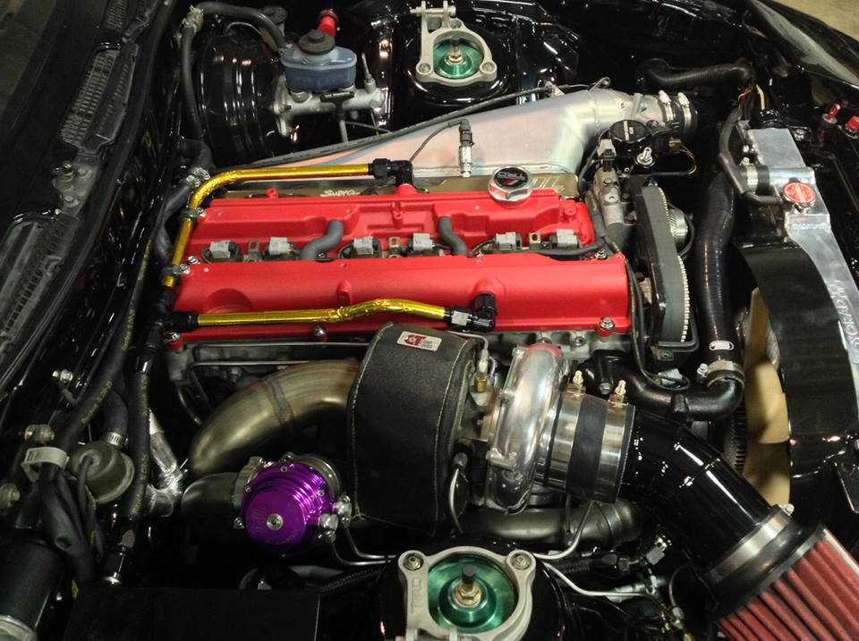

So you put a VVTi head on the earlier block yeah, not swapped the whole motor?

Reservations for more recap and updates .
Yes....vvti head was mated with my non vvti block. I didnt swap the whole motor.

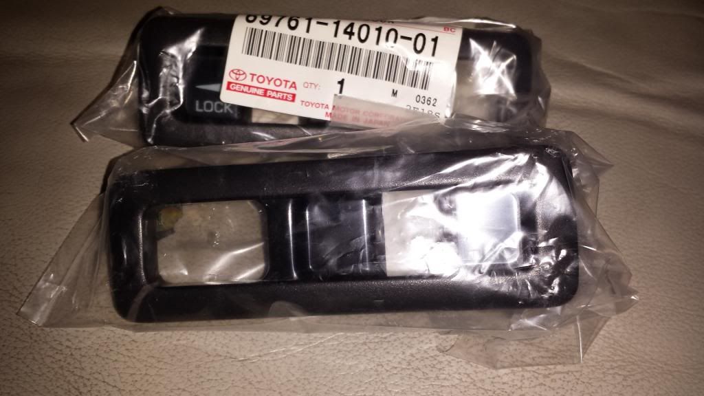

Some fun goodies that I bought at Japanese Classic Car show a couple of weeks ago.
I found the "Engrish" humorious, so I had to buy it.

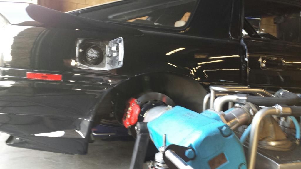

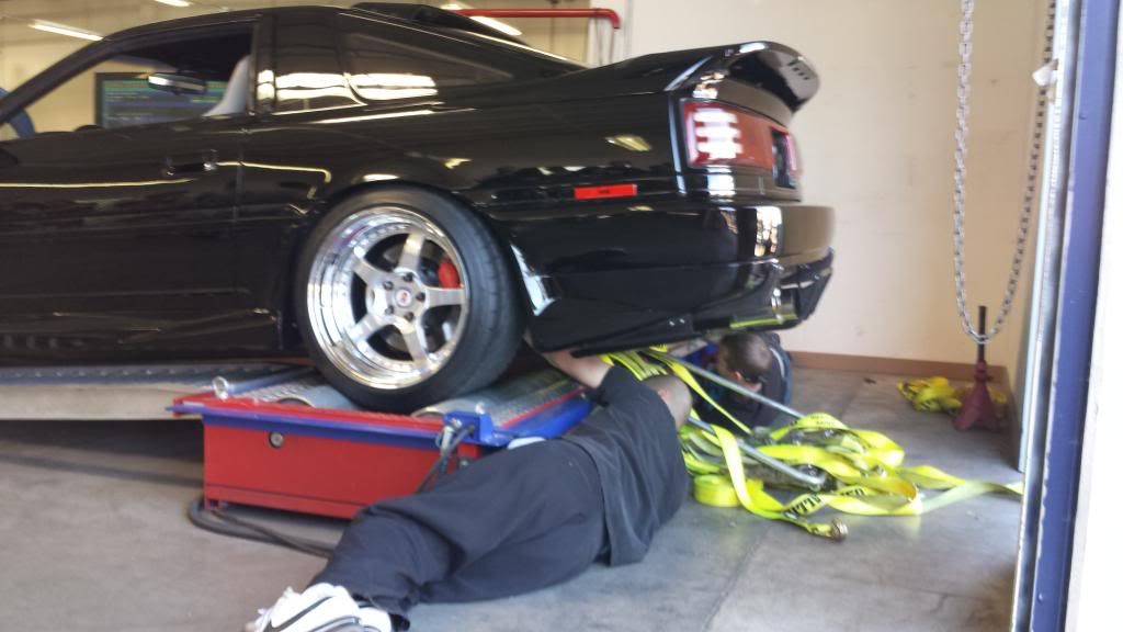

Car finally ran on Oct 1.
http://instagram.com/p/e3gWBjs5d0/

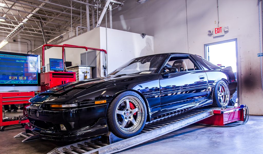

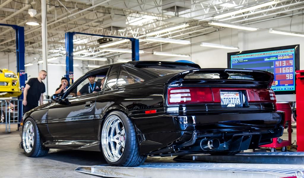

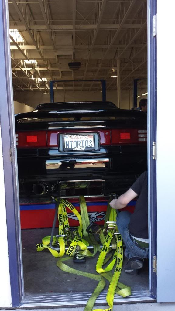

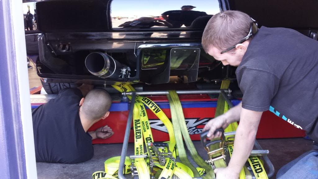

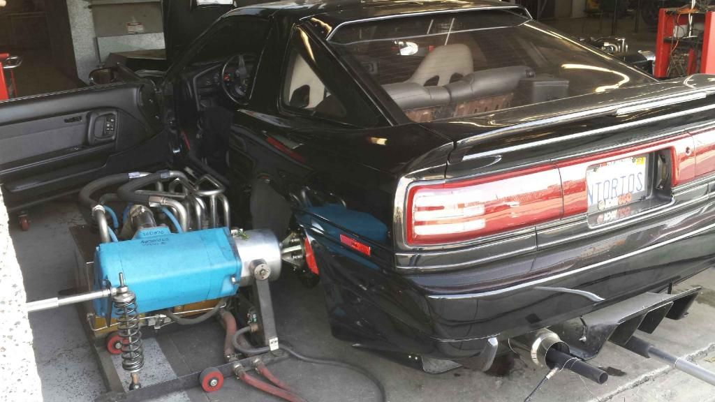

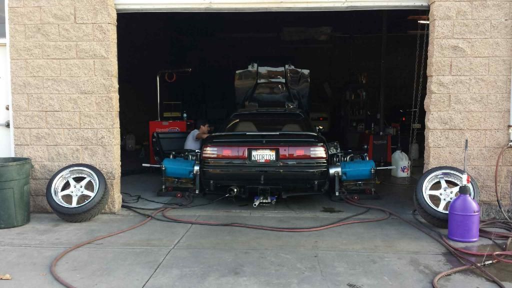

Dyno time on Wednesday, evening Oct 3, three days before Supras Invade Vegas (SIV) 2013 show and shine

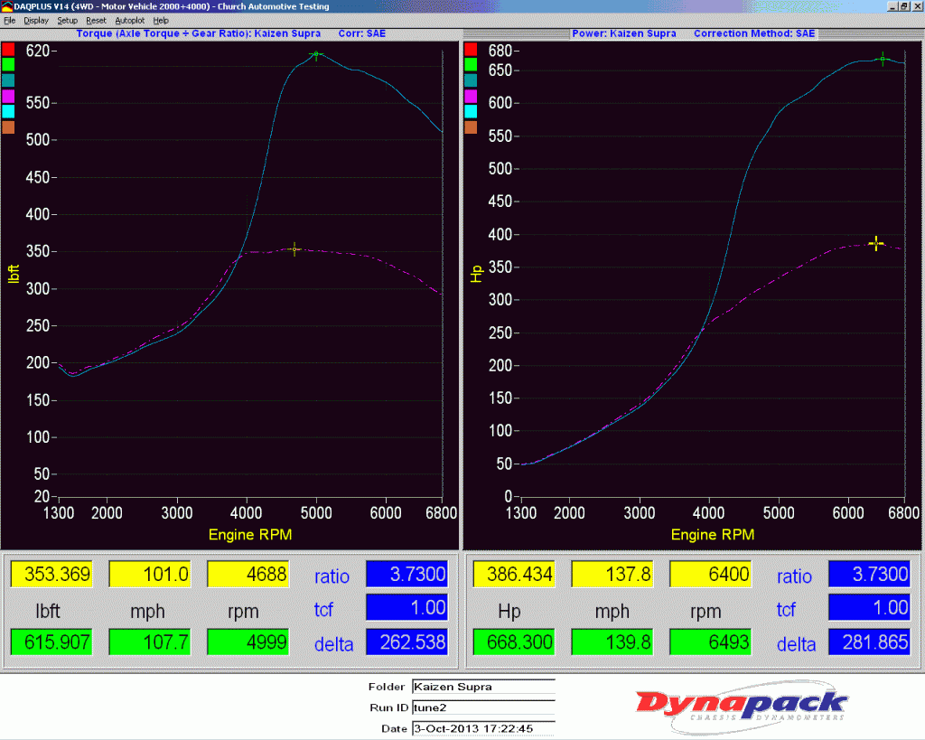

558rwhp and 600tq pull video
Jose (Kaizen Motorsports) in the white t-shirt. Daniel, in the black t-shirt, the tuner, of Church Automotive Testing

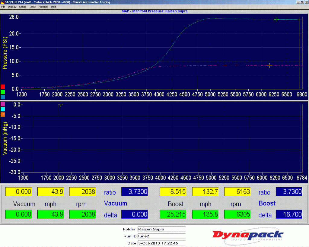

Final tune: 668rwph 615 torque @ 25lbs of boost on E85
Torque on the left side graph. Power on the right side graph.
Boost

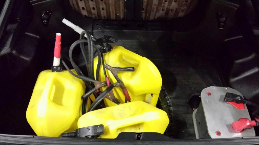

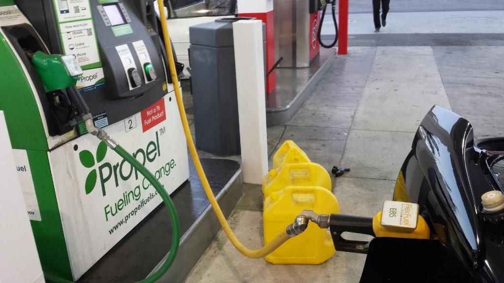

Fueling up on Friday evening, Oct 4, to make the trip to Vegas on Sat, Oct 5.
For extra measure: 15 gallons of extra fuel in the trunk.

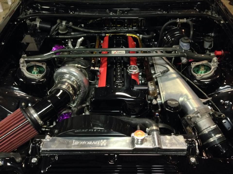

Kristian_Wraae;1970140 said:
That TRD strut bar looks out of place.
You should sell it to me.....
:naughty:
I should sell it to you, cuz it doesn't really function. :naughty:
