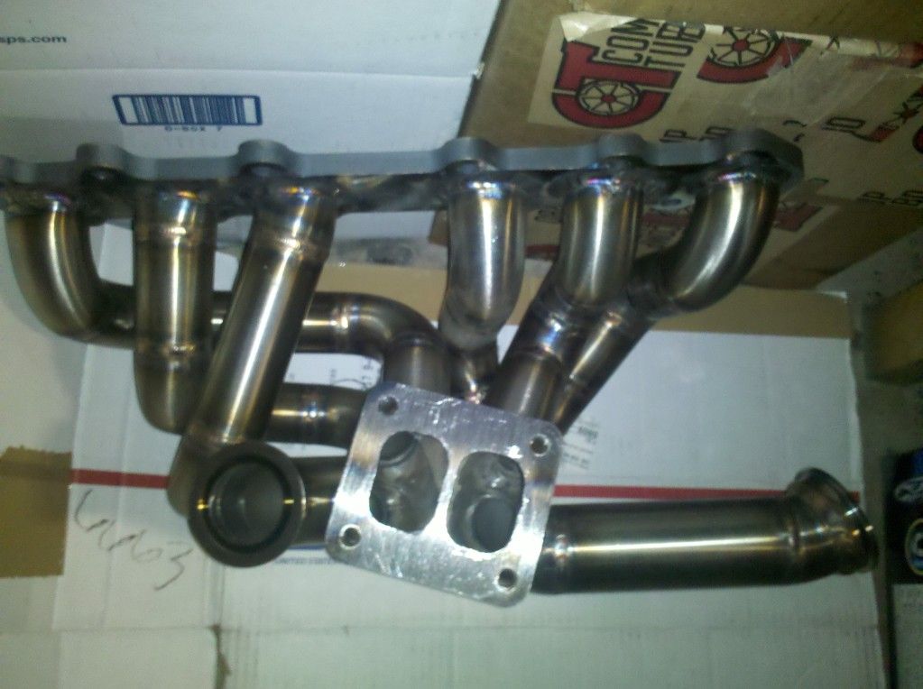

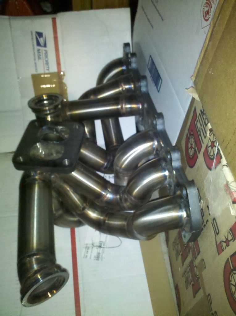

My manifold is finally done and fits.

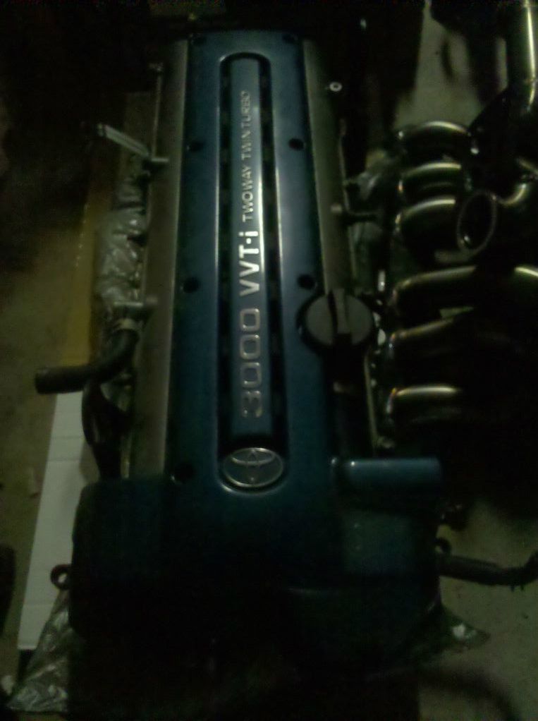

Here's a test fitment of the manifold/turbo/wastegate setup. The manifold is a twin scroll, dual wastegate setup. The wastegates are Tial. The Comp turbo has: anti-surge housing, 67mm billet compressor wheel, 0.68 turbine wheel, twin scroll exhaust flange, triple ball bearing, oil and water cooling. As part of the single turbo upgrade, I will be swapping to a VVTI head.
(This is not in my engine bay. We used another car for the test fitment.)

Hey man what wastegate size are those tials? 44mm or 60mm?
Both wategates are 44mm Tials.
