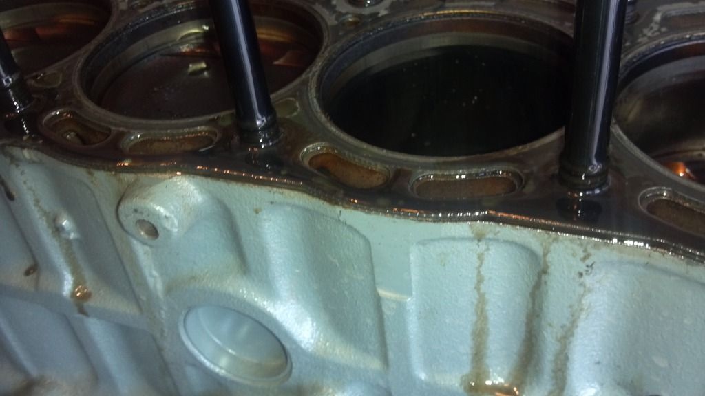

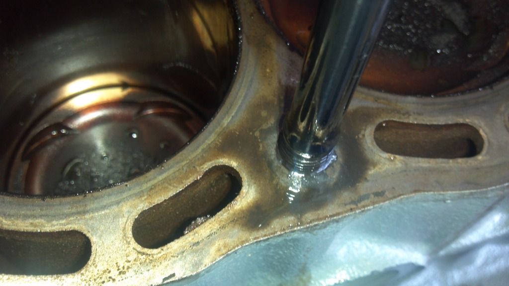

Ok ii finally got some time to work on the car. I pulled the head and really didn't like or understand what i saw. I have a 2mm metal head gasket with ARP studs. When i pulled the head off i was greeted with a thick oily film on the gasket.
Afrer pulling gasket off this is what it looked like.

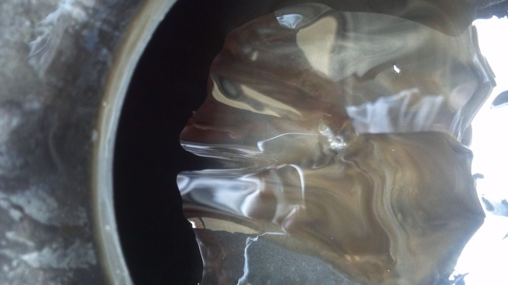

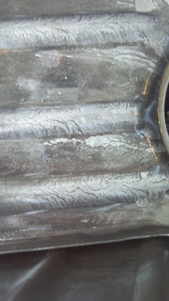

So it looks as if it is a HG issue right. Can a head gasket issue make it seem as if it's a bottom end issue when performing a leak down test? I'm at the point of giving up on this car but I'm realizing that some of this stuff isn't the cars fault but mostly the impatient owner. Is it still a good idea to take it to a machine shop and have them look at it? Also this is what i found in the oil pan. Does this say milkshake?
