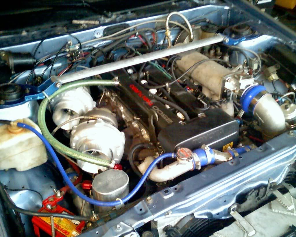

Twin 1jz;1057400 said:
Here are pictures of the engine.
Yes, is street legal. There was oil at the end of the track.
