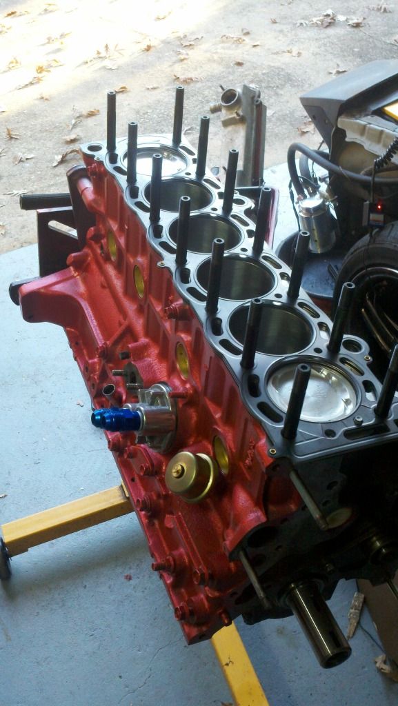

Hey man-
My build is going very slowly. I am making progress with the motor, though.
It'll be quite awhile till it's on the road, though.
After I get the engine and tranny done, I have to completely redo the interior, sound system, a/c system, and then the body.
Prolly won't be finished till at least summer.

I sure hope that you're planning to put the lower timing cover on before bolting down that head...
And OT, but I don't see how any BOV could be vented to atmosphere after the MAF and not result in the over rich condition from venting metered air, whether it's blow through or not. Maybe if the blow-through was between the BOV and throttle body, but that seems to be immediately post-turbo, unless I'm completely misinterpreting which pipe goes where, which is of course possible.

Um, yes. I plan on putting the timing plate on before the head.
I uh, also plan on taking the tranny out before swapping the clutch... :)
