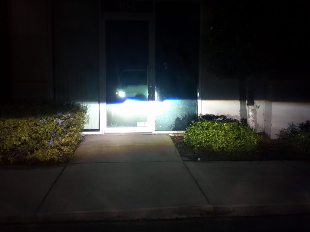

This is on my van and not the Supra, however I did these for under that price, replaced the factory 5x7 with my own custom setup.
Spaced bulb to give a nice blue/purple cutoff, shop glass makes the cut and step look fuzzy but it's actually quite perfect.
Of coarse this did require modifications, custom brackets, wiring, etc.

And would you do all that custom work and sell your complete product for under my price? If so then start making them because you'll have a huge buying market. My guess however is that you would value the complete amount of work and parts you put into it well over $250.
Am I wrong?

No offense, but you should have specified a PnP retrofit for under $250 then.
My point was only that it can easily be done with a bit of skill and knowledge. Lots of info on HIDPlanet.com
Hypothetically speaking though, I could sell a partial kit for that price. As in bracket/bezel/projector and you purchase your own bulbs/ballast.
