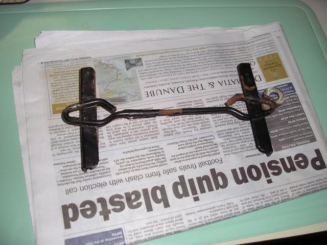

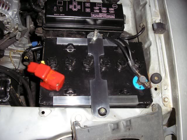

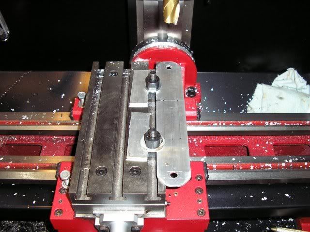

My battery tie-down was hideous. Not sure if this thing is factory, but it is definately ugly!
Work in progress:
Finished Product (bad photo):

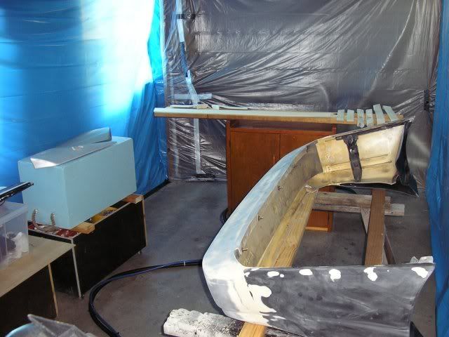

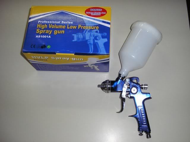

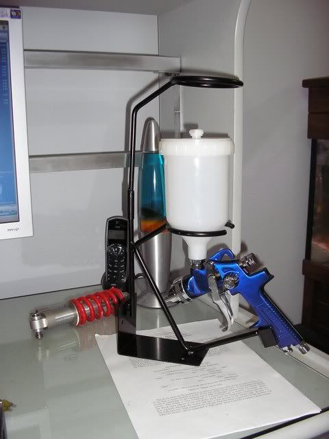

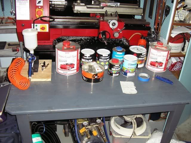

Finially made it to the paint shop this afternoon, and picked up what seems to be a well built but cheap enough HVLP spray gun.

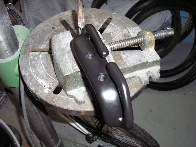

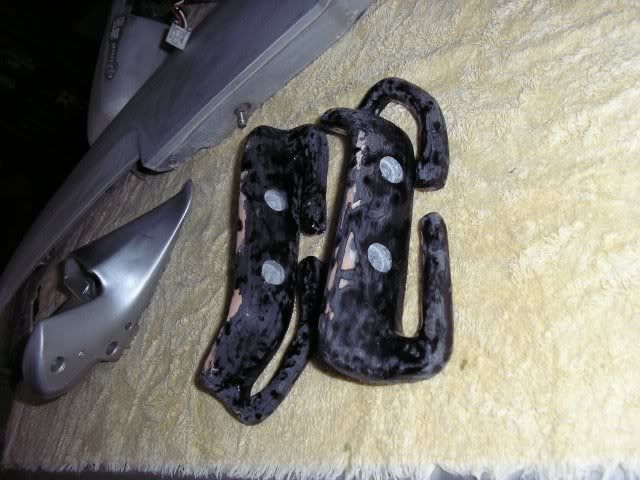

Also finishing what I started months ago with the seatbelt retainers. Countersunk the screw holes, and will paint them blue (to match trim) tomorrow.

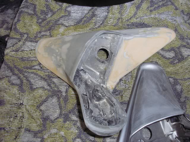

I polished a few things as well, but they came up crap so I don't be showing those ;)

I got a paint gun stand for 9 bucks. It is actually really nice and sturdy.

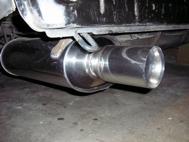

Cleaned up my exhaust a little. It's not stupid shiny, but it's heaps cleaner than the picture shows

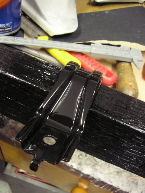

The seatbelt retainers are finially finished, just waiting on paint to dry. I tried gloss black and blue but they both didn't look right. Epoxy matt black seems to be the best option.

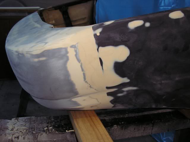

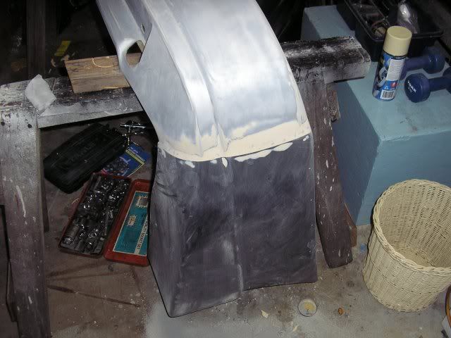

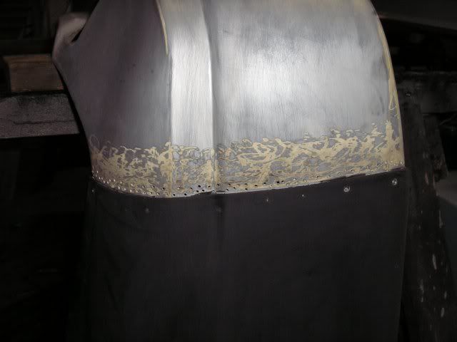

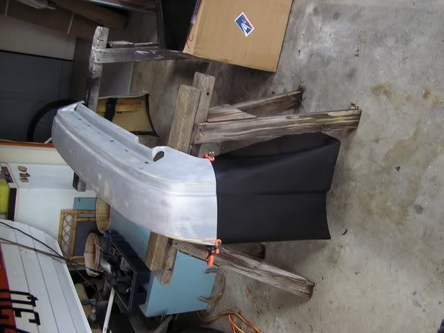

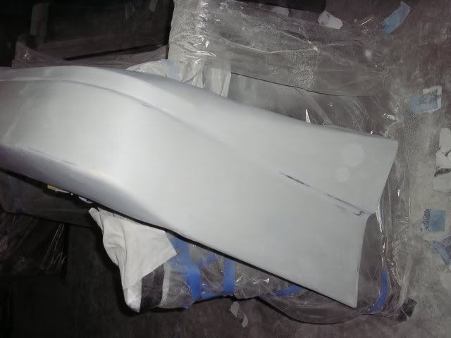

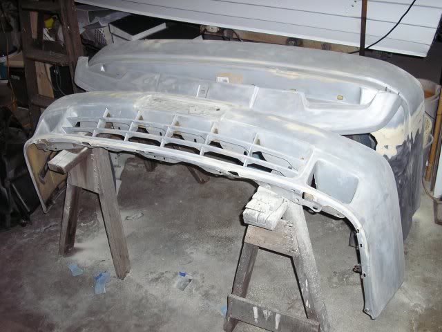

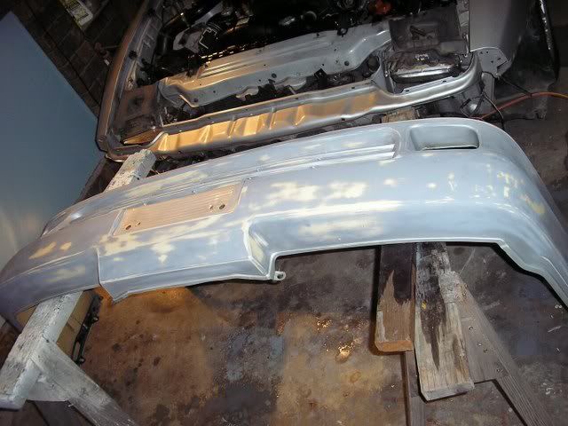

I am totally hating paint prep. Perhaps I'm just soft, but sanding that front bumper cover really sucked.

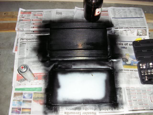

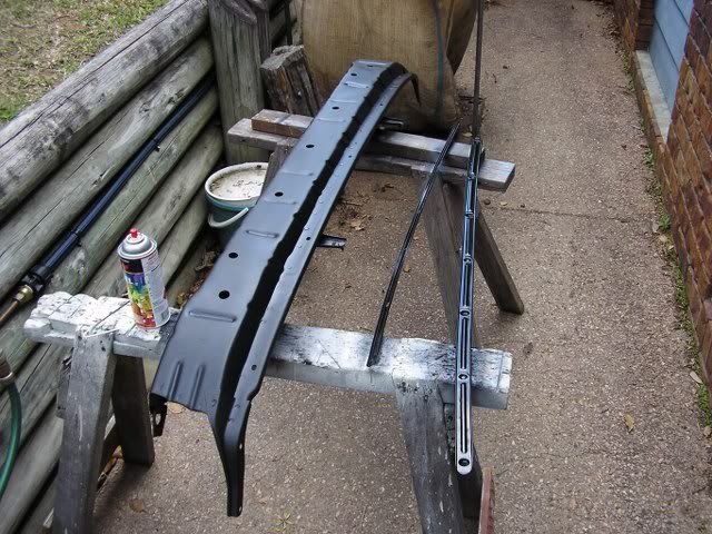

I hit some other parts with a fresh coat of paint while they were off the car. This is mainly for corrosion protection.

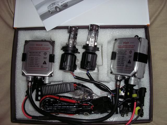

I ordered a set of 4300 Hi/Lo HID's, and they arrived early this morning. I don't have housings or any of the other crap needed to fit them yet - so will hold off on those for the time being.

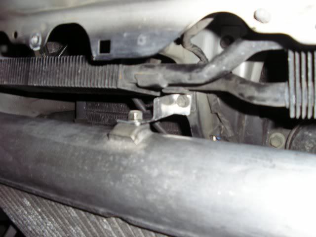

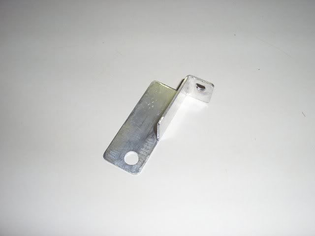

It started with noticing the intercooler had only been mounted at the base. The upper attachment point hadn't been used at all.
Ten minutes with a hacksaw and some scrap Al angle sectiongot that sorted. :)

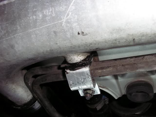

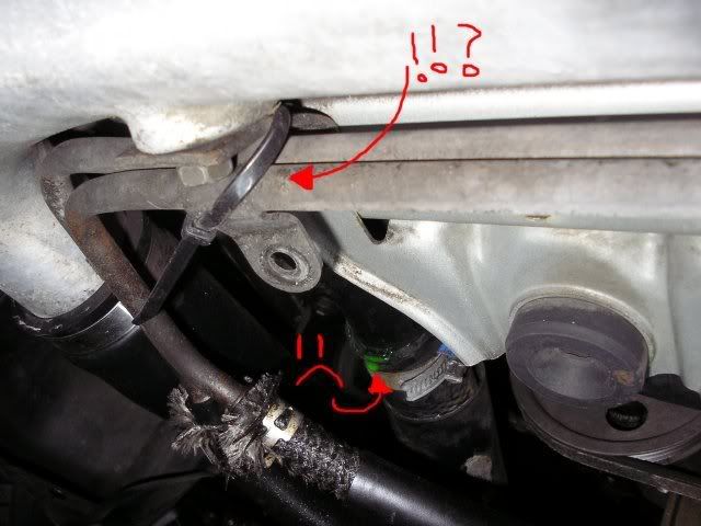

Then it happened. On Noes!! :( A cable tie. Yes, the only thing stopping these lines from dropping onto the road was a SINGLE CABLE TIE. Oh yeah and my power radiator pipe is leaking at the connector - yay.
This is probably the ugliest thing I have ever fabricated, but whatever. It's very secure and hidden from view in any case.
Coolant loss was tiny, and the connecter was really loose - so I have tightened it for the time being. I will keep a close eye on it.

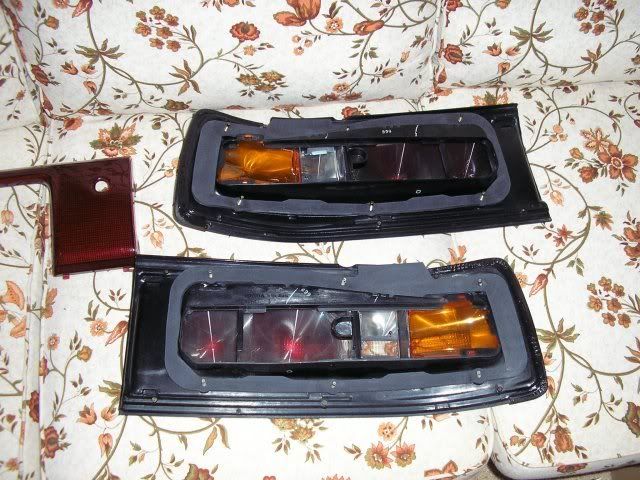

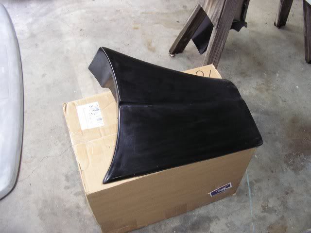

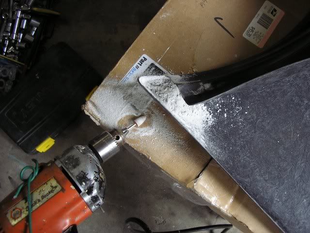

I got some Bomex rear pod copies from Shine Auto Project and they are simply awesome. Shine was terrific to deal with (international postage etc.), and the fitment and quality is spot on. I will let the pictures do the talking :)

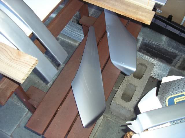

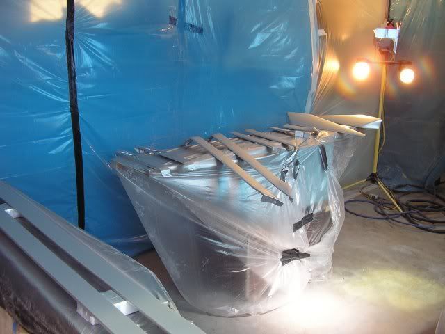

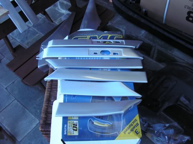

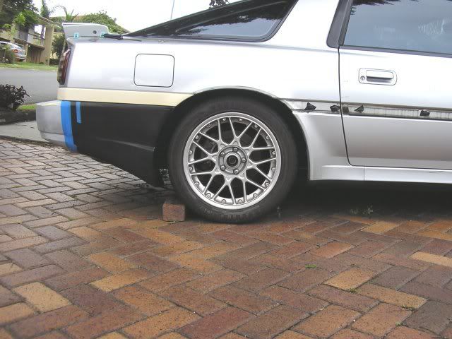

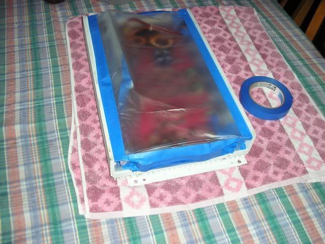

Another piece toward a finished puzzle today. Sprayed colour and clear, and they came out ok....ish. Actually I'm fairly relieved. The whole process was rather stressful as I had nobody to show me and have never painted before.
Some orange peel and contaminates... but passable.
I will be doing the bumpers tomorrow. I didn't want to do them first in case I screwed up!
