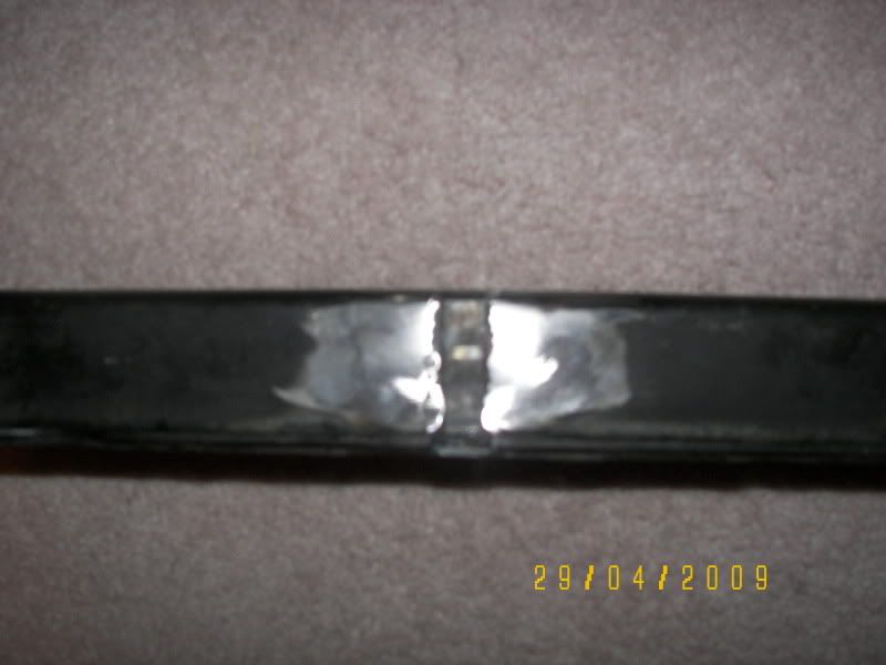

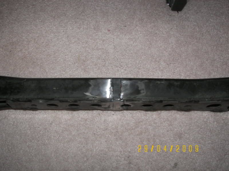

yeah hopefully it does not. it's welded on there pretty good though.

He suggested you cut those at a 45 deg angle, then weld for a reason :nono:

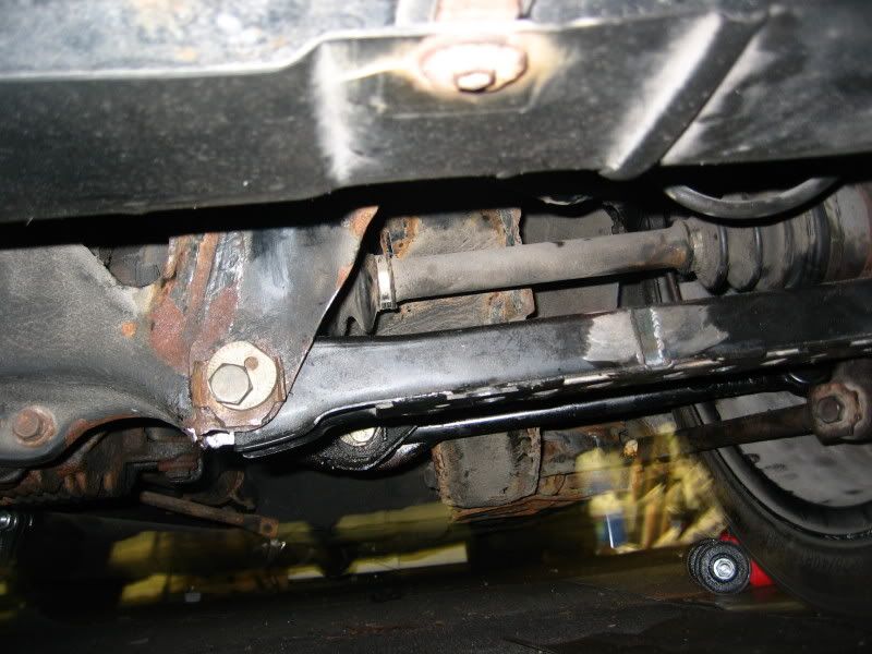

Well if anything I could get some support braces welded on either side for more support. I was not able to do the 45 angle like IJ suggested because like I said b4 I could not take apart the arms which I currently have on the car since I need it to drive to work plus they do have a rust on them.

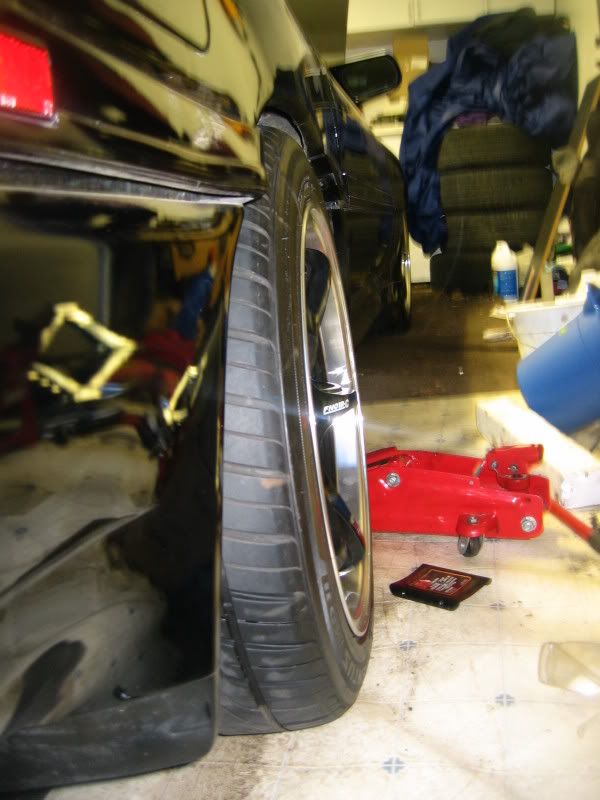

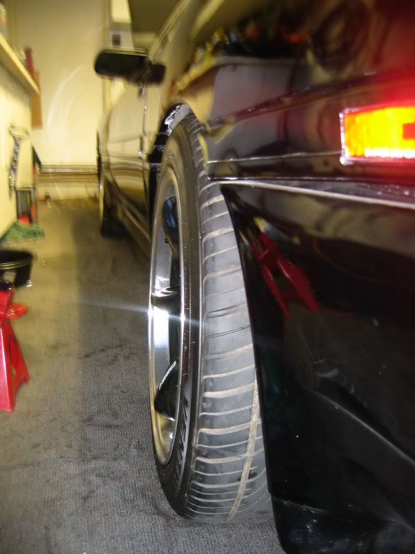

just thought i will update you guys. the reason i took so long was because both my toe arm as well as my camber arm in the rear were both seized so i had to cut them off and replace them. just finished that today and noticed a problem. after replacing the camber arms my wheel seems to be sitting at an angle. since i increased the length of the arms by 14mm. the pictures explain my point. let me know if you guys have any suggestions and if i did anything wrong.

any suggestions? i went to the alignment shop today just to see where i sit my negative camber got worse after extending them :3d_frown: so the guy at the shop suggested i should have shortened them instead of extending which was my original plan. so tomorrow i will be going back to the machine shop to get them to shorten it by 28mm.

"any suggestions? i went to the alignment shop today just to see where i sit my negative camber got worse after extending them so the guy at the shop suggested i should have shortened them instead of extending which was my original plan. so tomorrow i will be going back to the machine shop to get them to shorten it by 28mm"
Yes. Adding more length to traktionarm will only push out lower part of tire more... and result in more negative camber. logiqally (spelling )

A hint here is if you shorten the arms it pulls the back of the tire in making the wheels toe out at the front.
