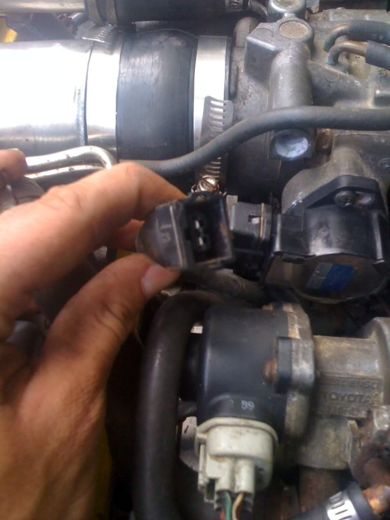

Hey i recently rebuilt my 7m. I through it back in the car but there are a couple clips that i dnt know where they plug into. So any input would be nice. There are two of these brown clips. They are not injector clips, my injectors are all plugged in, and they dont even fit in the injector clips. That green clip is also a mystery, but im more looking for the two brown ones. Thanks
NTRA08
TWINKY
Jun 10, 2008
530
Conroe, Texas
green is really the one you should be looking more towards. Green is a knock sensor plug ( most likely the front ) and the two brown ones look like the plugs that go to your two VSV's under the intake manifold

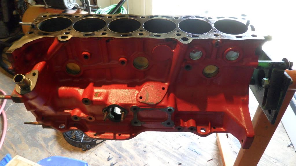

right under the intake on cylinders 2 or 3.
And this
Its the little hole above the freeze plug
Cylinder 5 below the freeze plug is the one in the back
