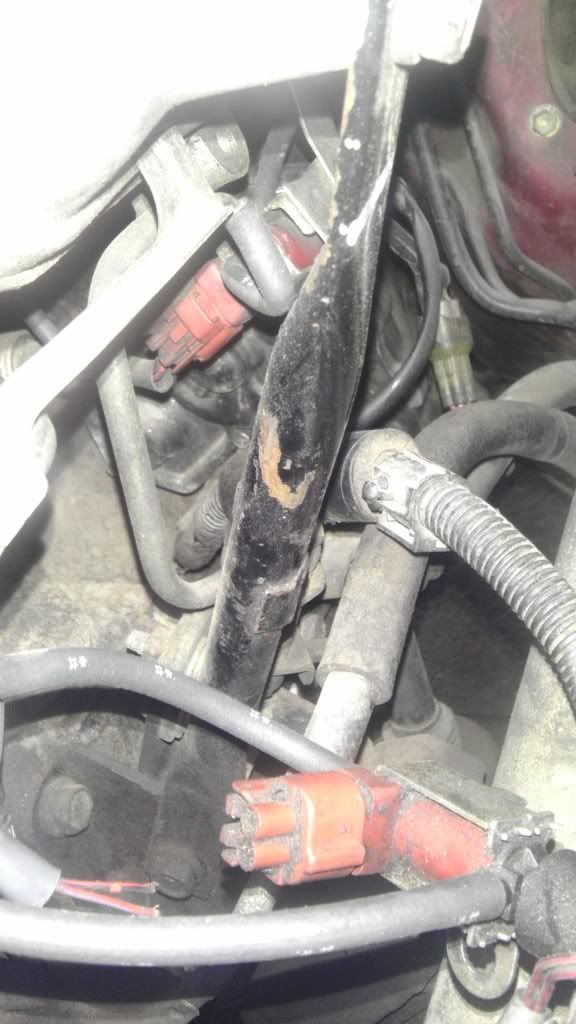

So looking over the car i the wires have seem to come out of the VSV closest to the Alternator. how badly could this F with the car ?
I'm sure it's not the jerking problem
But my car also has a pretty bad problem with lack of power at the moment and its running super rich also.

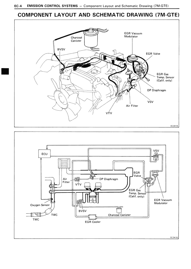

Here is what i'm talking about
But here in the TSRM it shows only one..
http://www.cygnusx1.net/Supra/Library/TSRM/MK3/manual.aspx?S=EC&P=4
