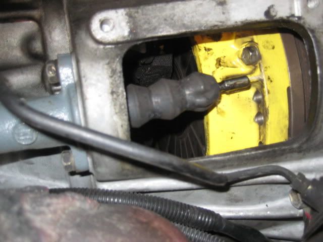

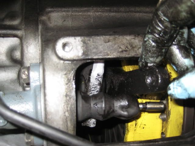

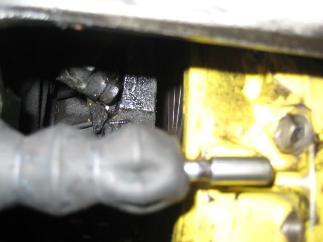

ill have a pic tomorrow i hope. i took off that plate already, on the other page i said the push rod is attached to nothing. if its supposed to be attached to the clutch fork should the clutch fork be somewhat stationary. what i saw was hanging down very loosely. the transmission hasnt had any work done since 2000 according to the original owner and ive had it since 2008
solardrgn
Feb 6, 2008
77
socal
heres the pics. the slave's push rod is attached to nothing. and that piece of metal is completely f'ed... so what exaxtly broke??
