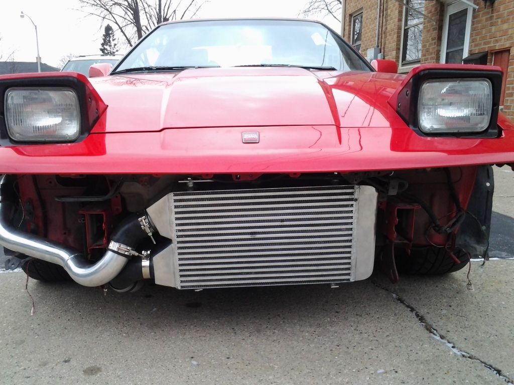

Well for the coolant overflow bottle, I have it on the opposite side of where it used to be at. I'm going to move it because I don't really trust that spot since the corner of the intercooler is just touching it. Don't want to be driving along and hitting a bumping causing a hole in the coolant overflow bottle. As for the oil cooler, I moved it to the right side of the right crash bar. There is two holes there and I created a new bracket for it. If you look at the picture, it is the two holes on the left side of the picture under the passenger headlights.Grandavi;1923043 said:I just had the DM intercooler installed (not back from shop yet), just curious.. where did you end up putting the coolant overflow bottle and the oil cooler?
Looking at mine with the bumper on, I think I may get an A-Duct (If that's the right name) that would allow airflow through the middle of the bumper. The top half of the intercooler isn't really exposed to any airflow that I can see.
50... Alzheimer's has kicked in YoGrandavi;1923792 said:yeah.. the Turbo A Duct.. couldn't remember what it was called![]()
