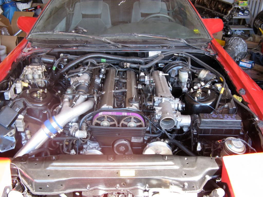

So I got everything hooked up today, turned the starter with the EFI fuse out to get the oil circulating, and then fired it up. It idled nicely at about 1000 rpm, then the oil pressure light came on and I shut it down right away. Pretty much the deal is; if I turn it over for about 15 second, then start it, the engine is fine for about five seconds and then the oil pressure light comes on and it dies out or gets turned off by me. If I don't turn it over it starts and sounds like a mess with the oil pressure light on, then dies. Any advice? Any tips would be greatly appreciated!
