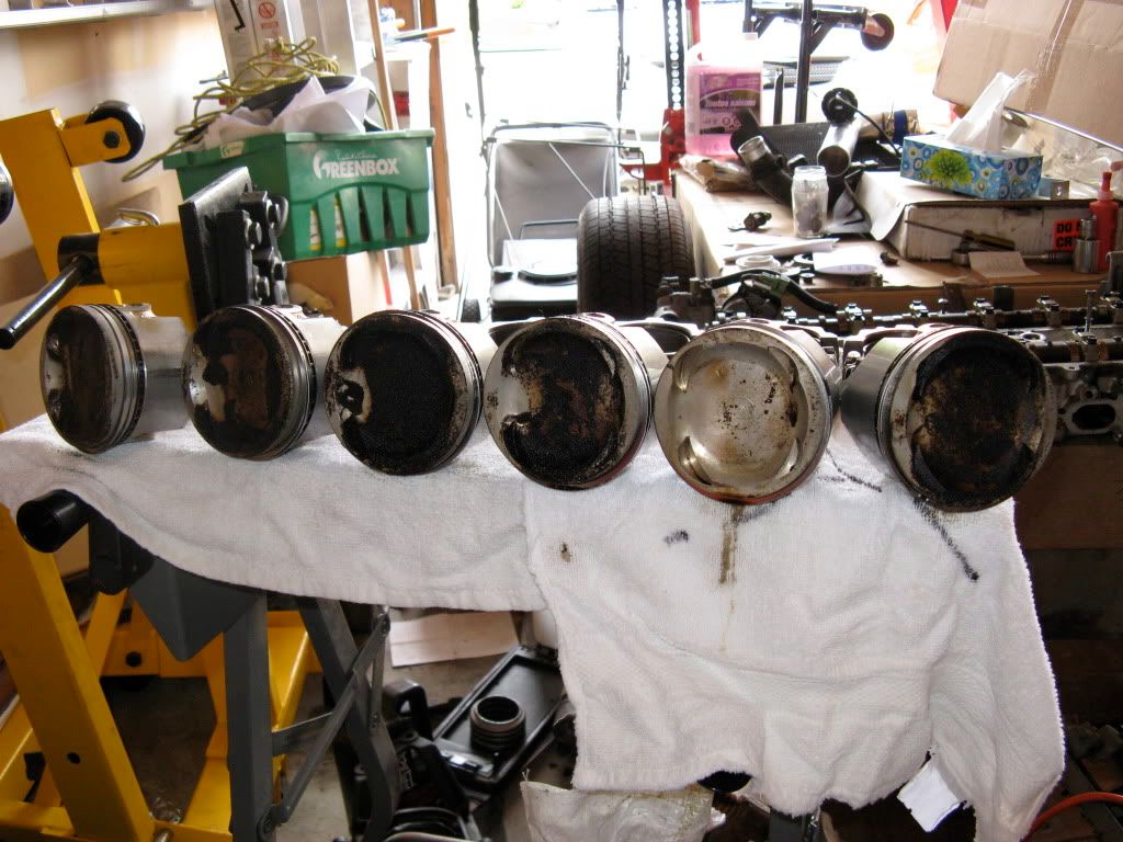

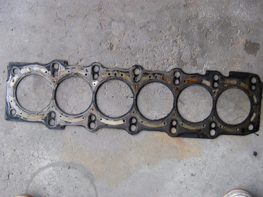

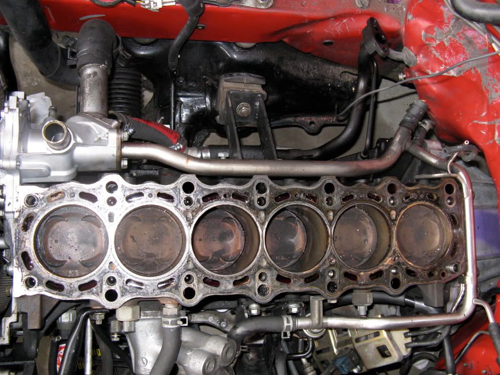

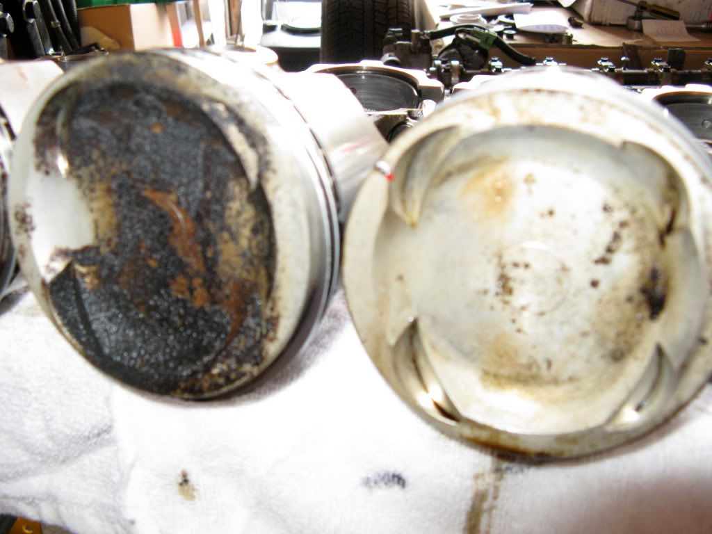

Pistons out of the 7mgte, first cylinder on the right, sixth on the left. What's the deal with the 2nd?
One carbon built, one clean...both untouched/uncleaned after removal.

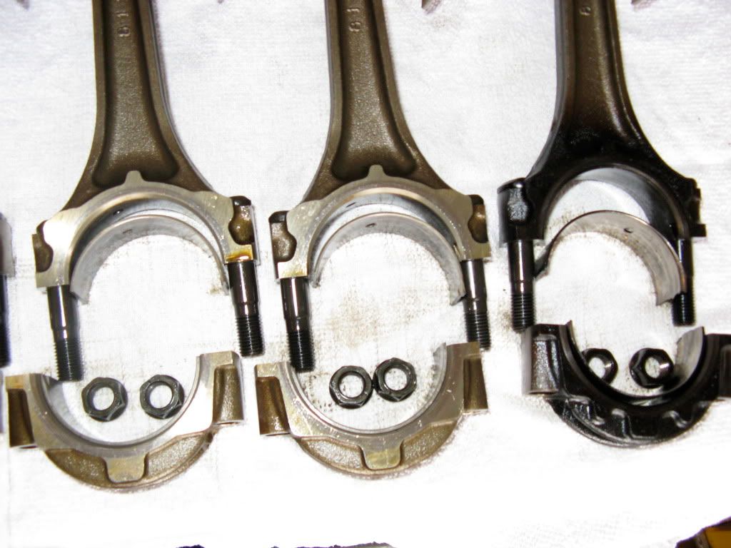

Rods 1 to 3 (left to right) All are undamaged, and up for sale.
Rods 4 to 6 (left to right) No damage is apparent, but the darker color shows which rod was knocking. (engine removed AS SOON as knocking was apparent)

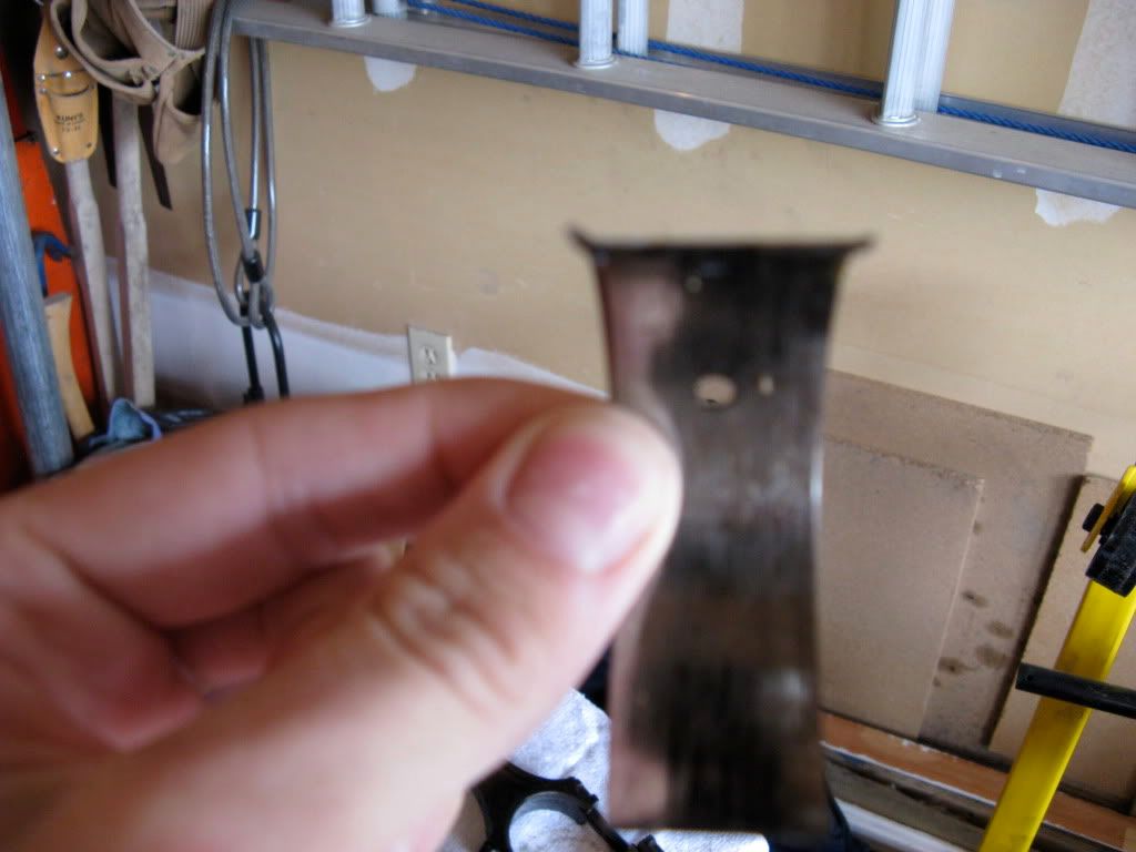

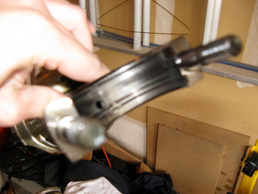

Bearing from 6th rod.
6th rod had no wear marks different from any of the other rods.

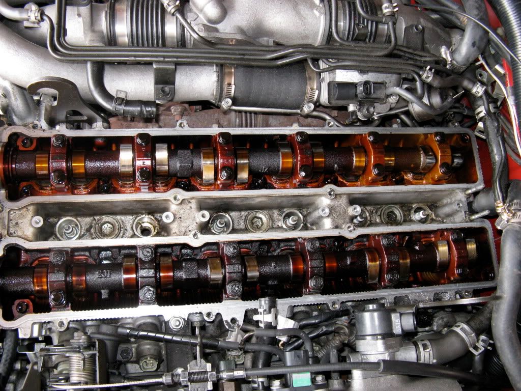

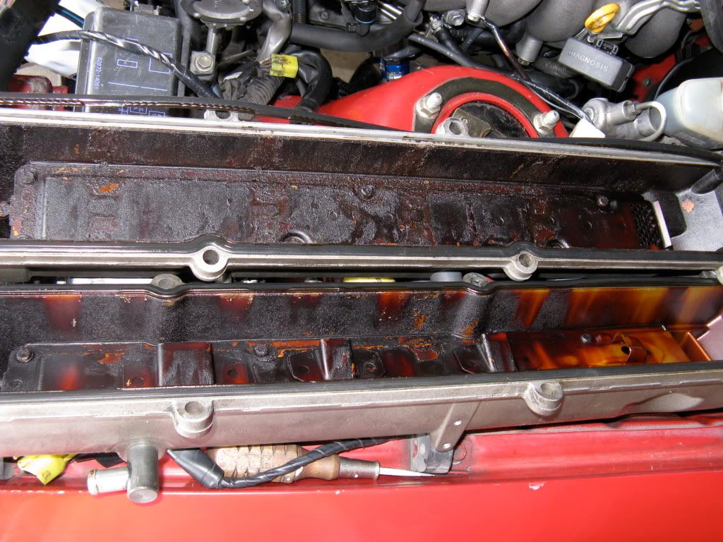

Valve covers off. What's the deal with the coloring/carbon build up?
Again, what is the deal with the coloring? Is that abnormal? It looked very different from the 7M (the only other upper valve train I have seen).

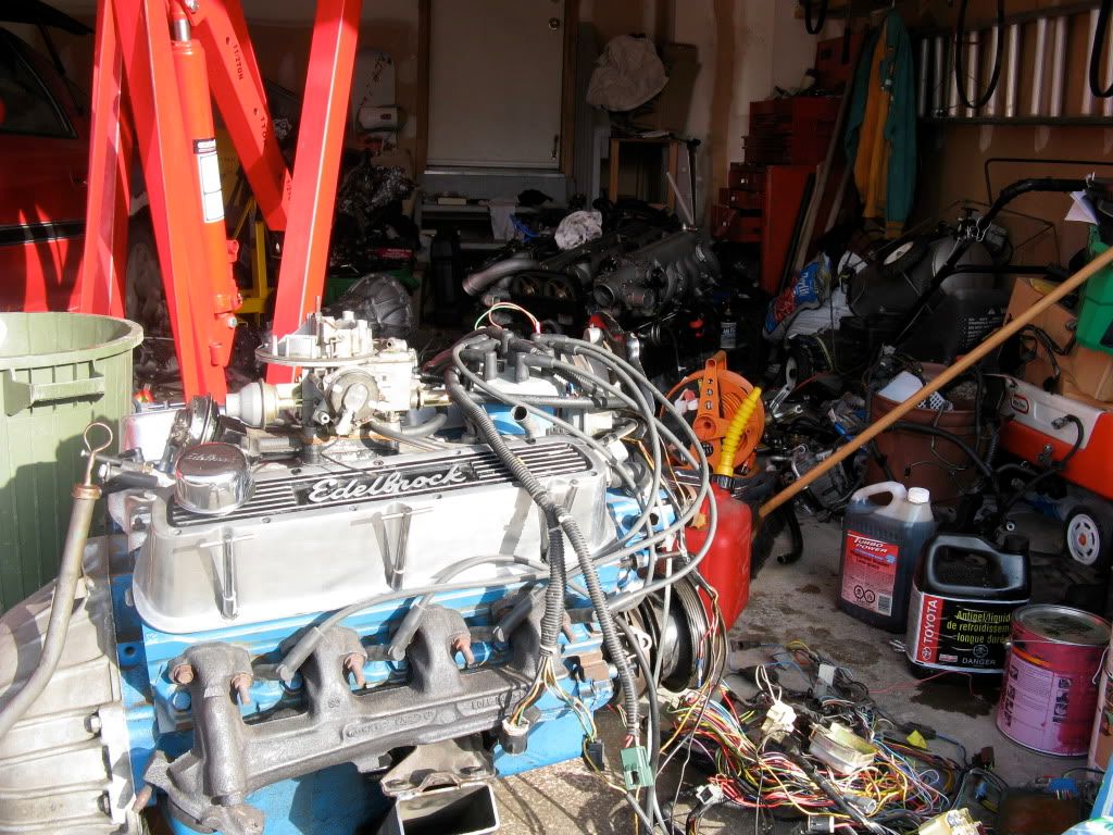

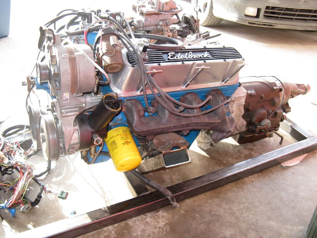

GF's 1972 Ford Maverick.

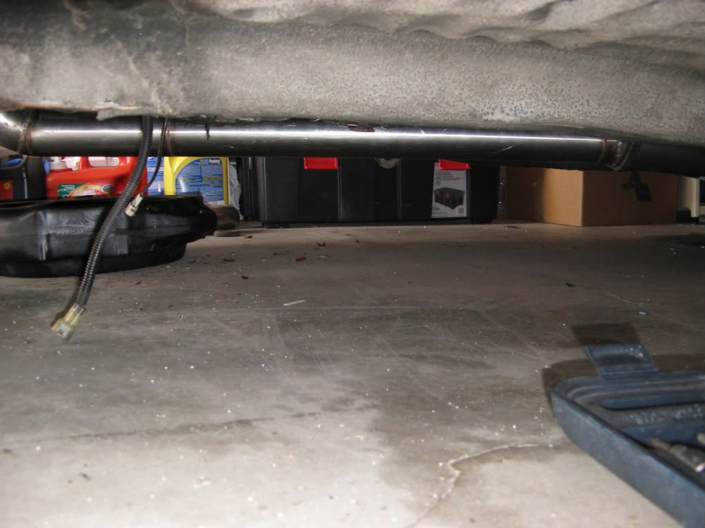

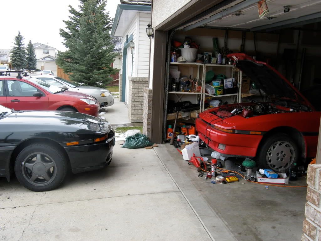

I tried my hand at some custom downpipe fabrication, better pics when it's off again. 3" stainless, nice and straight with no crush bends! Heads straight into a brand new HKS super dragger.
AJK
Oct 28, 2007
62
Calgary
Picked up a new supra! Something to drive while I fix the '88. New one is a '91 twin turbo-R, no rust, no dents, no scrapes, 120k kms!
Still has stock engine undercover and stock brake ducts.
Back to the '88. 2JZ head removed, and that's about all the progress with that at the moment.

IJ.;1440281 said:
A bit late but the "clean" piston usually indicates a BHG leaking coolant into that cylinder, this in turn steam cleans the carbon from the piston.
Better late than never! I keep learning, any new info is much appreciated.

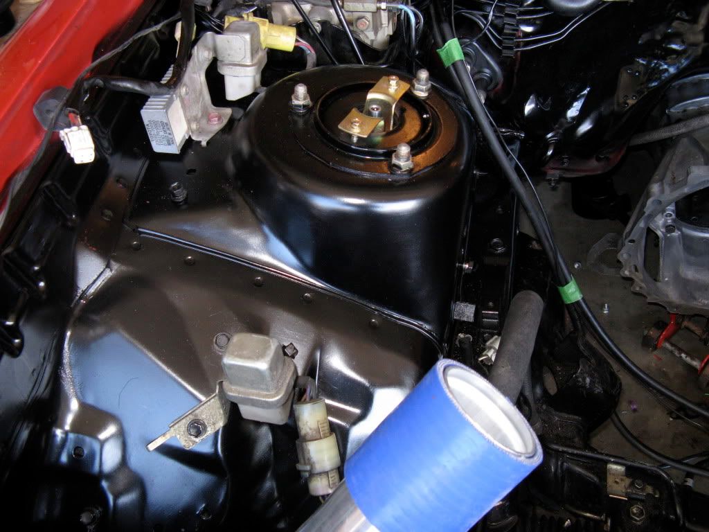

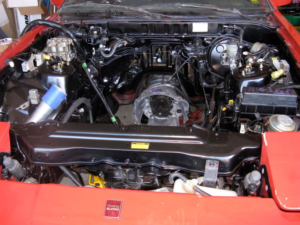

Pictures of engine bay repaint, it'll match the outside once the outside is professionally repainted black.
New engine for gf's maverick!
