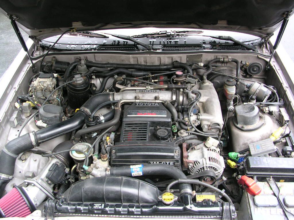

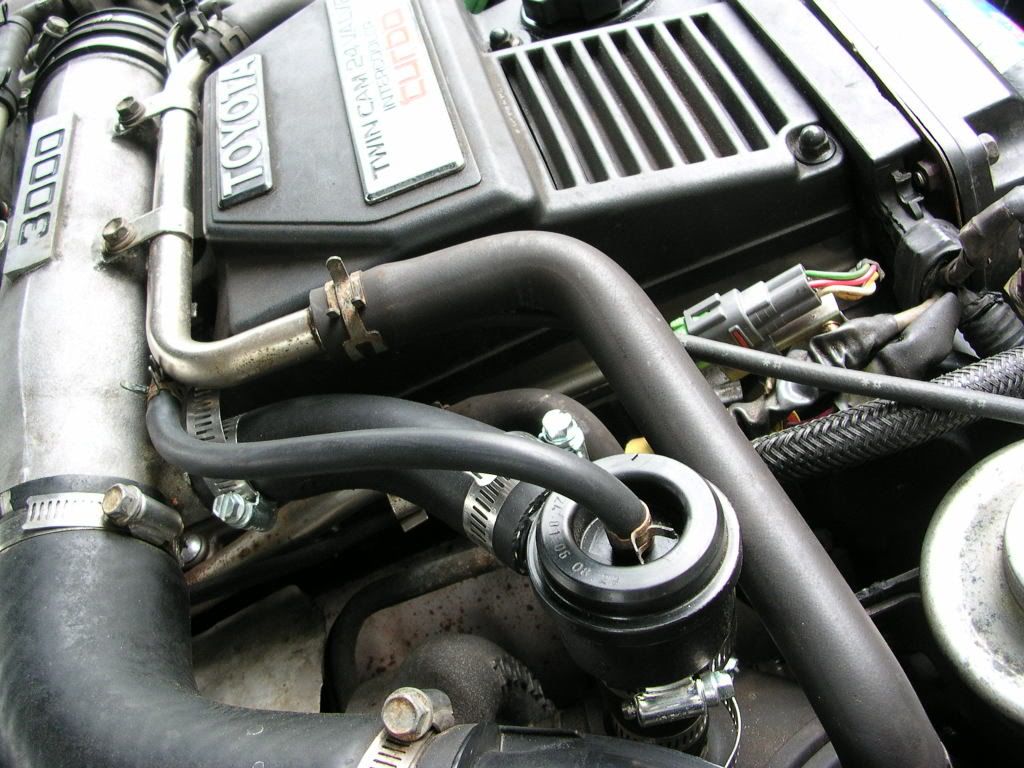

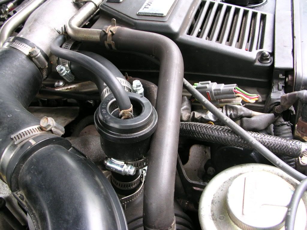

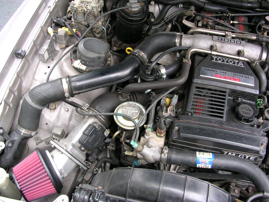

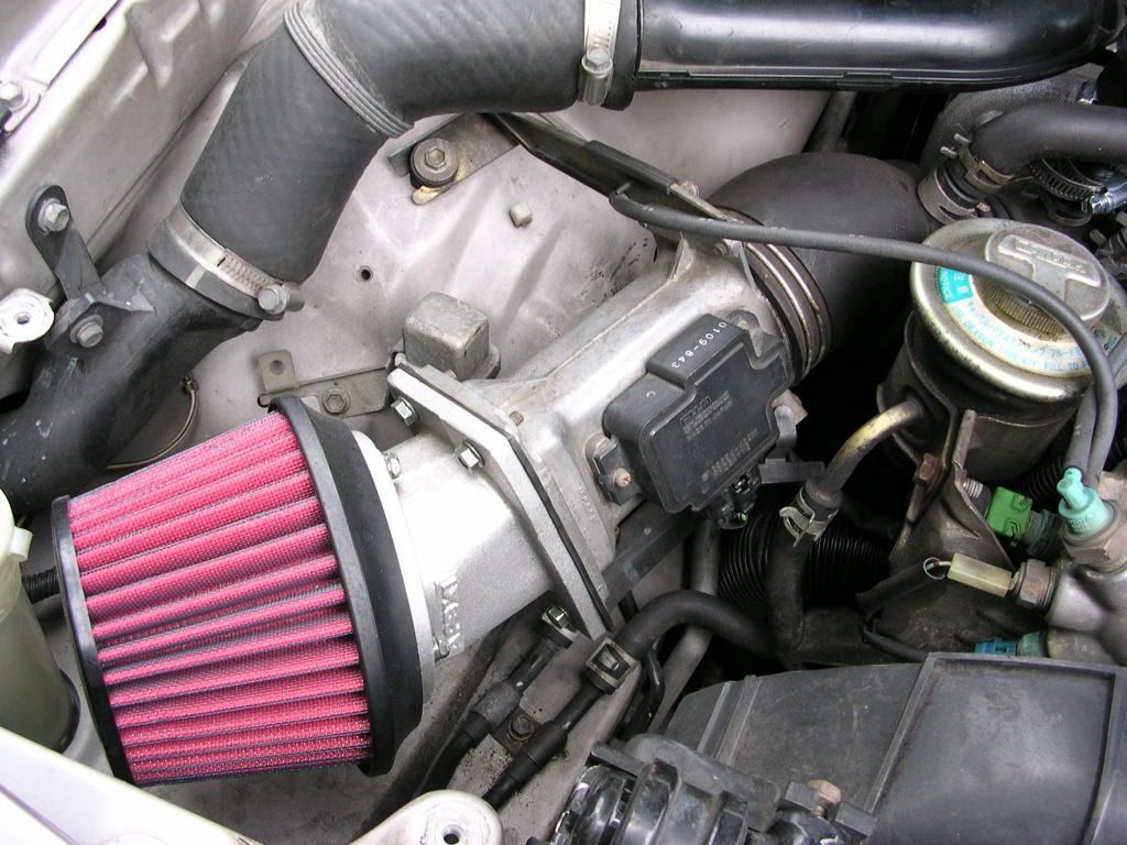

Hmm, I thought I had posted some engine bay shots... Guess not!
It's nothing too special right now (especially compared to many of the rides on this site), pretty much cleaned up and stock looking (except the Bosch BOV and A'PEXi intake I added).
Oh well, here are a few shots of the bay:

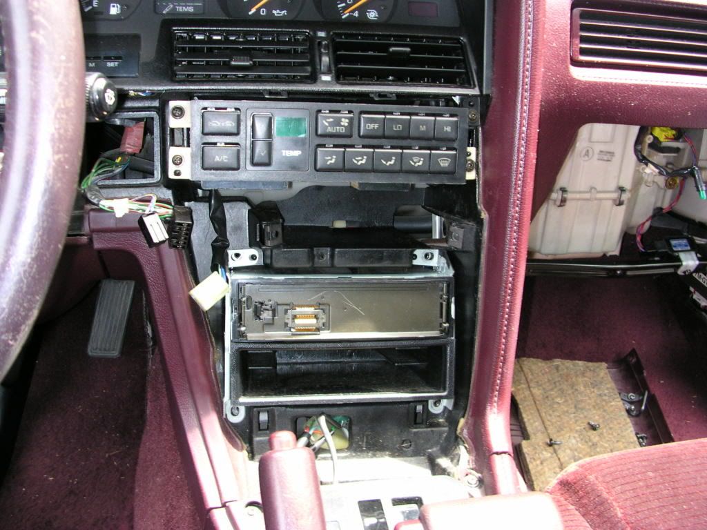

I've been a busy dude for the past two days ;-)
Sorry for the crappy pics, they were kinda an after thought as I was already working on it and well into it... I'll take shots of the final results later cuz right now I have it prewired just to have something to listen to (still sounds phenominal!) When I clean it up, tuck the wires and build my little rack I'll post the final results (may be a little while though, just depends on when I get my next burst of energy). I also put in the newer model climate control box cuz it's funky fresh and stuff (it looks a lot better than the original one IMHO)...

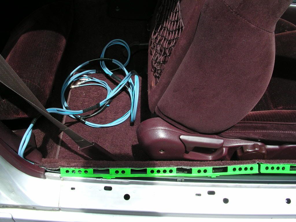

RCAs channeled through door sill conduit:

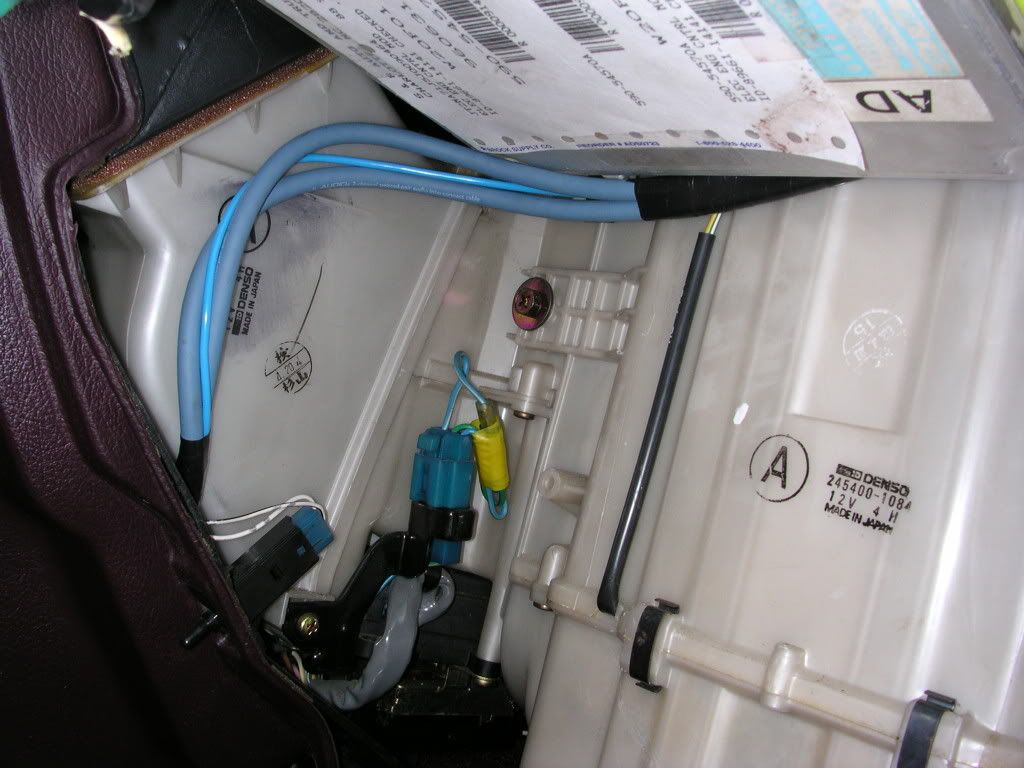

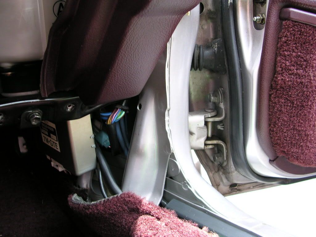

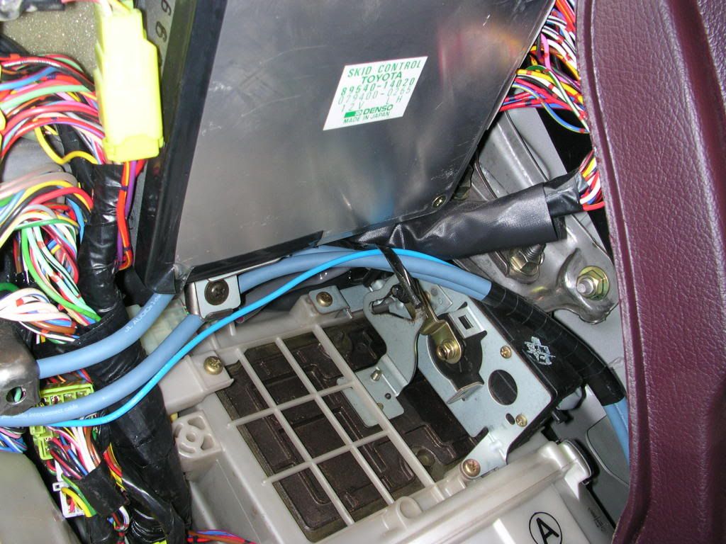

RCAs run through top/rear of glove box:

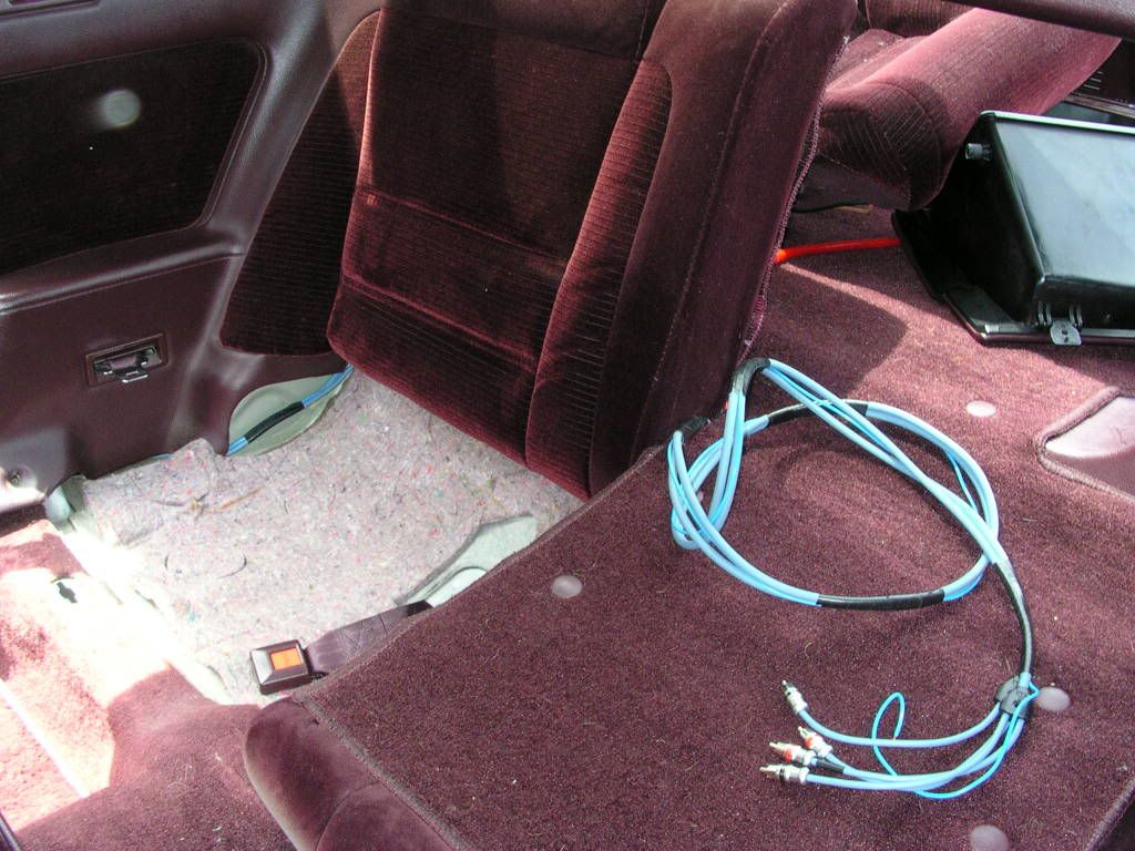

RCAs channeled through rear paneling and exiting through center of rear seat backing:

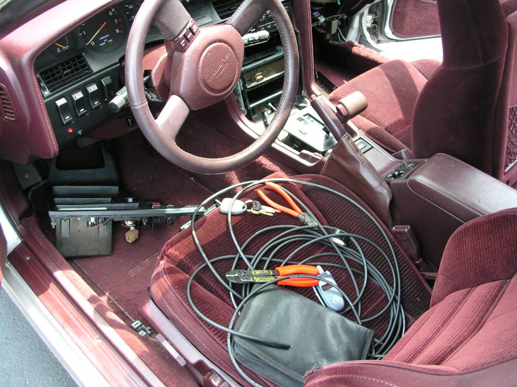

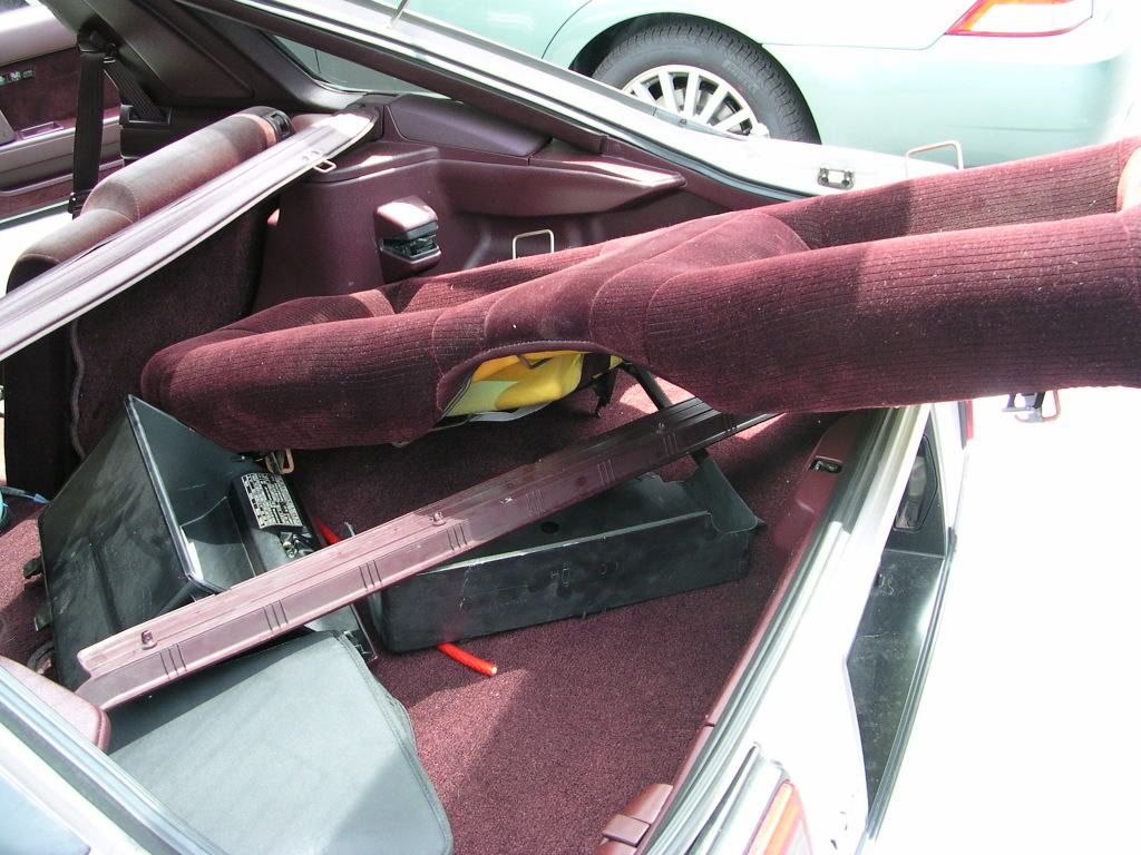

Speaker wires and crap on seat / junk in the trunk:
Newer model Climate Control (thanks Ideal):

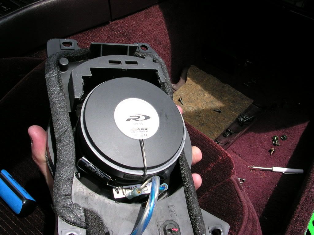

Alpine SPR-17C magnet in newer speaker pods chopped up/ground out to fit:

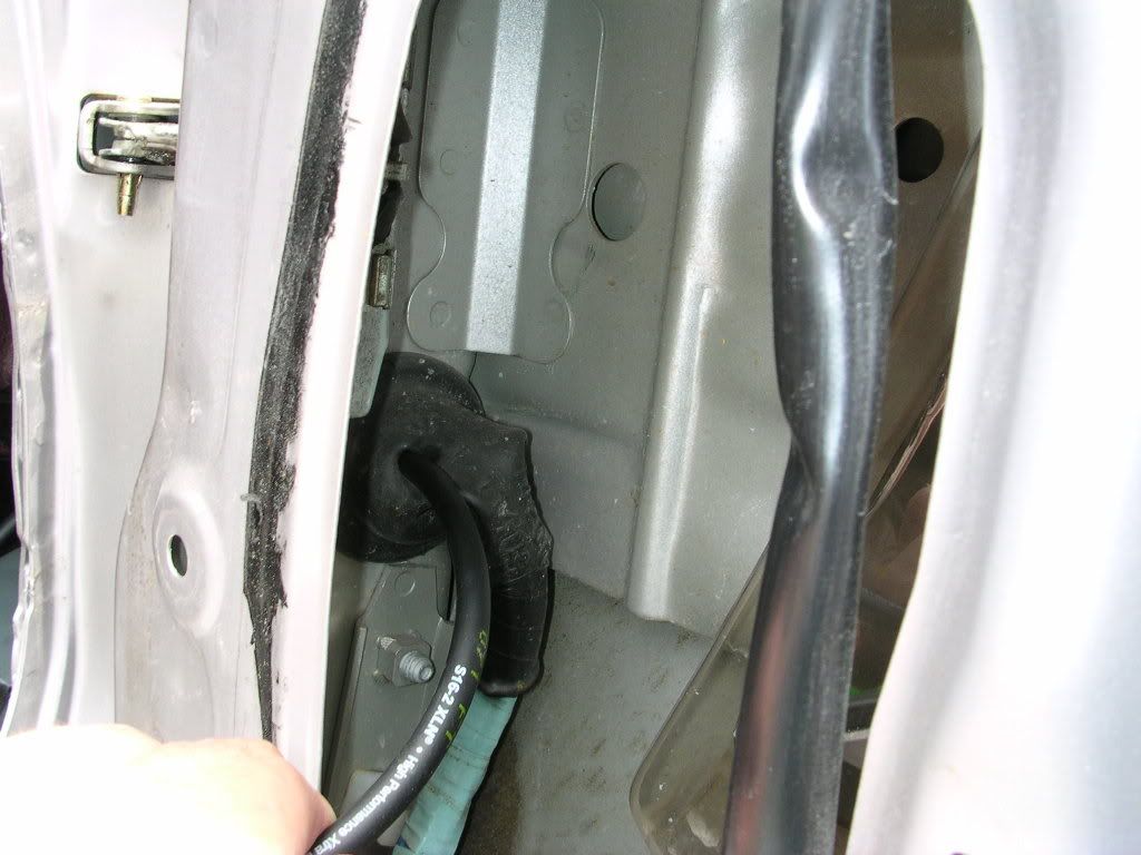

Speaker wire run inside door:

Yup, those are the fronts (I'm only running fronts and one sub in this setup). They're Alpine SPR-17Cs, which are the Type R 6.5" speakers in the newer speaker pods I got off eBay.
They're running (along with the Alpine SWR-1242D 12" subwoofer) off an oldschool Soundstream Rubicon 604 in 3 channel mode... It sounds VERY good, but today the amp was having a bit of a problem with heat and went into thermal protection a few times (it was pretty hot out and it was in still air)... I'll be building a small amp rack eventually to mount the amp upright and possibly run a fan across the heat sync (I'm going to try to avoid that by any means though).
