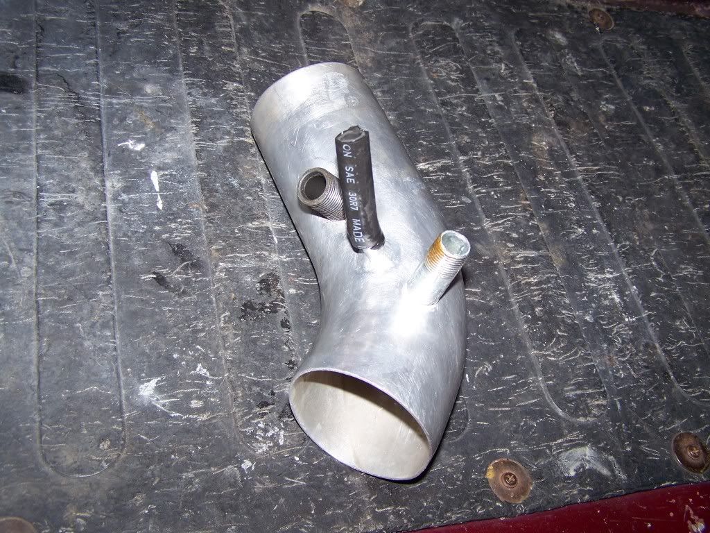

Well , I had some time today to work on the Supra , My main objective was to take care of the stuttering , + the vacume leaks & IC piping leaks ,
I replaced the old accordian pipe with a costom fabricated pipe I made today
I fixed all my issues & now the Supra runs great , Now i have to get that 3 inch exaust I have been working on getting on there ....
Heres a pic of the pipe I made
Yes , It may be Ghetto , But It fixed my issue 1OO%
