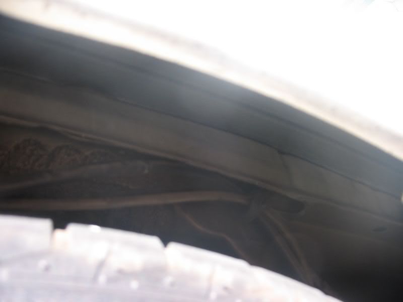

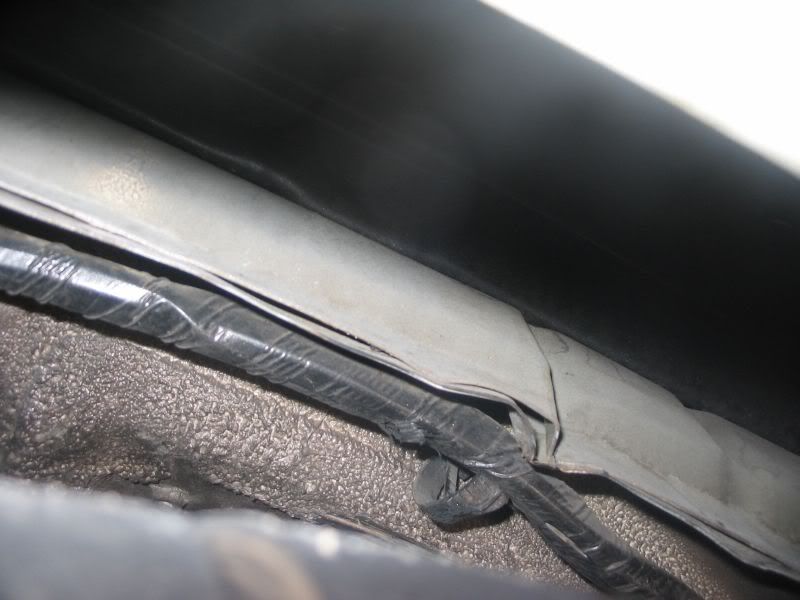

I need to hammer out a little arch underneath the fender walls.. Above where the wheel wells were. Then I wont scrape. I like how low I am but Moe's ride (firmness) is PERFECTO!

Heh not the wheel wells... Its where the fender meets with the chassis(i believe, Ive felt it. Never seen it) and its hitting my tires when I am cornering hard. Im gonna see if I can't hammer them flat. Just to delay the inevitable... Swaybars!

don't hammer them out yourself.. get them rolled somewhere... pros use a tool that attatches to where the rim mounts and then makes a perfect circle around it rolling the inner lip inwards... In addition to that professionals use a heat gun to warm up the paint so it doesnt crack when it's being rolled, so you dont get rust under there!
Please correct me if i'm wrong, but i'm pretty sure that's how it goes!
supra90turbo
shaeff is FTMFW!
6,152
MA, 01440
Get them rolled, Definitely.
You *can* do it yourself with a baseball bat and a heat gun, but someone with a fender roller is better suited for the job. It's far less ghetto that way.

Not sure why you would want to go so low as to have your suspension travel gone, and your tires rubbing on the upper apron/strut rails...
Has your car been hit before? That shot of the upper rail appears to show some crush.
