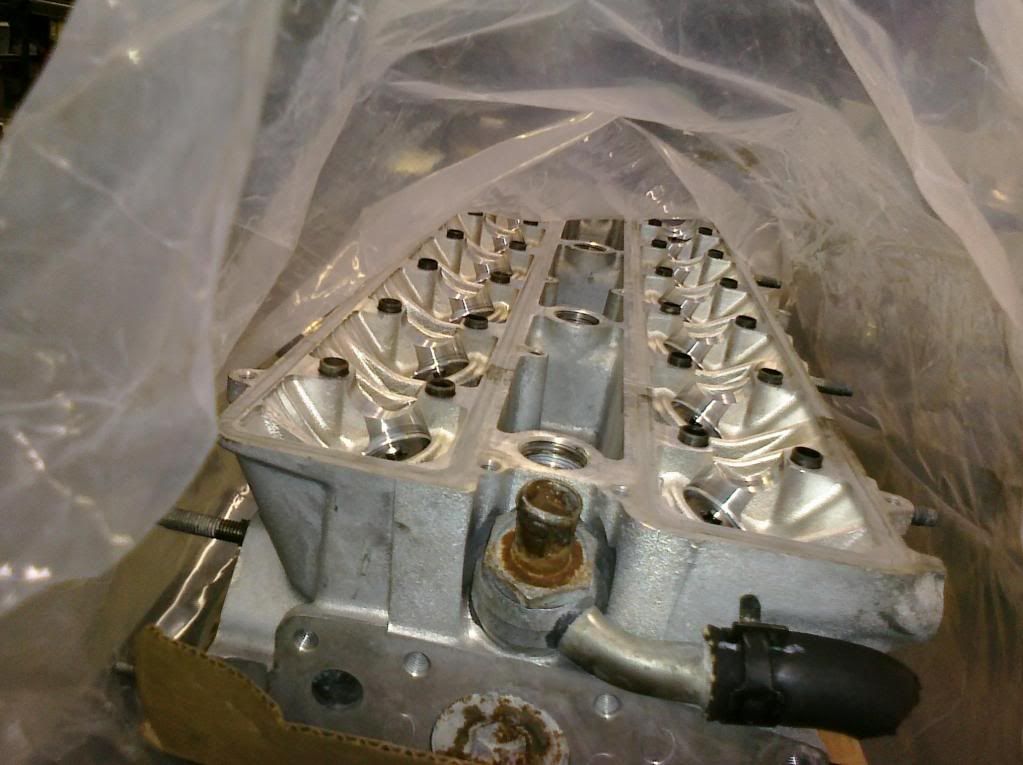

yo might you have a extra one of these laying around?
its that tube coming off the back of the head, really the top half that looks rusted in the picture, that one is bent up

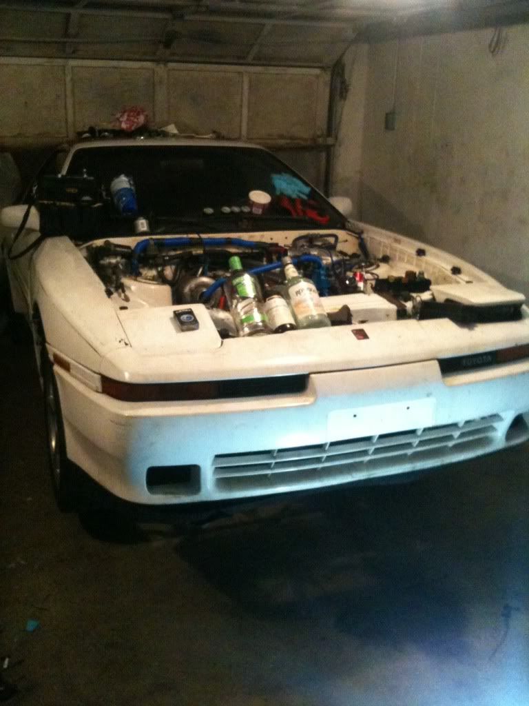

Another sunday night of work
got iscv mounted with new rubber gromet+gasket
iscv/throttle coolant lines situated
got valve shims situated
routed some vac lines
Tested hood fitment with my afpr+bracket....I need to change it as it does indeed hit the hood.
Pics

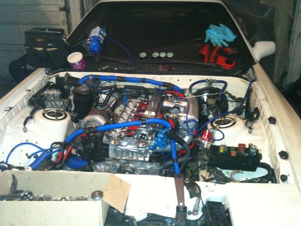

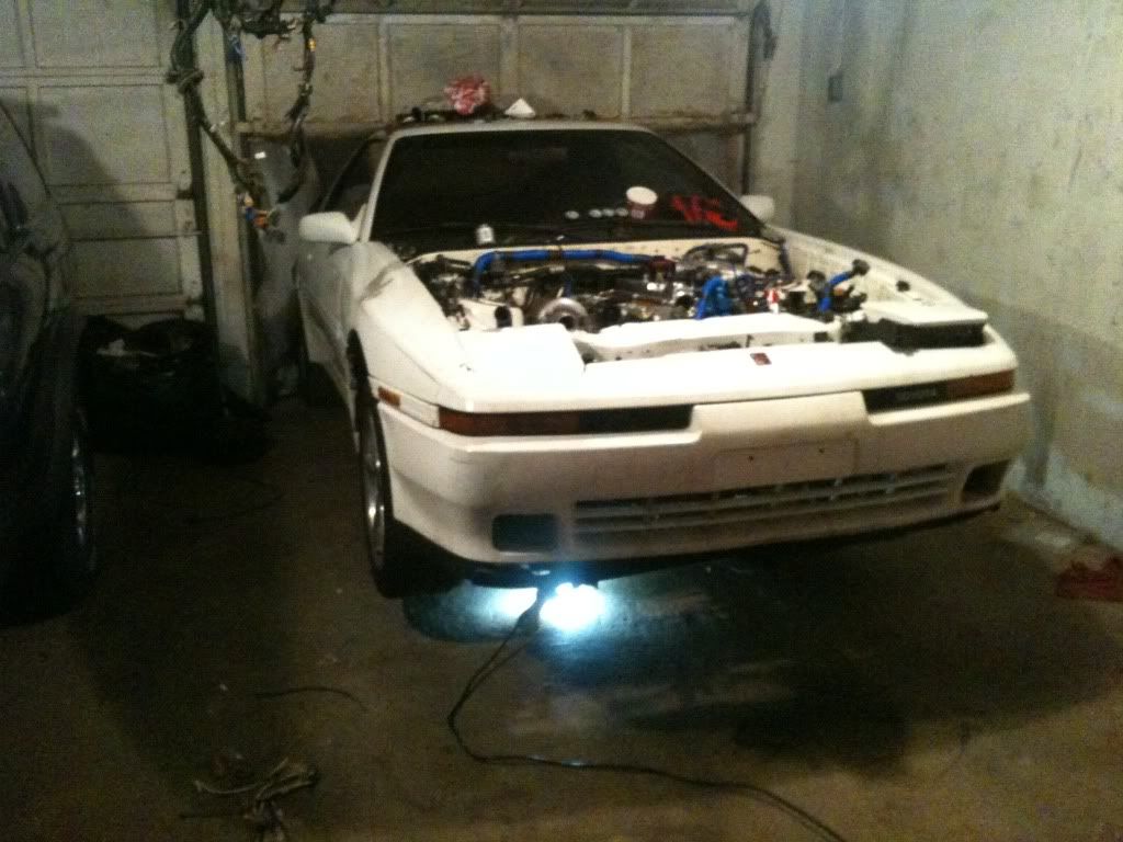

Well I've been wrenching all weekend so far and got a bunch done!
Reinstalled the bottom inspection plate between the block and trans (previous owner didn't do it......finished installing the egr system....installed charcoal canister.....remounted my afpr as it didn't clear the hood.....picked up my safc2.....figured out some wireing....got the stock oil pressure sender installed....
Also...had a friend run speakers from the entertainment center down to the garage and picked up my propane heater as it's damn cold out!
did some drinking:)
took the oil pan off my spare motor and indeed it is rod knocked:-(.
the crank looked workable but still not awesome....the rod cap nuts were finger loose so thank god it didn't pop a rod threw the block
