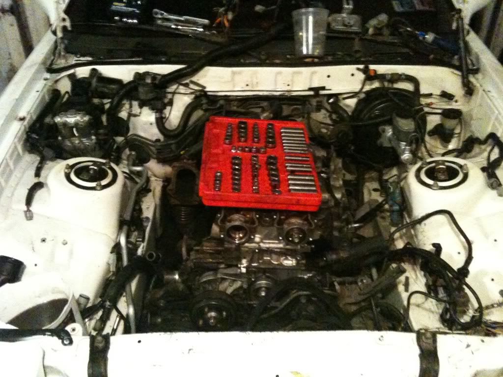

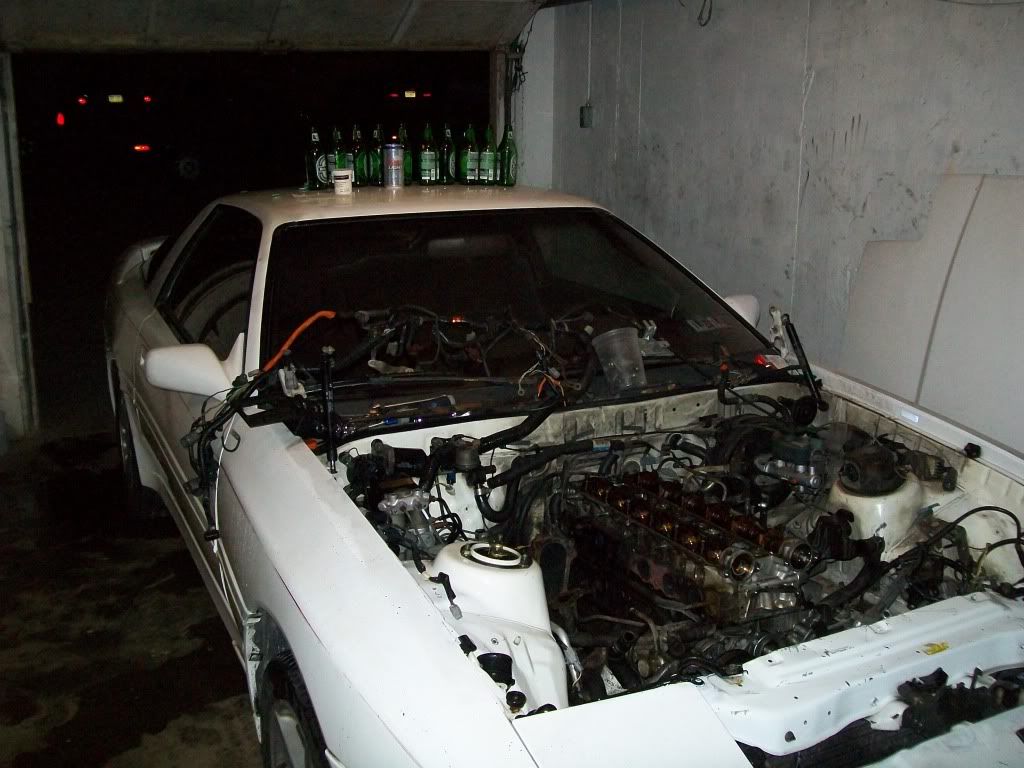

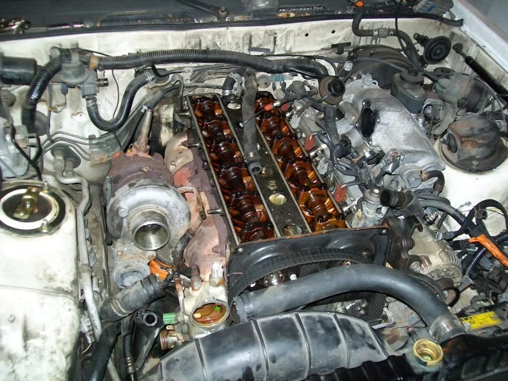

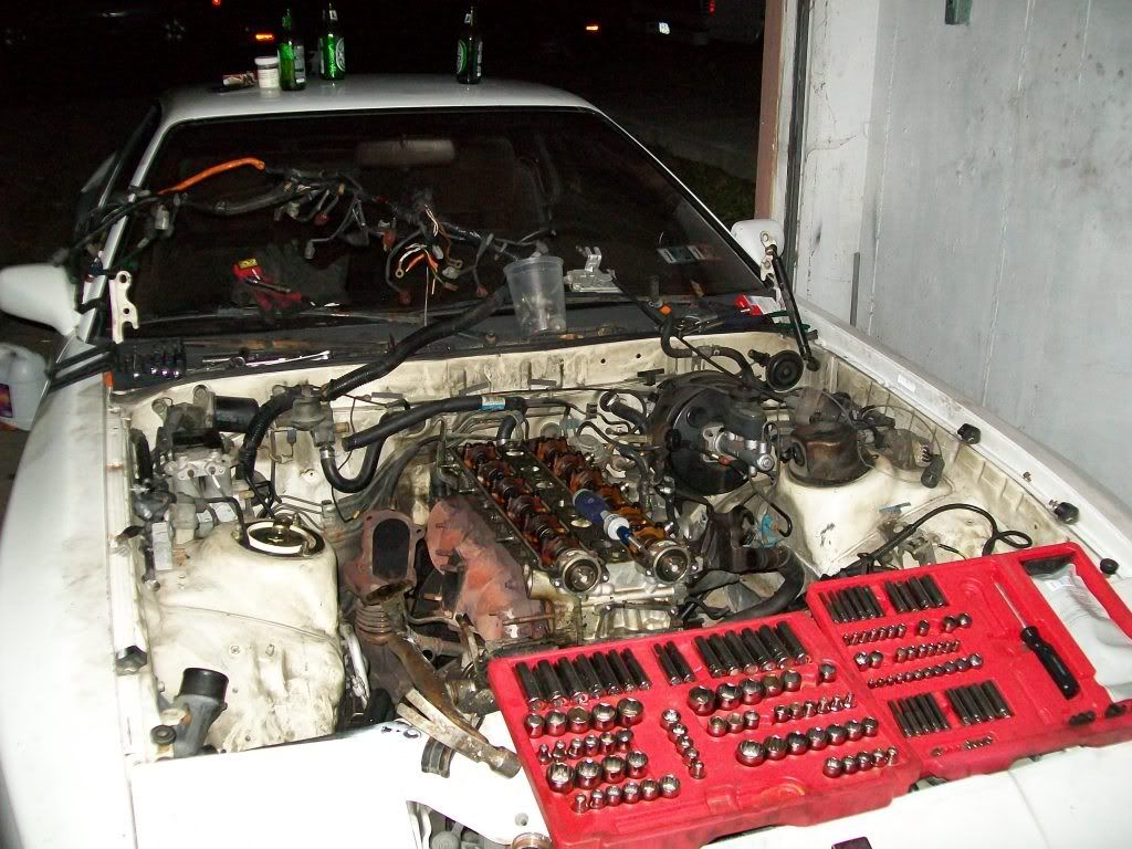

so last weekend i really started to dig in....figured id do a head gasket and have one of my heads rebuilt to start....
this weekend i did a bit more...as im not really on a deadline and its hot as fuck outside im in no hurry to work....

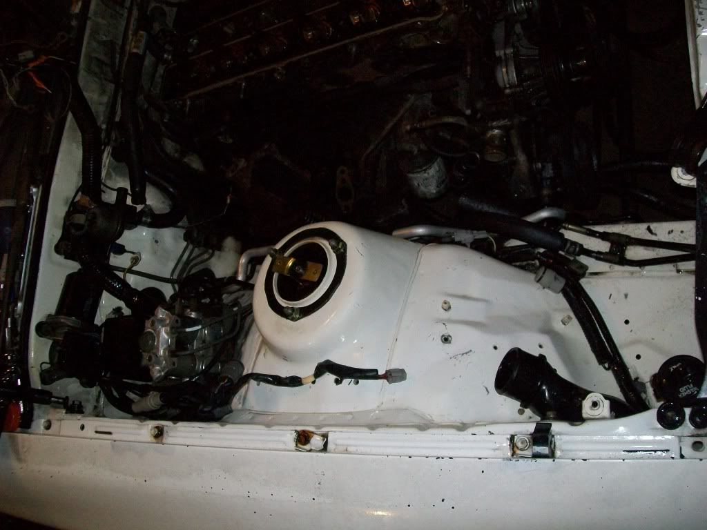

tonight "being monday morning" i got a little bored and figured id go and play in the garage a bit...
nothing major...just wanted to see how well purple power would work on an engine bay as bad as this car.

on that note...the turbo that came on this car is in fucking great shape...no bent fins, very little shaft play, spins like a sob without oil! I was really surprised! shame as i plan on getting rid of it lol

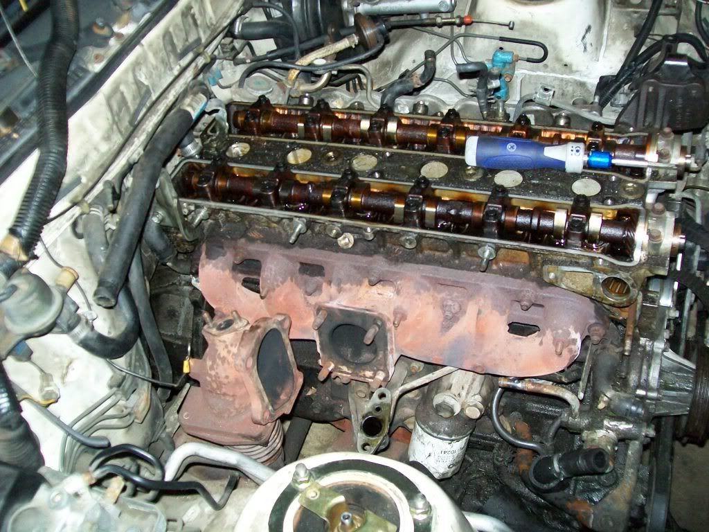

So while I was removing the exhaust mani I noticed that the studs didn't strip any threads in the head!! Seems like this head is still pretty hard on the exhaust side which makes me happy! Still plan on timecerting the exhaust studs though for safe measure.

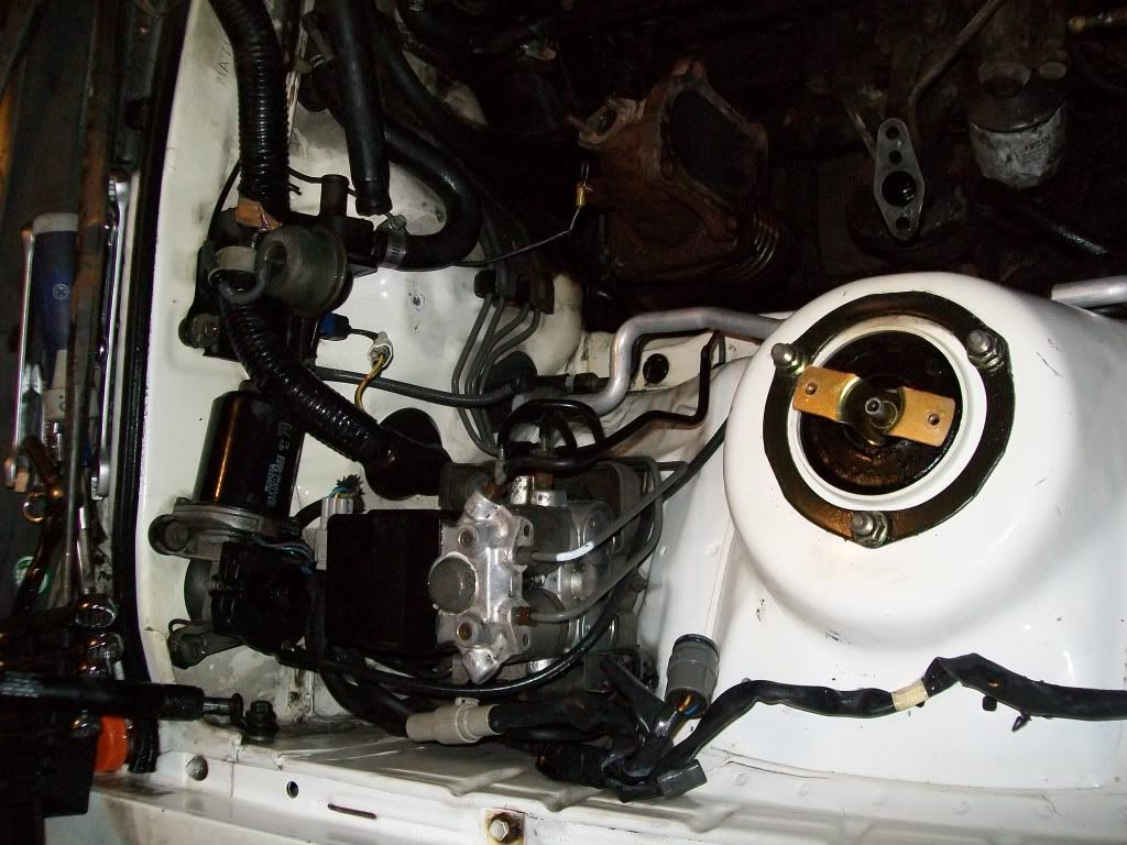

progress
how i cleaned the engine bay
chemical burns
odd shit i noticed...
freeze plug with something in it
and two plugs in place of where freeze plugs usually go....top two small plugs under the hard pipe....wtf
scrubbing the garage floor after some spilled coolant and oil
CyFi6
Aliens.
Oct 11, 2007
2,972
Phoenix
www.google.com
The little thing on your core plug is for warranty purposes i believe, if you overheat the engine it will pop off and then they will know that the warranty is not valid anymore. They use them on heads too. Those big allen plugs are like that on all 7m's btw.
gaboonviper85
Jan 13, 2008
3,236
Northeast Philly
I have 3 7m motors non of which have allenhead plugs in them....they all have freeze plugs....strange ofcourse none of my motors are post 90...all are early 89 and below.
But thanks cyfi glad to know that thing isn't something worth thinking about!
