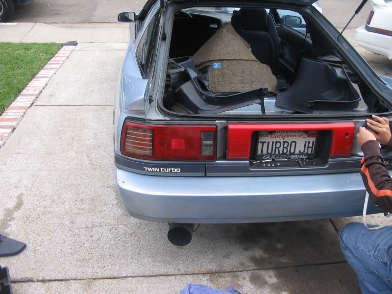

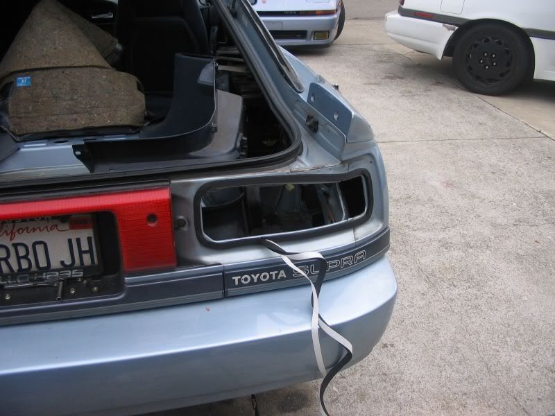

Tomrrow Bor Hor and I are making taillight seals out of wather stripping! Im getting a huge leak into my spare tire well when its a hard rain, and the back seats are getting damp.
Ill take em off and blowdry the tails, then put the new seals on

I made em out of some awesome weather stripping, It works just as well, Just had to make some holes, Boris showed me worked great

Put a little bead of silicone of the top edge of the seals you made, and then smear it in with your fingers, then put the lamp back in. Most of those home depot foam seals don't last long at all, and will just shrink or lose it's memory and leak again.
