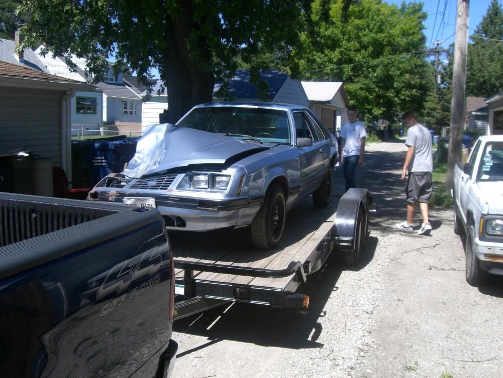

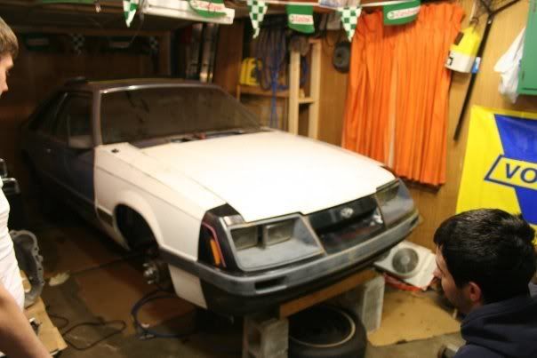

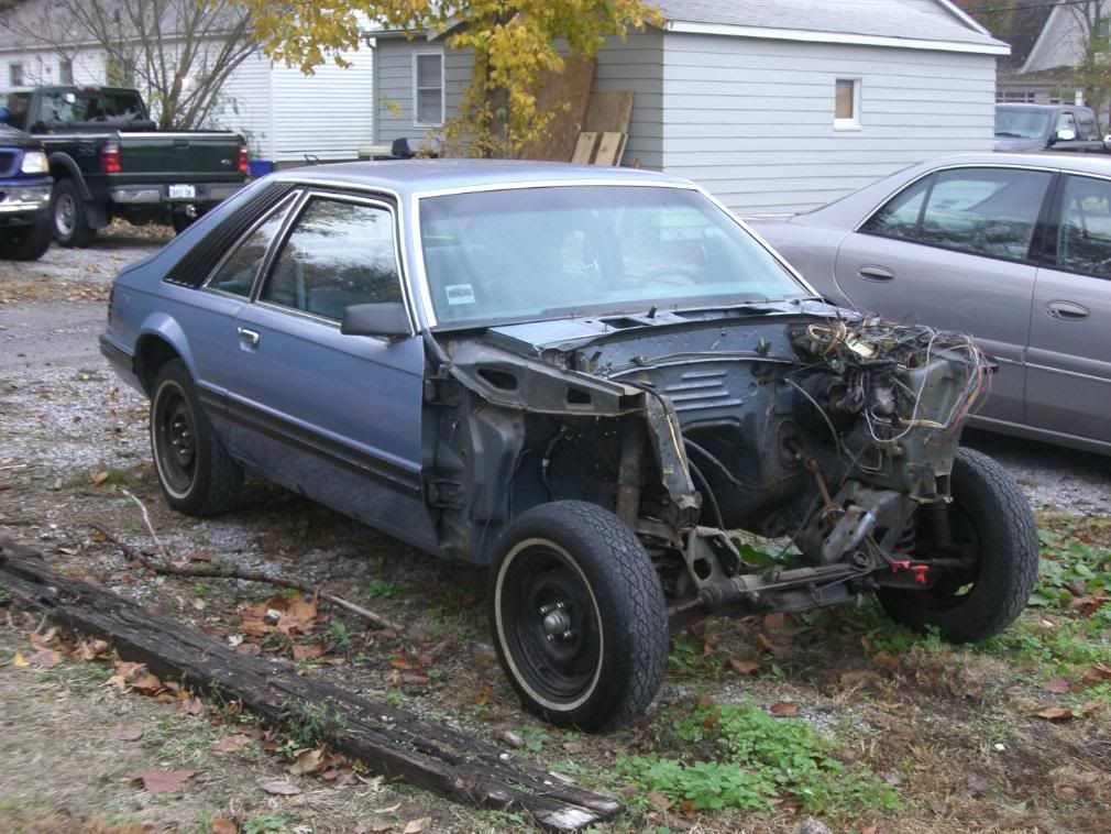

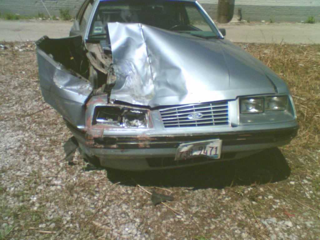

This was the first sight of her

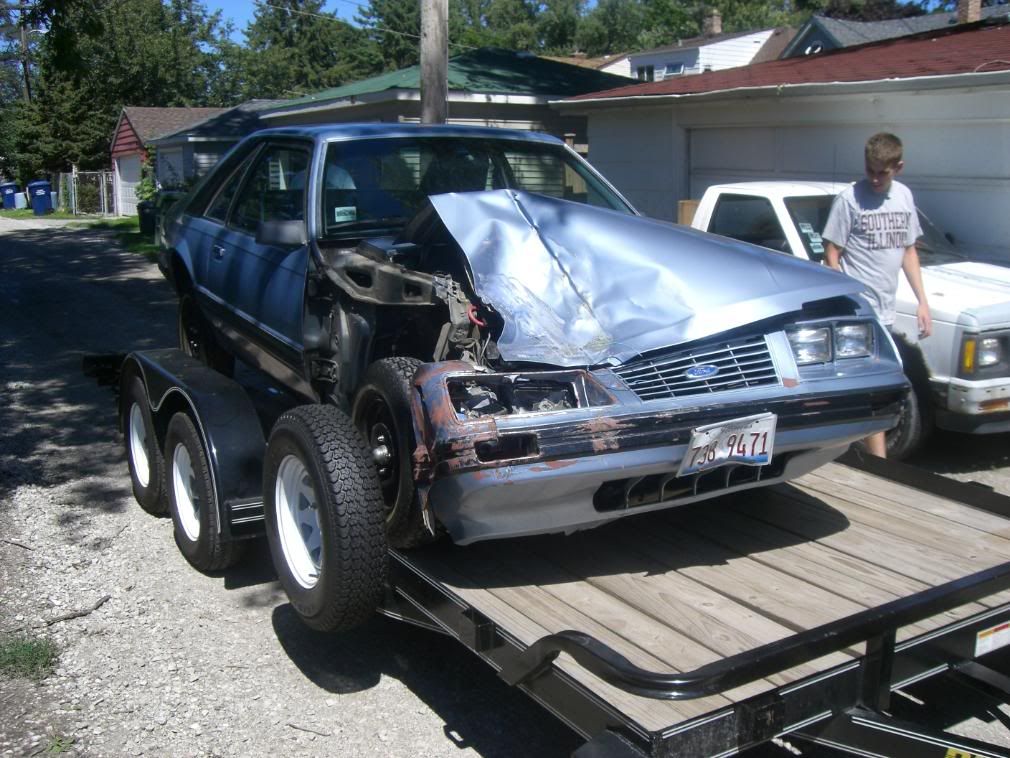

Then trip to chicago to pick it up, props to my buddie jim for trailor use.

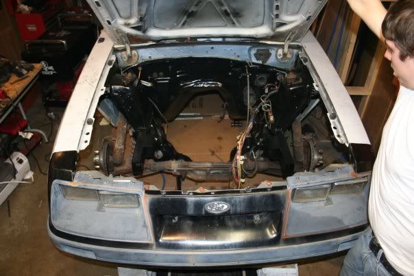

Got her home and stripped her down to the goods with saw-zaw and prybars

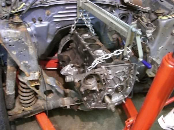

Had a old 7m shortblock laying around so i used that for mockup.

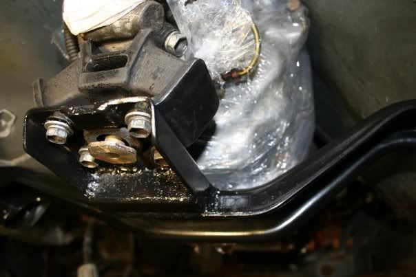

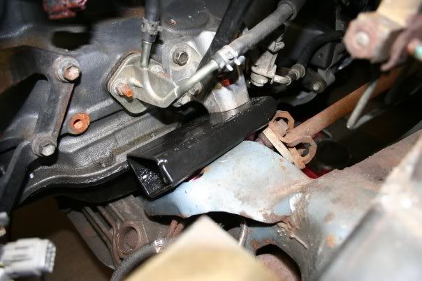

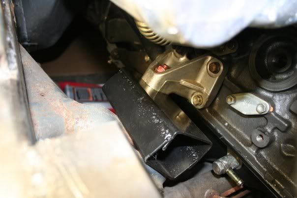

tight fit
driver-side mount.
passenger side mount
trans mount

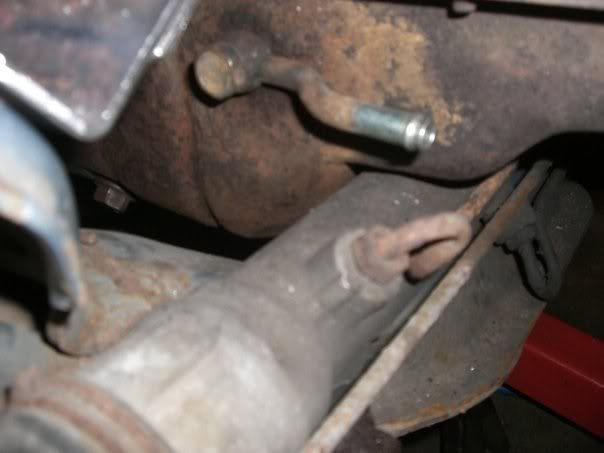

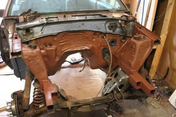

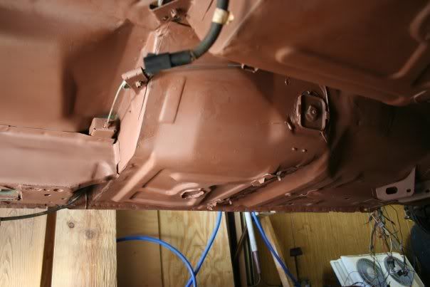

repaired front frame-rails and cleaned rust off and pained with rusty metal paint
aswell as with the floor

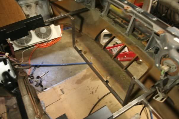

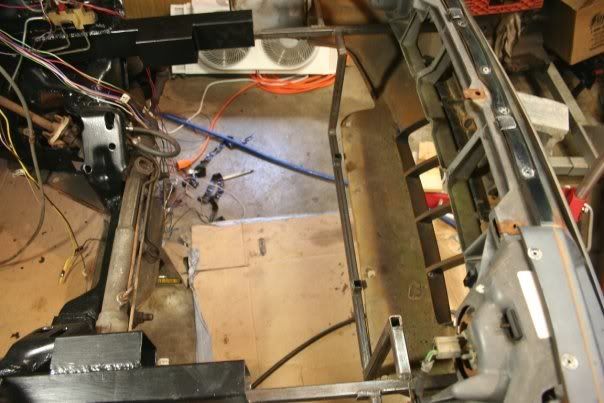

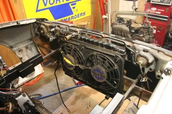

got body panels mounted up to start with bumper and radiator support.

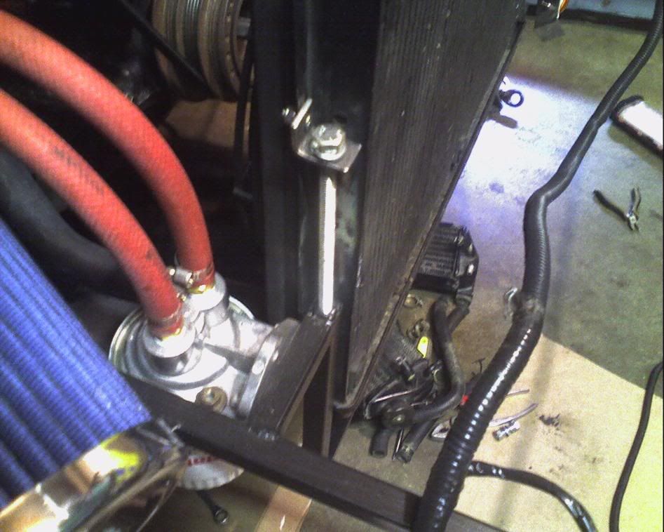

made everything as light as possible and only the basics. I made the radiator brackets mount to the side of the radiator so with radiator removed there is nothing on top.

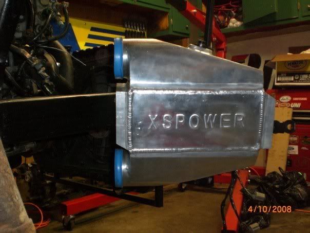

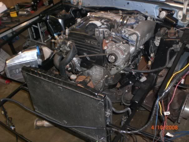

intercooler mounted inside front fender.

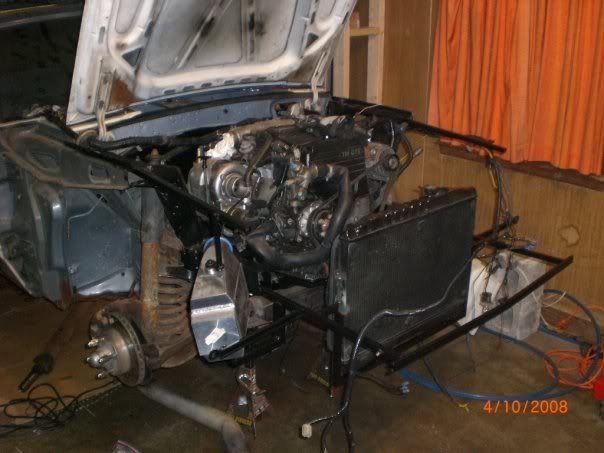

this is what it looks like with body panels off and engine in.

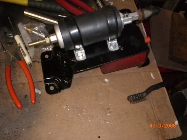

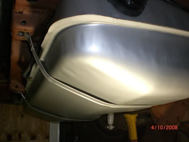

old tank was rusty so i went with a new tank and straps , cleaned and painted floor above it.
walbro 255

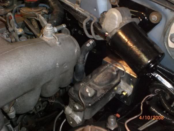

brake booster wouldnt fit with intake manifold so i went with manual brakes.
Here you can see the radiator hold down's

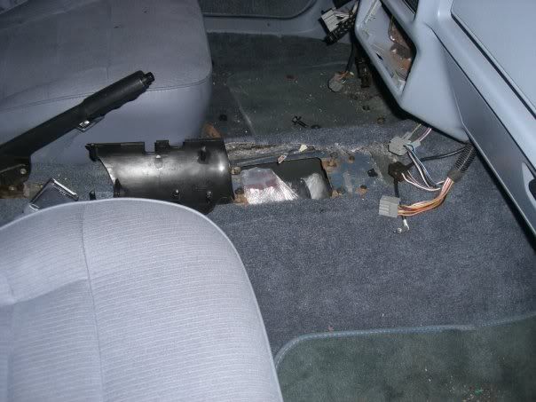

shifter comes through in good spot.
