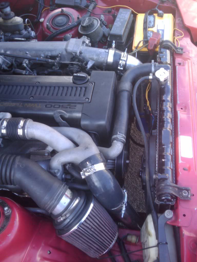

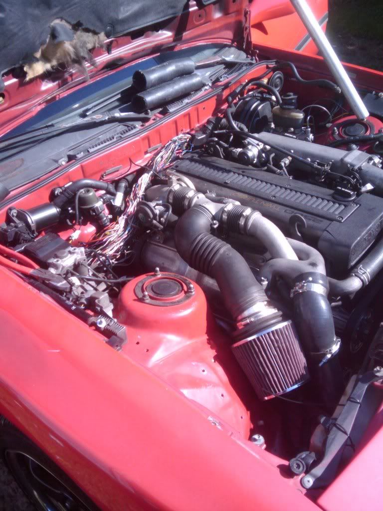

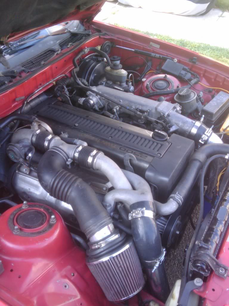

Well i got a little bit more done today, i installed my Wideband 02 Sensor into the downpipe, i hooked up the speedo cable and i installed my afc. Since my tach still dosent work i could not tune at all, so i will be getting a mini tach from autozone for the time being. i also found out my valve seals are bad because while iam coming to a stop i get a little smoke for about 2secs. then it goes away
due to my bad valve seals, iam going to pick up an extra head real soon from a friend and get new seals, mild port and polish, 3 angle valve job and some BC 264's, iam thinking of getting a new OEM toyota Headgasket w/ Arp Head studs, and a heat sheilding gasket from Driftmotion
