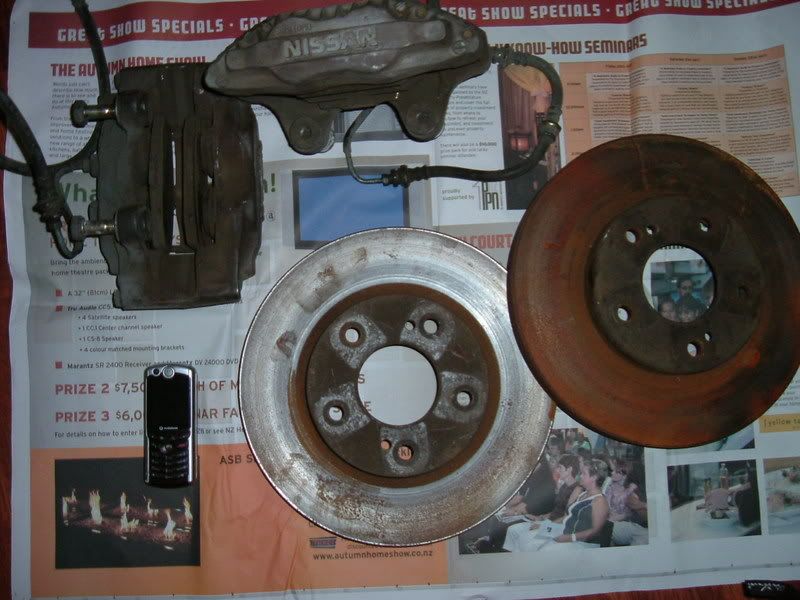

my 5 stud front hubs arrived big thanks to callum-wdebdy for those
Just about ready to install the z32 front brakes with the front hubs.

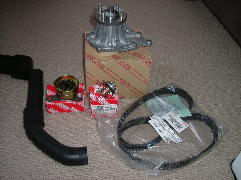

Some bits arrived from toyota, thanks Warwick (mr_revhead)

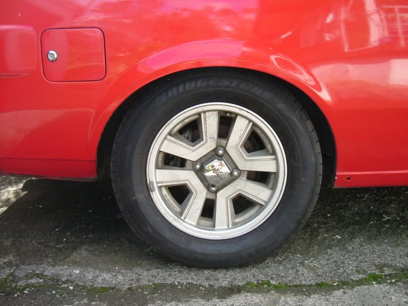

got some 5 stud rear hubs on their way from australia, so will be needing to find me some suitable wheels soon! not sure if i want to stay with 15s, or go bigger?

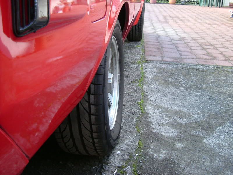

Just waiting to hear about a rear camber kit and then i will sort out the badass camber that i have.

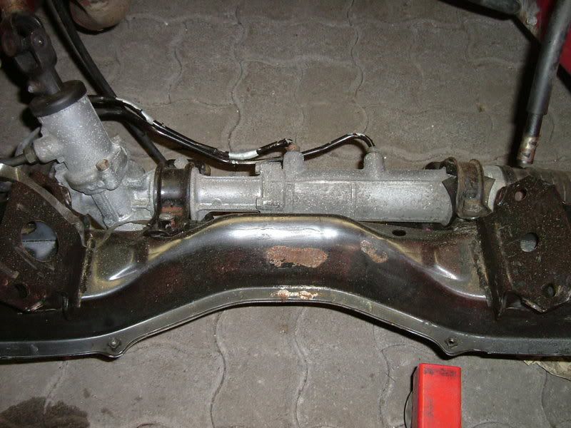

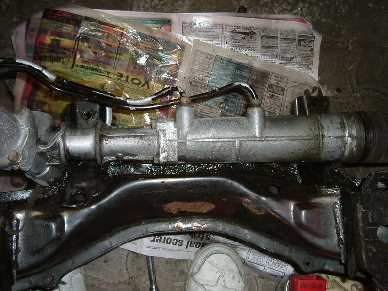

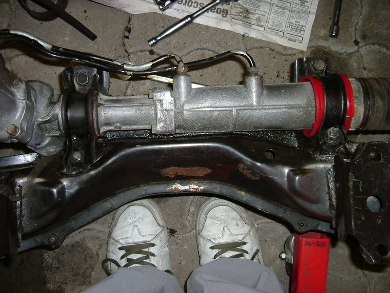

well i got off my ass and did some work today.

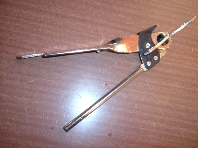

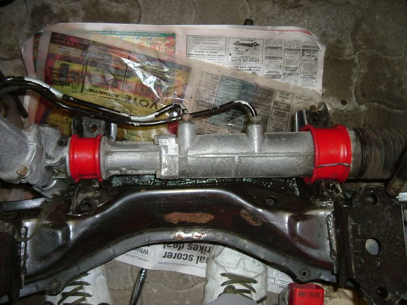

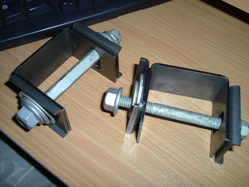

Tools required, craft knife, 17mm socket with rachet and bottle opener.

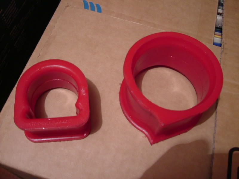

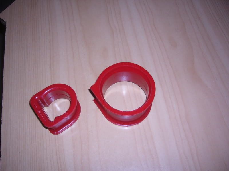

The bushes came as one piece with no cut in it (needed to be like this to be made) so you need to look at the stock bushes and decide where you want to make the cut. I could possibly get them cut before shipping out.

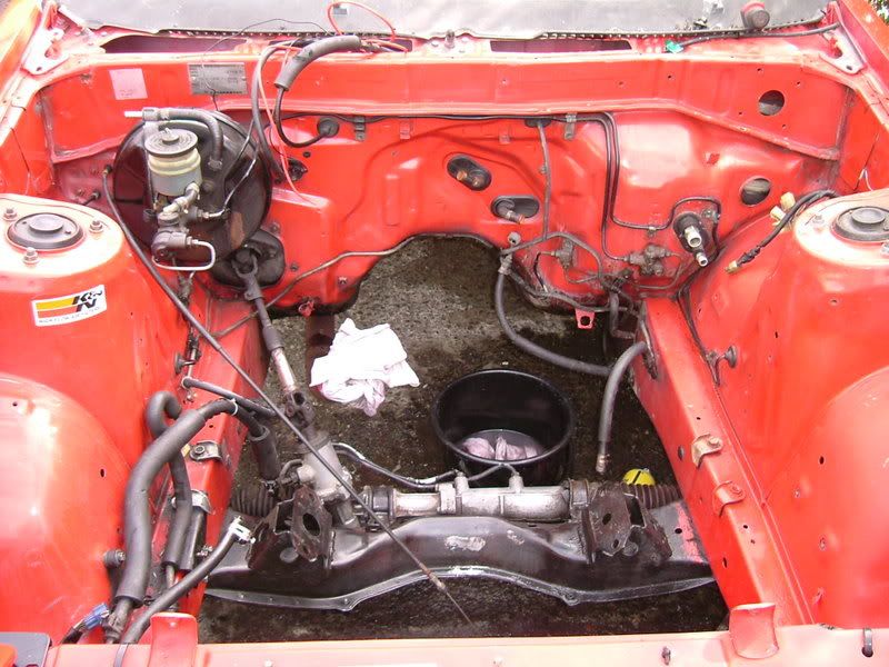

Undo the 2 17mm bolts on each bracket and then remove the bracket. lift the rack up a little bit and pull out the stock bushes.
I took the time to spray abit of degreaser around the place and removed some bolts which were stuck between the crossmember and the steering rack. (im sure you will find at least one there too)
Wait for the degreaser to evaporate and then slide in the new bushes.
Put the brackets back on and tighten the 17mm bolts back up.
More bush than Jesus!
then have a beer
