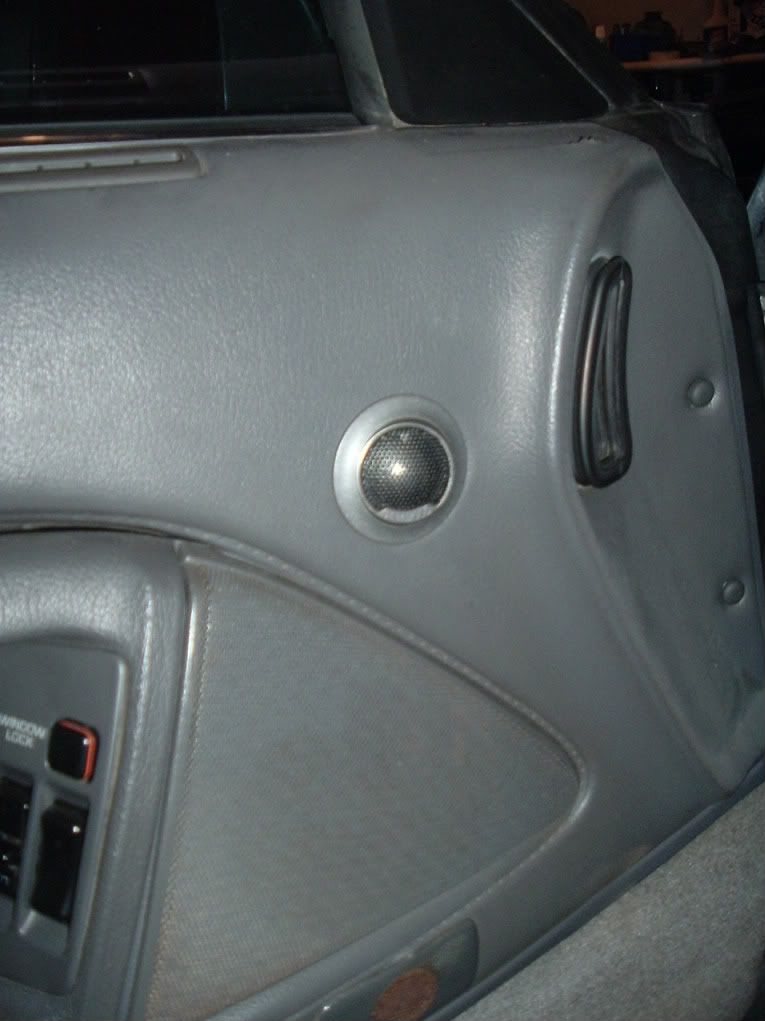

My idea for tweeters

OfnaRcR4;1360078 said:
Great placement but tweeters are really supposed to be facing toward the opposite side. Ie. pass side tweeter pointed toward the driver.
You're completely incorrect. Some tweeters sound better on-axis and some sound better off-axis. There is no hard and fast rule for aiming tweeters, just point it toward you and then adjust the angle until it sounds good. Every vehicle and tweeter combination will react differently.
DontRevMe
Aug 2, 2009
15
Gainesville
Proper tweeter imaging should leave the listener not knowing where the sound is coming from. This can also be achieved with time correction. There may not a set rule on "aiming" tweeters, but there sure are rules on how "not to" position them.
figgie
5,225
50
Twin Cities, Minnesot-ah
nah! That is dependant on a lot of factors.
romaniello;1360108 said:
They're not 'supposed' to be pointed the opposite way. With proper tuning these locations can achieve the same results.
tuning can only cover so much. Have to have a good foundation. ;)
Boosted. That looks like an intresting concept but you will have some major time coherence problem in the upper frequency range and that will ultimatly effect crossover and ultimatly, the sizing of the "stage". Add to that the massive reflective rear window and it might throw the sound off more than help it.
Someone mentioned tweets being on/off axis... Really? I would LOVE to see an off axis plot for ANY tweeter (or any speaker for that matter) for freq response. I will take just one!

The best sound stage and imaging is had when you are most centered in between, with most equal distance, and each tweeter is directly facing your ears. The ideal location for this effect is in the kick pod areas. Mine are simply surface mounted with a single screw.

im going to try and hide some in the door panel pockets facing upwards. probably use some 3M double sided tape or some velcro. Wont be so great for sound but id rather not cut holes in mint door panels or have big gauge pods to stare at.
In the supra, no such thing as equi-distance. Even on the kick pod/panel. There is about a 2 foot difference between left and right which in that little space is a significant difference.

92nsx;1390831 said:
Figgie...
Why not just put them in the door panel??
I tried that, it sounded really nice but was having some issues in the cross over frequencies that made the sound stage go all over the place. :)
