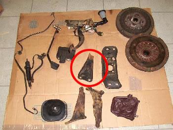

and so, i have taken another step into manualizing my vehicle.
this weekend i snagged everything out of my friend's parts car needed to do the swap.
I got a W58, brand new stock clutch and PP, and all that other shit i need.
and so, i'll be throwing it into my car once my questions are answered and when i find some time.
Questions:
1. I'm going to get the flywheel machined. What should I know to tell the machinist. What's the minimum thickness? I can't find the flywheel section in the tsrm.
2. Is there a outer rebuild kit around? I'm not planning on rebuilding the W58, but am going to replace a bunch of bearings and seals. Just don't wanna make the same mistake as my 'headgasket job gasket adventure'.
3. I was going to reuse the pilot bearing on the parts car because i felt it rotated smoothly in the crank, but i couldn't get it out cus i didn't have a puller. so i thought, i'll just replace it. I'm not sure how to automatic is setup up, what is in the crank where the pilot bearing would be? a pilot bearing? this a dumb question? yes.
4. Feels like these U-joints aren't perfect. Where can I get new U-joints?
5. How do i check the carrier bearing? It seems to spin freely. There is a little play side to side? Is that normal or is it shot? If so, where can i get a new one?
6. In where the bushing on the bottom of the shifter rides is this plastic-thin-like blue material. It's beat? where can i get a new one of these?
7. So what piece gets replaced with the green truck bushing?
8. What's this cut off?
9. My friend said that his dad did the clutch replacement and thinks it came with a new throwout and pilot bearing. The bearing turned nice and quiet. Do that mean it good? the car was drivin' for 2 minutes after the clutch job.
10. I guess i should fix my totally useless E-brake now that i'll be manual. Are the e-brake shoes adjustable? where's the cheapest place for these shoes, these things are damn expensive.
I'll be buying a lot of my crap on HorsepowerFreaks.com
Any more information is always appreciated and i'll probably have a couple more questions to come.
Thanks.
