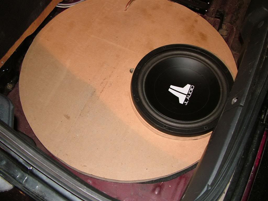

The pc is under the floor in the back, the Audigy USB goes through my volume control, to the eq then to the amp. I still need to carpet it so don't laugh but here is the sub and the pc is next to it:

more details about what components you used and how you mounted them? All I see is a JL Sub :)
Also... uh...
what kind of output to the amp? what kind of amps? 4 ch? mono for sub? details brotha! :)
brand/model of the screen? how'dyou mount it?
DETAILS MAN!!

You are too kind. I am definitely not the only one with a car pc. Check out www.mp3car.com if you want to learn about this stuff. I did a decent install on mine but there are some people who go way further and make custom dashboards with 12" monitors and stuff. The power supply I am using is a m1-atx 90w unit. The Opus 150w is another common one. I like the VIA itx motherboards, I have the m10000 but there are several new models that have come out recenty. Even though it's only 1ghz, the embedded processor is as fast a my AMD 1700+ at most applications. It plays dvd's well too.

Figgie: enter here
I'll get pics of the pc after I clean it up a little. There are about 20 cables going from the front to the back. Power, accessory, four usb, antenna, 12v to monitor, 5v to dvd, vga video, serial, etc... Sound is under the center console, amp is under the pass seat, tv/fm tuner and 6v regulator behind monitor.
