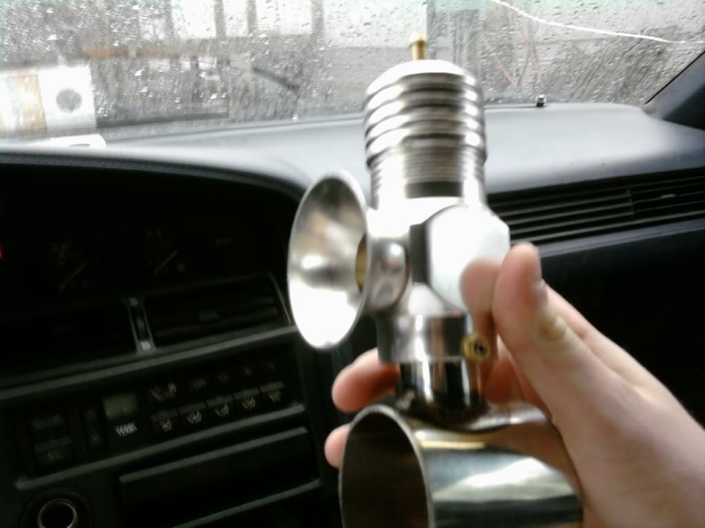

twist it..
its very tight, but it'll turn in place, trust me I did it to mine when I fitted my recirculating tip, otherwise it'd hit my foglight...
picture.php
twist it so the tip is facing toward the 3000 pipe? doesn't that make it not open when it needs to?

whoa whoa whoa, wait I just noticed something..!!!
you need to recirculate your BOV to the accordian pipe not the 3000 pipe..
you're gonna blow your turbo if you keep it the way you have it!
EDIT: upon closer inspection, it looks like you do have a tee going to the accordian pipe..
it doesn't matter which way it points, as long as the air goes into the accordian pipe. So cap off the line coming off the 3000 pipe, and run the tip of the BOV into the accordian pipe and you should be good to go...

i have it to the accordion pipe i think your looking at the pic where it looks like the hose goes to the 3000 pipe but the 3000 pipe has a hose with a plug at the end.

yeah, I was surfing off my phone so the pics were a little weird..
yeah, you got it the right way, but try twisting it, and you could even get away with using just a few inches of hose and no elbows or extra connectors..
so by twist it you mean have the tip face toward the 3000 pipe?
