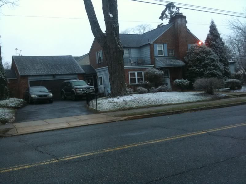

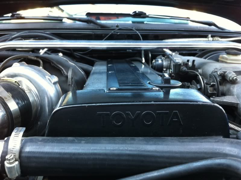

Spring time is here! Car is legal again! yay! Been tuning again. Not really any updates other than trying to troubleshoot the breaking up which is probably spark blow out due to old coilpacks. I've been busy with moving. Finally found a house and moved. Been extremely busy unpacking and remodelling the den. The new house is double lot with 4 bed, 3 full and 2 half baths, a patio at back, walk up attic, full unfinished basement but I'll definitely be finishing it with a wet bar and pool table. It has a detached oversized two car garage with its own attic. I'll post some pics in a bit. Since there is the meet at Undercover Performance there will be more updates soon as I'd like to even possibly finally get a tune and put some numbers down! Stay tuned!!

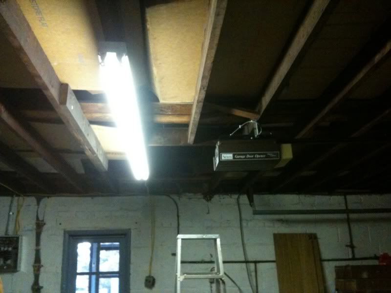

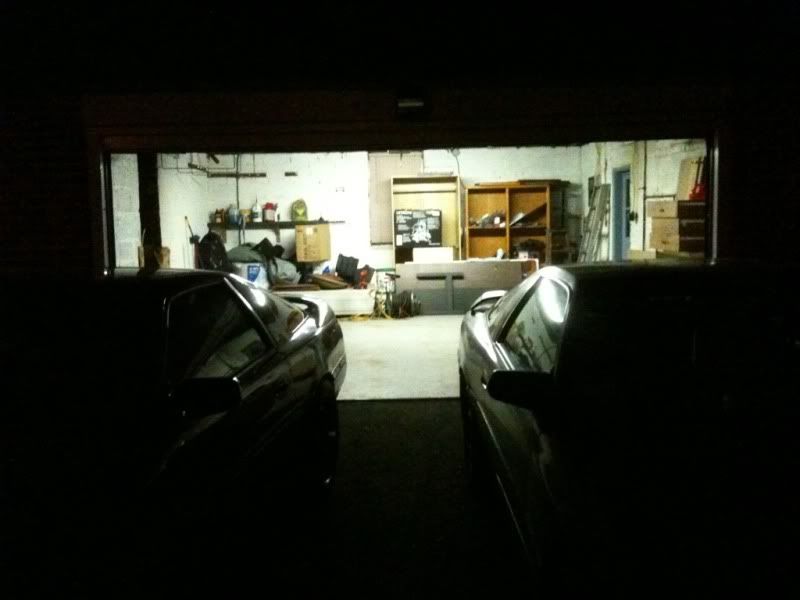

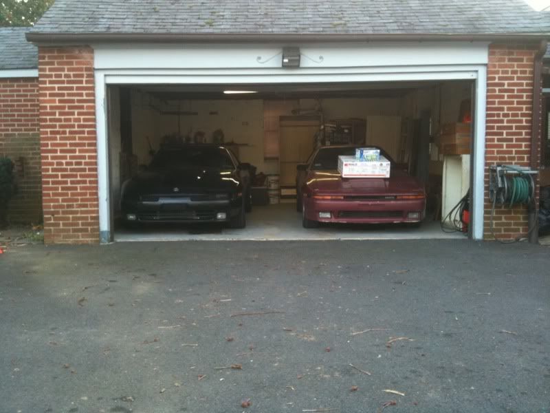

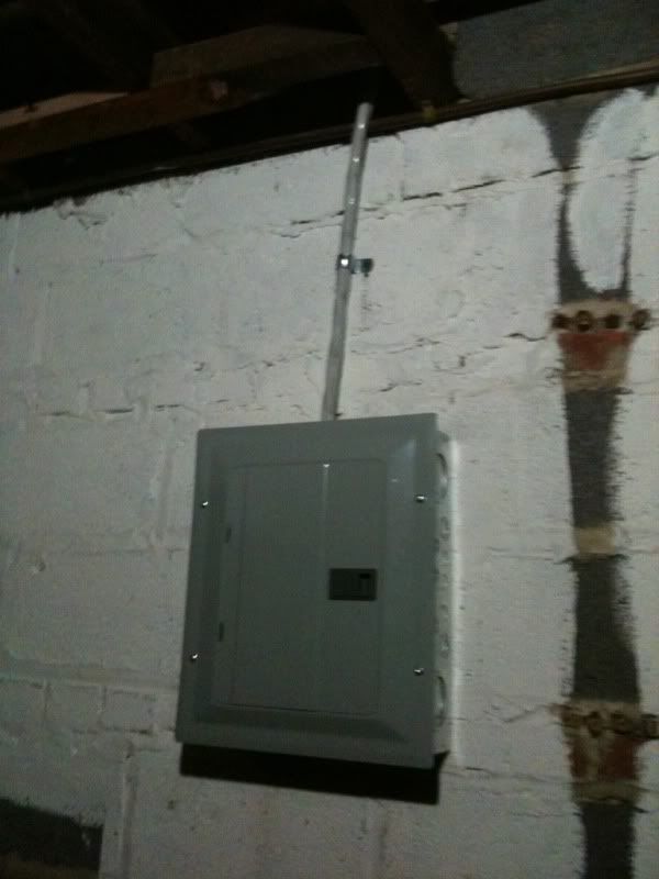

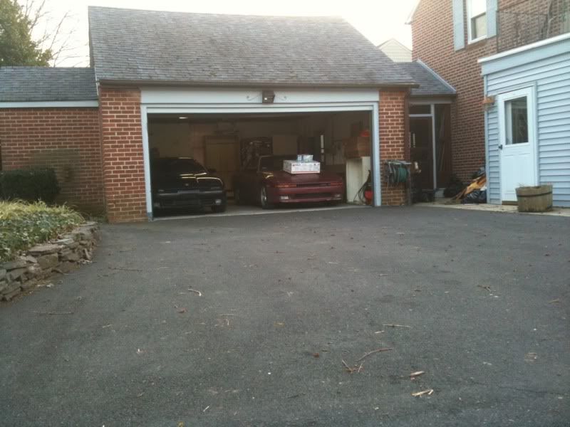

There were only 2 lines coming into the garage and one didnt work so we pulled both lines and ran a 100amp sub panel into the garage so I could hook up my compressor and eventually a welder.
Installed some better lighting in the garage cause it sucke before. Only little 60w light bulb.
Much better but not done yet. Going to be rewiring the whole garage and eventually the whole house cause it's still knob and tube.:nono:

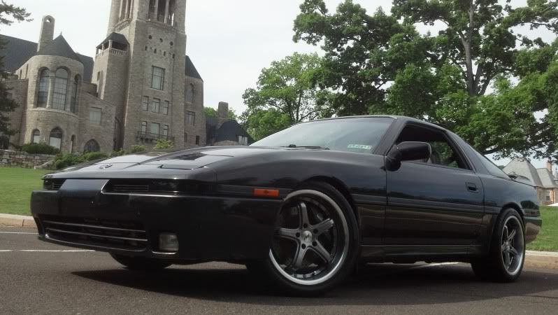

It was gorgeous out yesterday, friend was over and wanted to do something outside so we figured we'd close the gap on the plugs one more time to attempt to take care of my breaking up issue when boosting. Finally washed the car for the first time in like forever :nono:. Took some pictures and video of some cruising...I think that fixed the problem. We'll see.... enjoy!

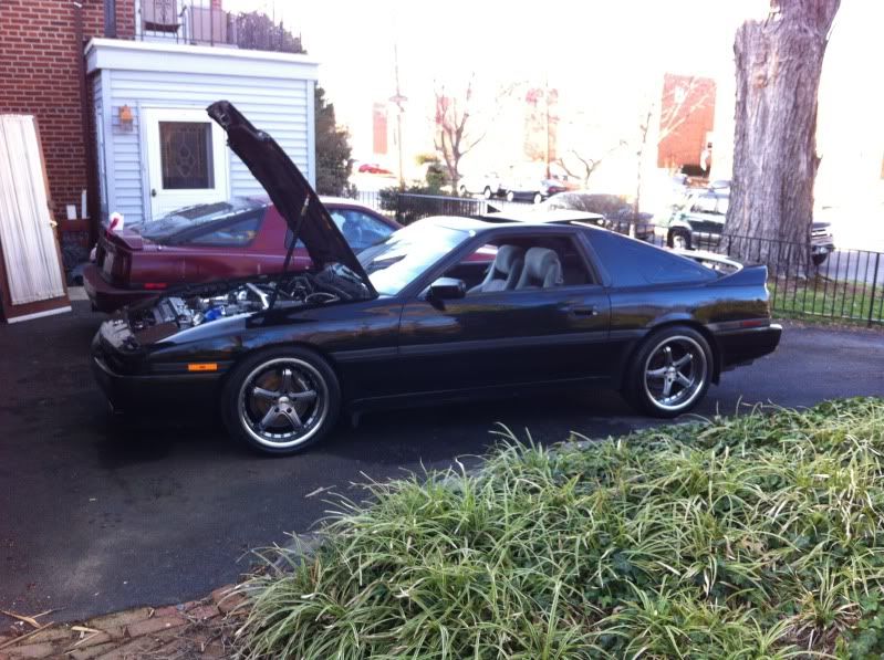

No updates other than window tint, fixed over heating issue and finally bought some hood supports. no more supra stick haha! some pictures

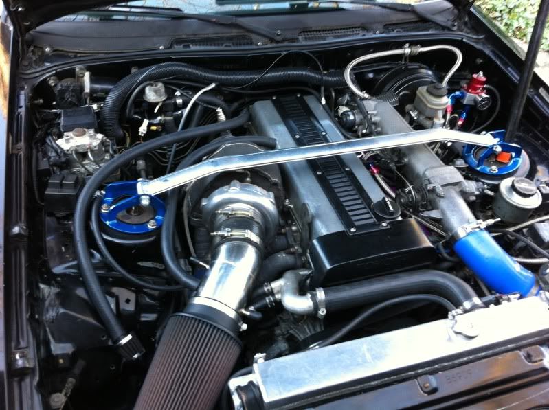

No tune yet. Called out of work friday to get it tuned. Get there a little early. He then tells me that we can't put the car on the dyno cause he broke it the night before tuning a GTR. He said they ordered new coils for it and it should be in on Monday. He said he'll call me Monday afternoon once they fix the dyno. He looked at my tune and we went for a drive. He made some changes to my map. He said everything looked good but the injector settings were completely wrong. I think I got them from Randy from BIC. I don't remember but he was surprised the car was running how it is with the injector settings all out of wack. He said the break up issue is def not the map. He said its dropping a cylinder everytime in the same exact location. I'll take some extra coils with me on Monday when I go. When we get it on the dyno we'll see if we can figure out which cylinder is missing and go from there. Hopefully some updates tomorrow.
