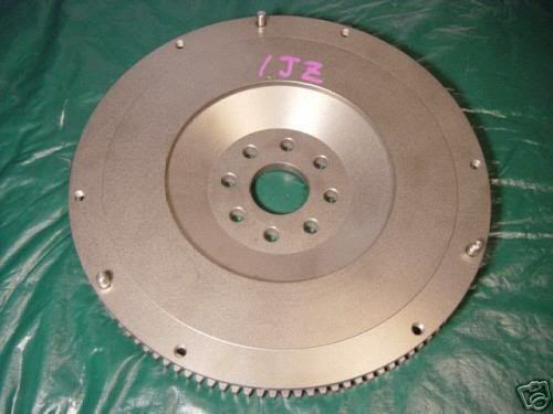

- Jun lightweight 1jz flywheel

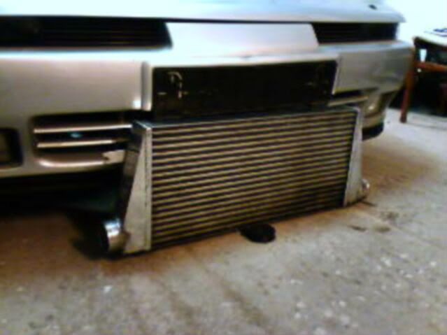

- Custom Intercooler 70cm x 30cm x 7cm
(from turbos to IC 2.5" diameter & from IC to throttle body 3" diameter)

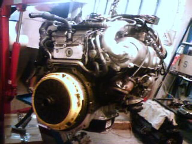

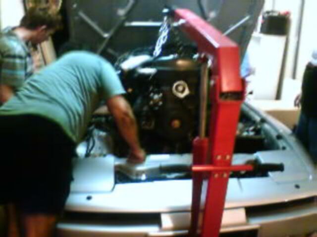

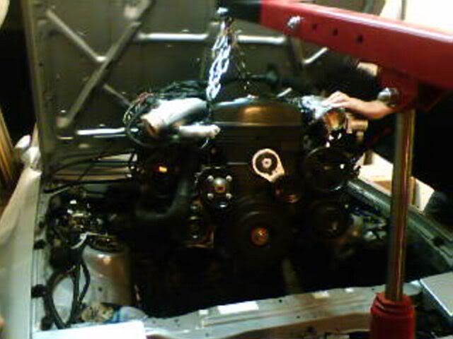

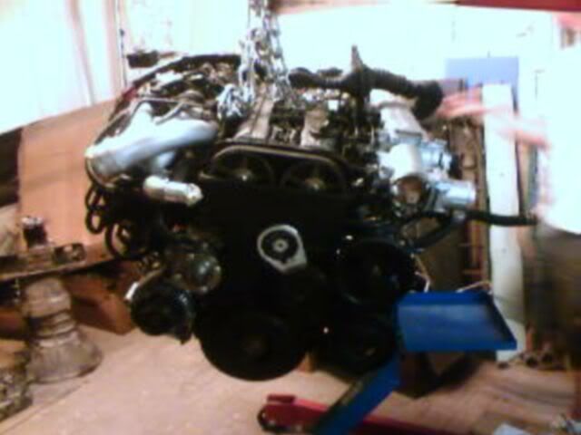

Some nice pictures of my engine bay:
My 2jz-gte is at a full BPU ++ mode at the moment.Can't give any HP numbers
at the moment...I will go to the dyno soon :sarcasm:
I made the engine wiring harness myself and every other electronic thing.It
took me a lot of time but it finally paid off with great results.
Later on I will update the interior stuff/electronics/gauges/and any custom
thing that I have done.
Hope you like my work,and any thoughts on my swap or mods are welcome,
cause through questions,doubts,searching,and practise we will learn how
to create or built better & correct built-up projects!

DETONATION666;997535 said:
Looks SICK! have any pics of where you had to pound the firewall?
No..Unfortunately I haven't.But don't worry...it's almost nothing!
Take off the brake lines shield that is located by the firewall.
After you'll see the brake lines (I think 4 or 5 lines totaly),and you'll
have to just separate them,like streching them half of them uppword
and the other half downword.You should leave about 3 or 4 fingers of space.
Then you hit slightly that area less than a 1/2 inch just to have some free
space for the 2nd turbo.I used oem 1jz engine brackets,not custom ones.

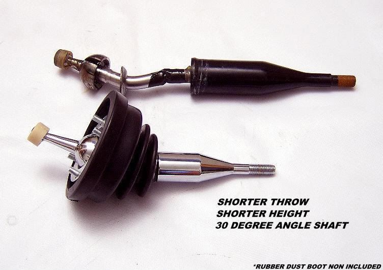

crazysupra2JZ;997564 said:
very nice man, gettin me excited to finish mine. all i need is exhaust....AHHHHH!
let's see some pics of this short throw shifter, and tell us how it is
Next day I will post some more pictures.
I'll show you the interior of the supra and I will take a close picture
of the short shifter...:sarcasm: It feels nice and you really make faster
shifts.The MK1 (mookeeh) from ebay is nice and ''cool''.But you'll have to
order the plastic bush from toyota and replace it.The MK1 bush will broke
into pieces after 3 months.Mine did...:icon_bigg
The toyota (from R-154 trans) bush will fit with a little mod.It has a little
bigger inner hole than the other one.
The toyota part number is 33548-31010,and costs 5 bucks....
