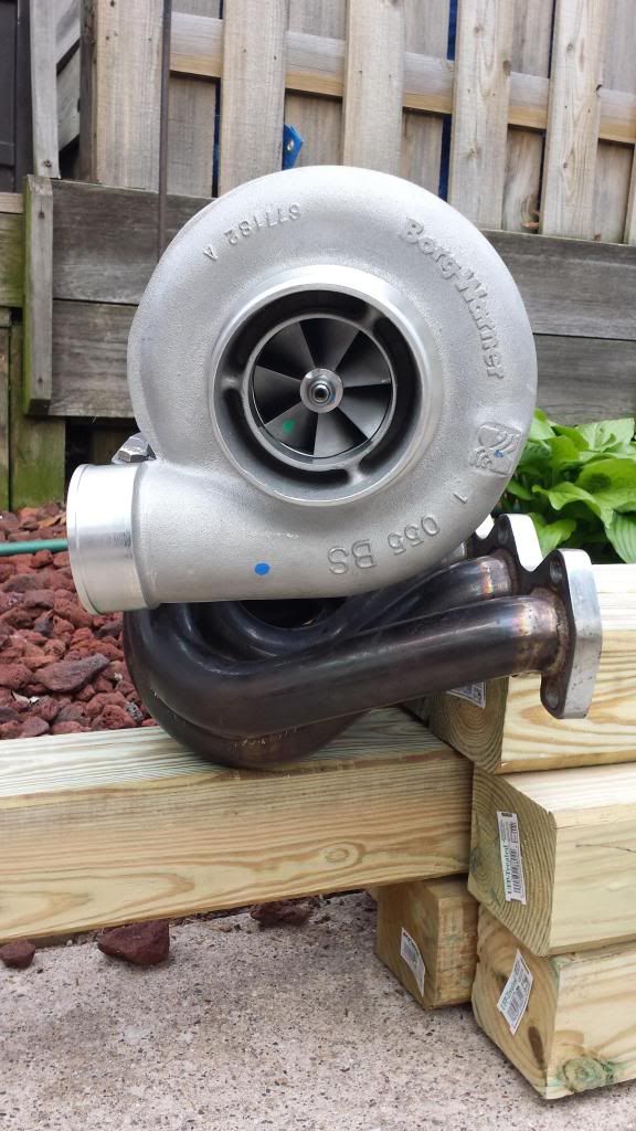

Originally bought a gt35r then decided against so I sold it and my buddy had a brand new borg warner s366 for sale so I had to to snag it up!

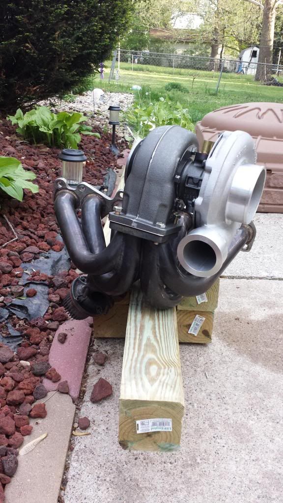

Now that I got my new turbo time to get all my other parts!
Got the turbos off and started to mock everything together
now let's put that on the car.

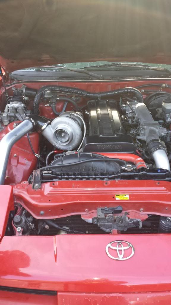

the way these cheap ebay manifold are made the runners interfere with the studs so the studs were cut and the nuts had to be cut down too. So the manifold was a pain in the ass to put on. The way I'm running the piping is this way because the compressor housing inlet was to close to the manifold so I want
To lead it away from all that heat.

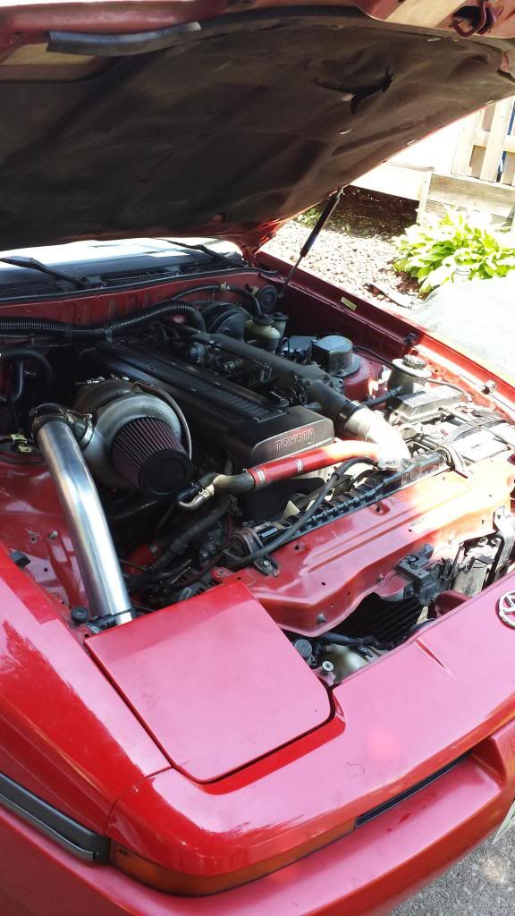

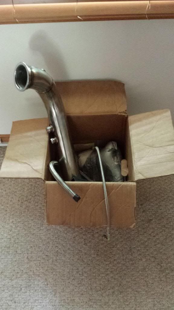

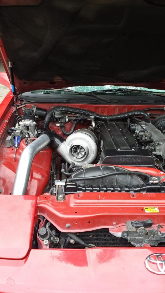

It's alive!!! Motor running no downpipe yet on it still needed modified for the monsterous 4.25 to 3inch vband adapter that came with it
[/URL]
going to be getting a intake for it next then going going to set up a catch can for It also right now it's open. Had a local fabricator modify the driftmotion downpipe ended up making it vband on both ends and eliminated the cat now the car sounds amazing! Had so catastrophic failure on first drive...
my fan shroud got caught in my fan and destroyed my mechanical fan and sent pieces through my radiator.:: angry :: so had to order a new radiator and decided to go electric fans.
I know electrics are hated on alot but a couple buddies are running ford contour fans which push like 3400cfm and has a shroud that covers my whole radiator perfectly and they have no problems so I'm going to try it. Car runs and drives perfectly normal. love the sound of the turbo spooling up and the sound of the 40mm wastegate dumping to the atmosphere is amazing!!
Boost is at 8 psi to get it all settled in. Next is some injectors safc2 and 400lph fuel pump. But I might up the boost to 12psi on stock everything my wideband says I'm running a little rich so might as well have some fun!!!

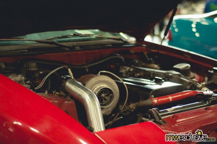

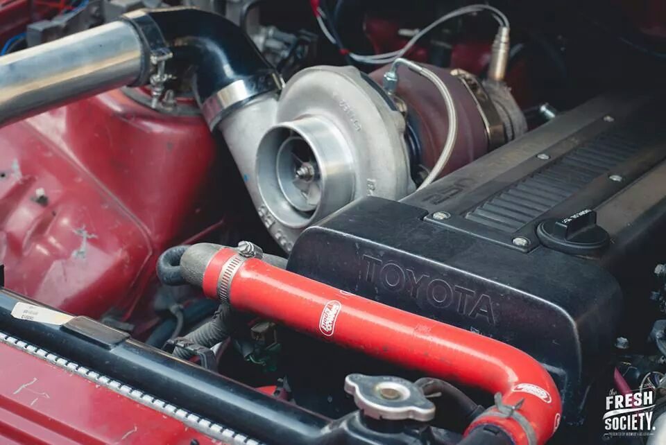

Just out of curiosity, why did you decide to angle the compressor so that the outlet goes over the strut tower with a sharp 90 degree bend? I've got a cheapy manifold as well but would like to avoid that.
kornfedmk3
Dec 9, 2011
140
des moines, IA
The compressor was literally half inch away from one of the runners. If i would of ran it down there I would of melted my silicone elbow in days probably. Ran it that way to reduce heat from getting to the piping keeping it up away from that. Plus it's different.

Weld a cast elbow on the compressor housing and you can run it down and away from the manifold. You can run pump gas on E85 rated pumps no problem but I don't think those injectors will be enough for 16PSI and that pump won't be enough for E85 boost. Car is gorgeous man! Good luck with the rest of the build.
