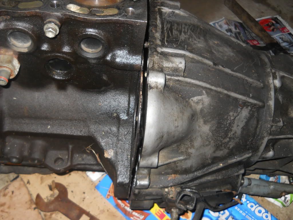

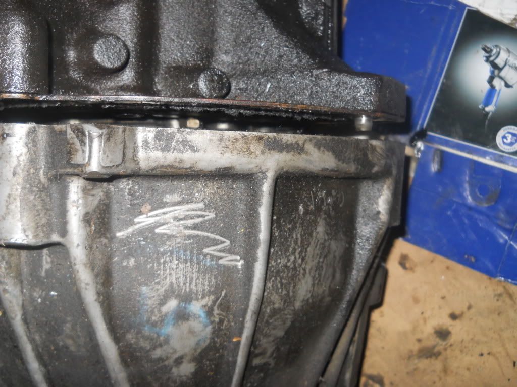

Well its about time to fill you guys in! Took the motor and tranny out last friday, I've been busy with school ever since then. So I couldnt get much done. I ran into a problem though. Now that the motor and tranny are out together, they won't separate. I took out all the bolts eng-tranny, dowel pins are visible also. But the transmission just spins, can't get it off the damn engine! Does the crank pulley have any affect on that? I was taking the motor out in about 20 degree whether so I was sorta rushing to get it out. Tried putting my impact gun to it while the motor was in, but its so weak!
Any suggestions on how to get them apart? Would I have to remove the flywheel???

NVM guys, just saw a thread and forgot all about the clutch fork. Gonna separate now before i go into work, hopefully getting it on a stand as well!

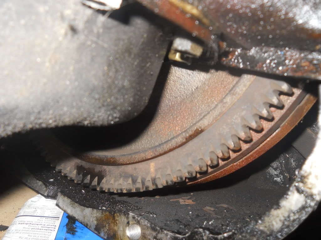

I separated the motor and tranny yesterday, but now I'm in need of a impact gun that has better torque than my 350 ft-lbs gun. I can't take the crank pulley bolt off just yet, once that's off I can get the motor on a stand and start the real work!

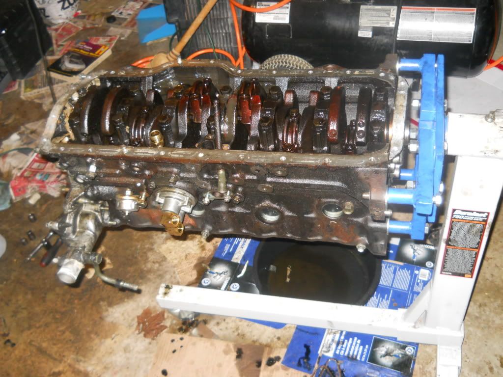

Got a couple more things done today! Popped of the flywheel and crankshaft pulley. Thanks to my dad's friend, his torque wrench does work unlike mine haha. Set the motor on the stand. Wanted to knock the pistons out tonight, but I didn't have any spare hose to make some booties. Will have get them out tomorrow. Hopefully send it to a machine shop this week, so I can order the right size pistons.. Still unsure with what pistons to go with. Thinking about the Probe set, it's relatively cheaper. Any suggestions???

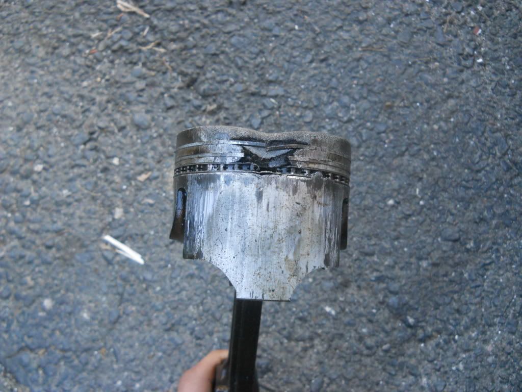

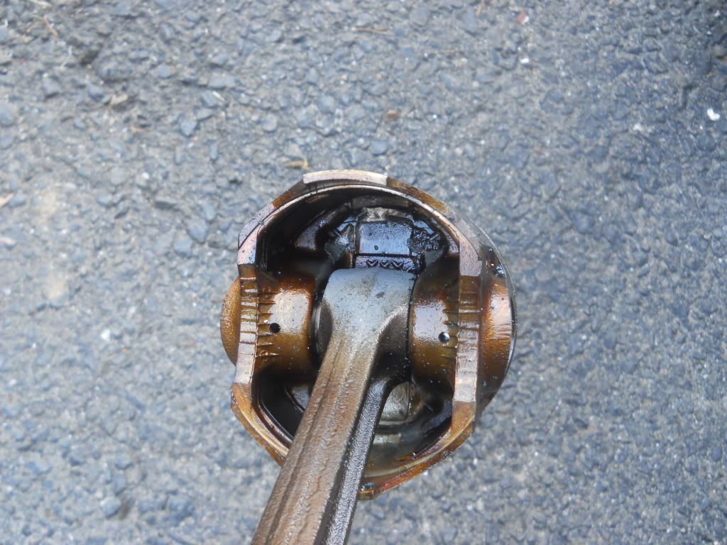

Very interesting, thanks for the info! Any other pistons will be a dent in my wallet, that's the only reason why Probes were on my mind. But I have to do whats best for the motor, no matter how long it takes. Got the motor down to the bare block just now. Working on taking every other little thing off the motor for the machinist to check it out. Got some pics of the damaged piston
As you can see in the last pic, part of my connecting rod that holds the wrist pin has turned white. Is that treatable? Would I have to invest in connecting rods also???
supraguy@aol
Well-Known Member
Dec 30, 2005
4,239
Atlanta
While the rod is a more durable part than the cast piston, I would tell you that a single replacement new is only about $40, or you could buy a used one from the classified section here for even less.
