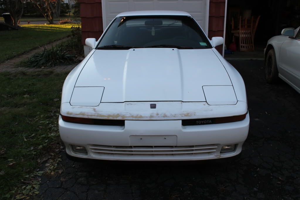

heres what it looked like at the kids house(sat for 2yrs with some moss-like fungus growing from the hood lol

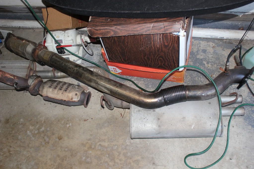

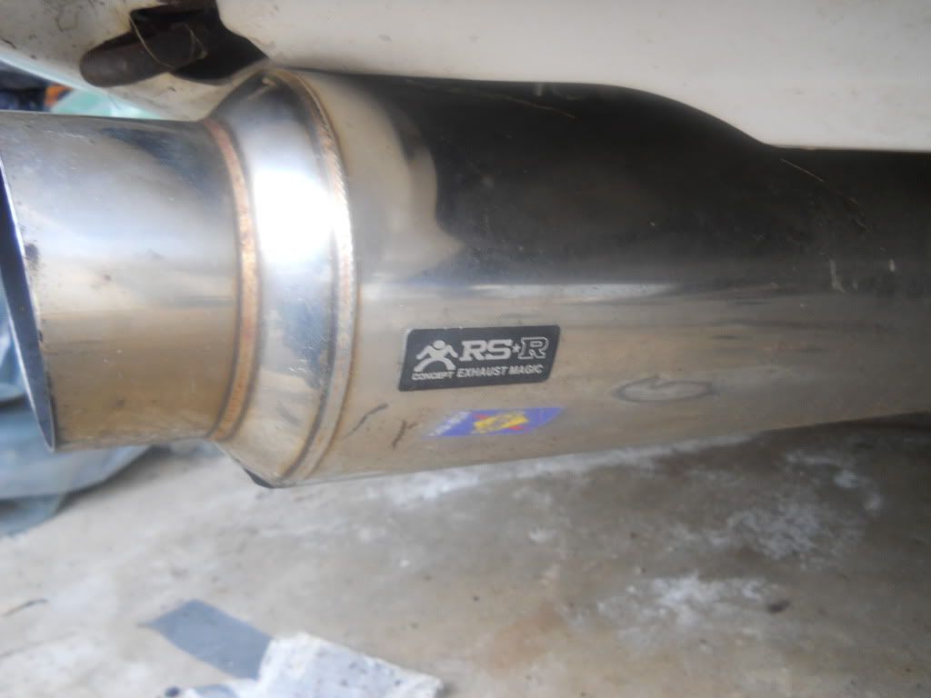

exhaust fell off when the car was coming off the towtruck
never realized it was an rsr.. i hear a lot of talk about theses exhausts on here

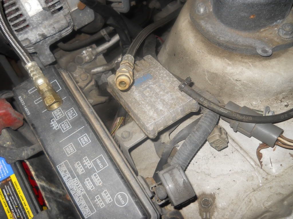

aeromotive afpr was here. stolen as well

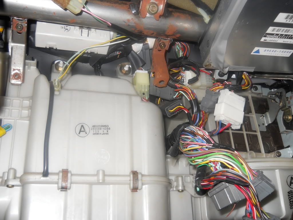

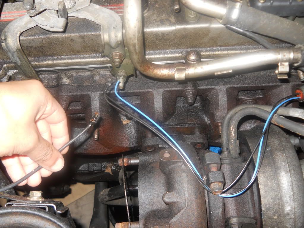

not sure what these wires on the right are for, pretty sure the one on the left is ground wire

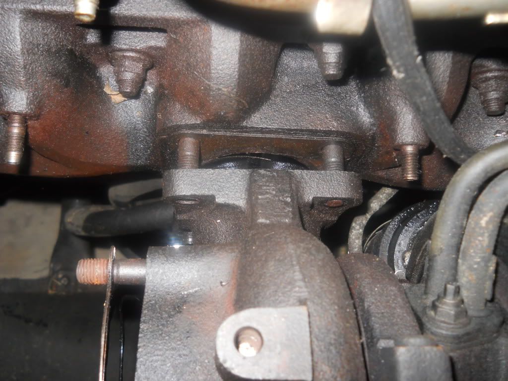

pretty sure they tried getting away with the turbo and exhaust. and wheres my dipstick!?
gonna remove the turbo when i get the chance, to see if they took that too, or could be located somewhere else on the 90?

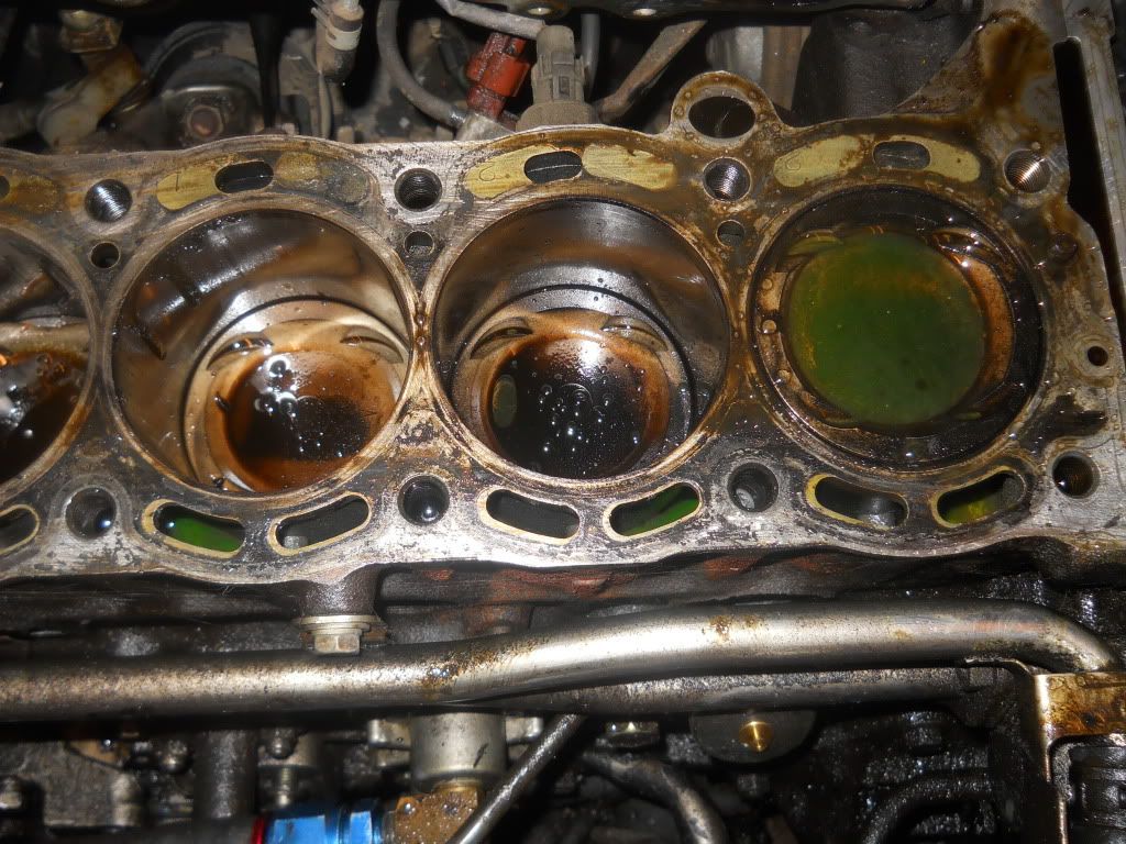

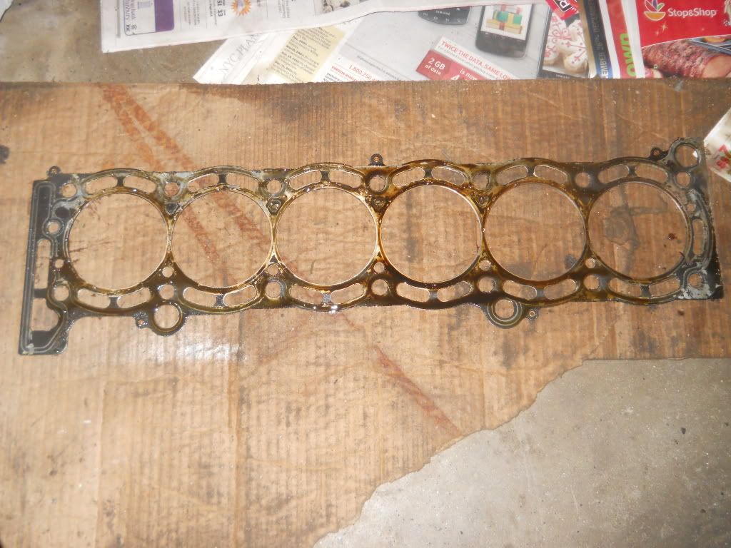

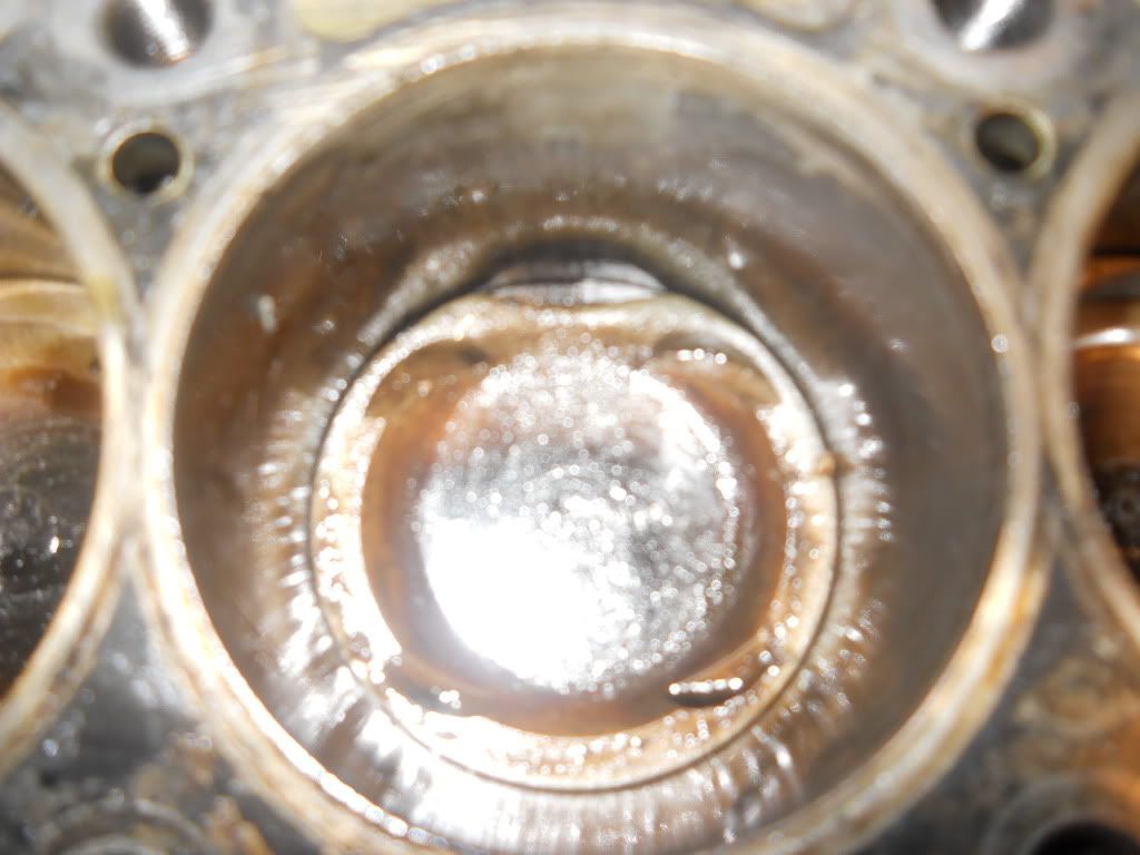

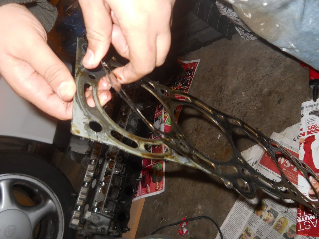

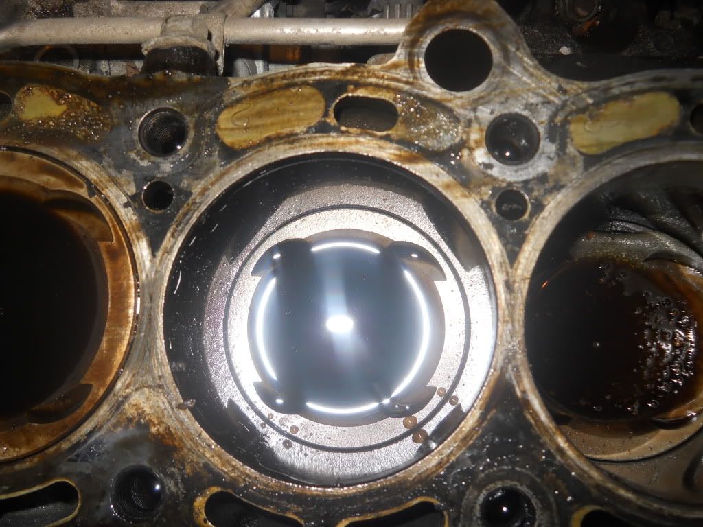

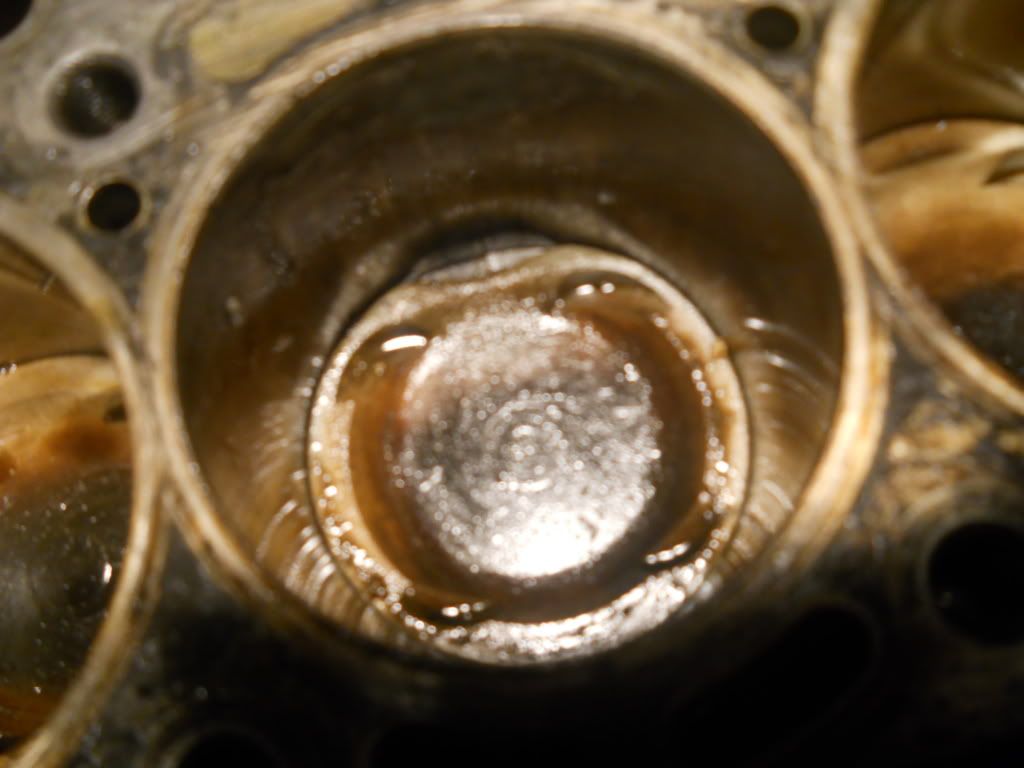

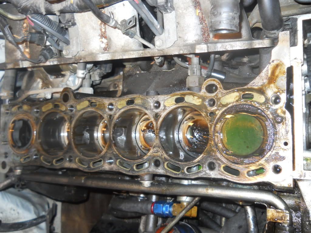

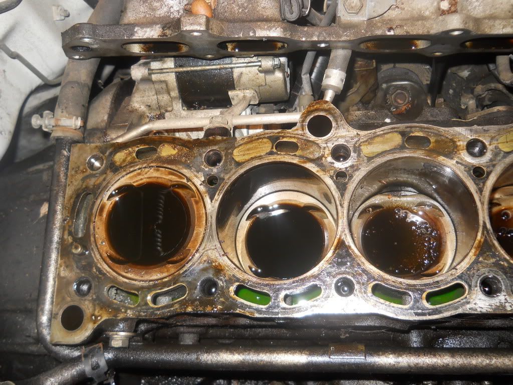

Got the head off just now, bad news. I've got a cracked piston :'(... Here are some pics
LOL could I reuse my MHG like this?!
1st 3
last 3
close up
#5 you could see it better here
mike86supra
Nov 26, 2008
127
connecticut
Correction: It's a melted piston thanks to Raven on my engine tech thread. First time I've dealt with a melted piston. Gotta check out the 550's, only possible way to check them out is with the car running I suppose. Until then, the motor is coming out. As of right now I'm low on cash, due to signing up for classes, and with work being SO slow. So I'm on a very low budget, but I can afford replacing that piston and another MHG (if needed)
If you guys have any input, I'm willing to hear 'em
Thanks guys!
Raven97990
Jul 3, 2005
230
Georgia
www.speedforsale.com
For having the injectors- you want to have them actually tested and cleaned, or you'll be right back in the same spot. Aaron at drift motion just got some fancy equipment, and we sublet out to a company in GA that's pretty awesome.
