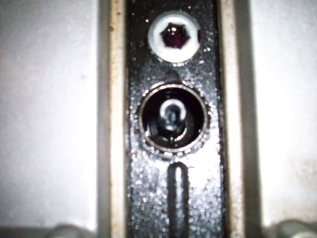

KORYTOYORTA;1475646 said:
are you sure maybe the oil made the wires stick, just wouldnt want you to pull the motor apart and find nothings wrong
Ya I had to basically pry the plugs out. 2 and 5 were the ones that melted the most so im guessing that those are the pistons that ended at TDC or closest. Heres a pic of number 2 that I could not get out and resulted in tearing the boot. Also the smell when I open the oil cap and the radiator match, kind of a really sour smell??
