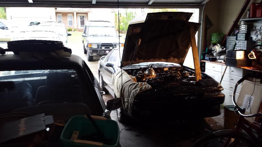

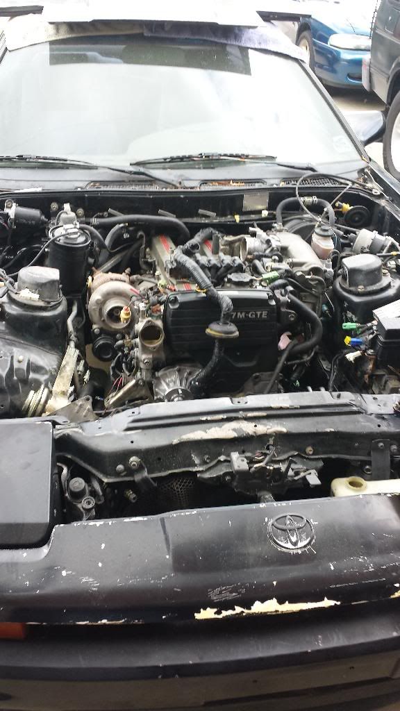

well made a lot of progress and I was waiting until it was running to post an update. I put the motor in the weekend before last then worked on it a little after work each day and finished it up last weekend. I couldn't get the car to start. I had fuel I had spark but she wouldn't fire up. I thought maybe I lost all my fuel so I put 3 more gallons in and nothing, sprayed starting fluid in the brake booster hose still nothing. I thought maybe I wasn't getting enough juice to turn it over quick enough from my sisters explorer so I pulled my truck up and still nothing. I had a co-worker (whom worked for Toyota) come over last night and he verified spark (which I had already done) then he asked how I installed my cam sensor. As soon as he said that I had a duhhh moment I had no idea it had to be indexed. He pulled it out and adjusted it and the car started right up on the first crank. I have good oil pressure, no check engine lights, and no knocks or squeaks. However I do have a few coolant leaks I need to chase down. All in all I'm very excited to have her running again and can't wait to start driving her again.

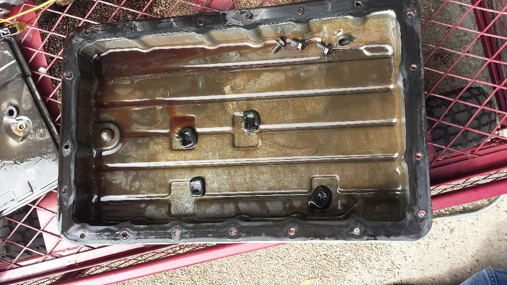

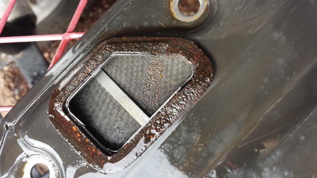

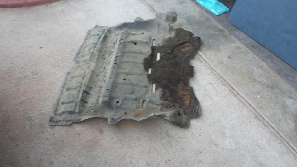

I was advised by my girlfriends father (who owned a transmission shop for a few years) to pull the pan off the transmission and check it before just rebuilding it especially since I plan to swap it to a 5speed later. It turned out to be in good condition, I opted to put a new filter in it and fresh fluid. This is what I found:
here's the motor moments after being back in the car:

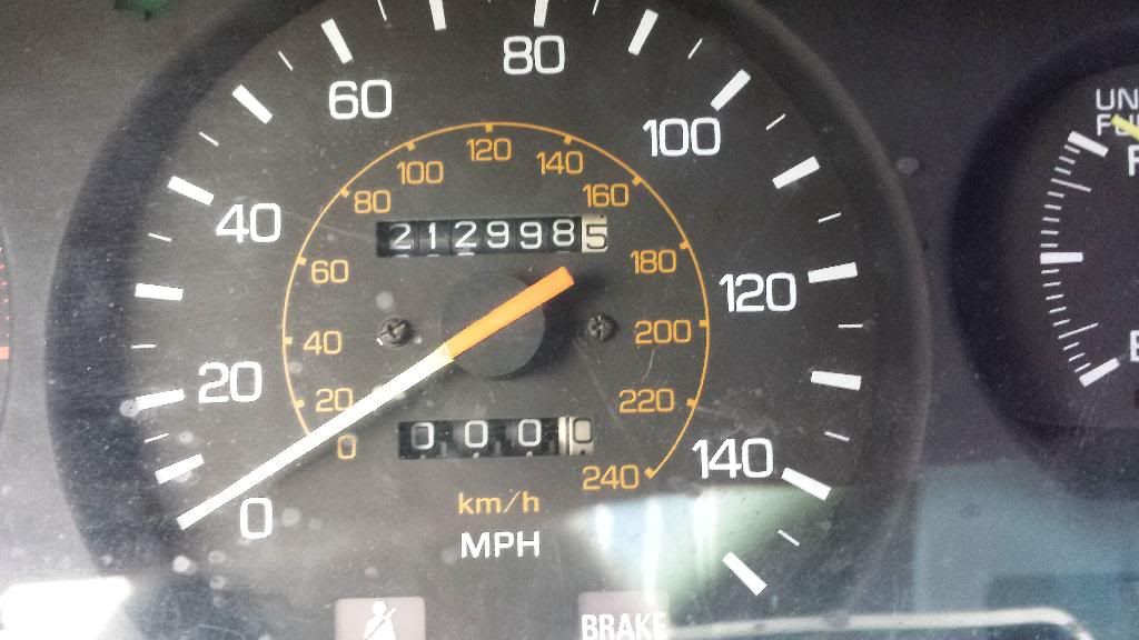

here's the miles at the time of rebuild:

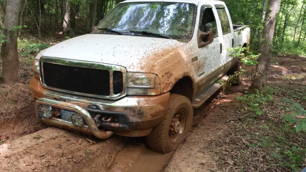

also took my truck off road at durhamtown. what I learned was that crew cab diesel full size trucks DO NOT belong in the woods on a trail. too long, too wide, too heavy. I won't be taking my truck off road again. We spent more time getting my truck unstuck than actually driving on the trail. The biggest problem was that it was too heavy to pull it self out of the ruts.
before.
after.
this is the first time I got stuck. Also the only picture I have because after the first time I was pissed off and ready to get out of there. Turning back was not an option.

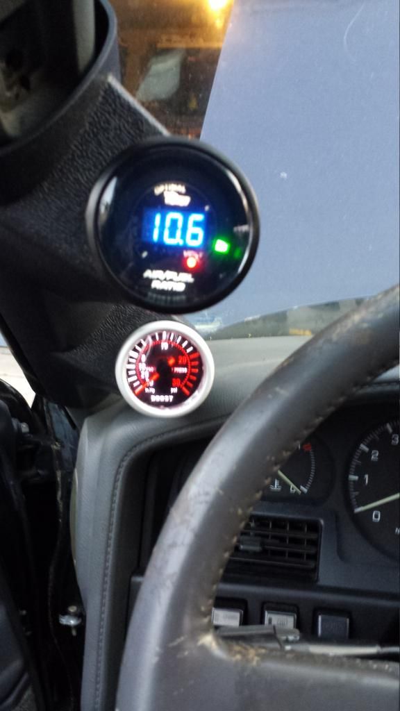

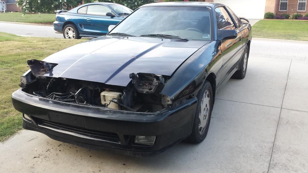

The break in period is about over. Recently I've installed the boost and A/F ratio gauge a boost controller and a turbo timer. I didn't realize how useless a narrow band gauge was. I set the boost at 10 psi and now the car seems quicker than my 98 mustang does. I'm happy with how the car is running now so I turned my attention to the front end. I found that the metal part under the nose piece was for an 89+ which prevented my replacement 86-88 turn signals and grill from being installed. I replaced that and re-painted the nose piece. The headlight hinge was broken because of the wreck so I also replaced that but the radiator support is bent so the headlight doesn't sit flush. It looks much better but still not perfect.
before
after
