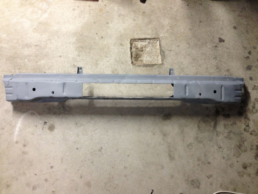

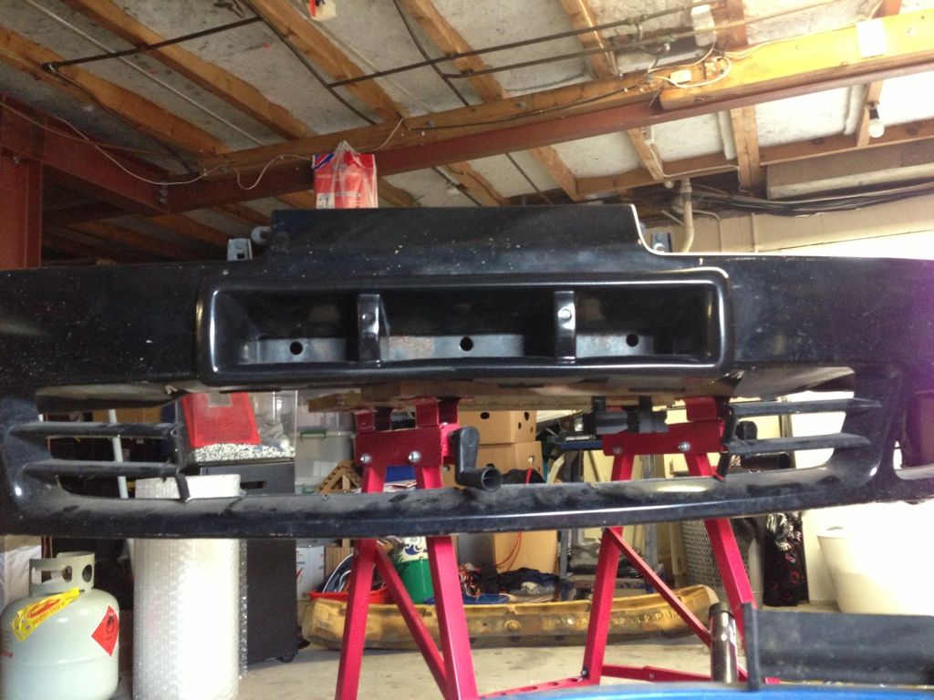

Been cleaning the garage up but got distracted with installing the replica Turbo A Air Duct.

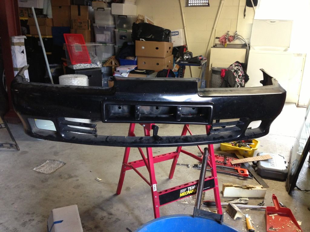

I now have three bumpers - cutting this one up to avoid ruining a better one. Once I'm happy with the placement, i'll be cutting a good one up :eek:
MrOizo
May 24, 2008
205
Auckland, New Zealand

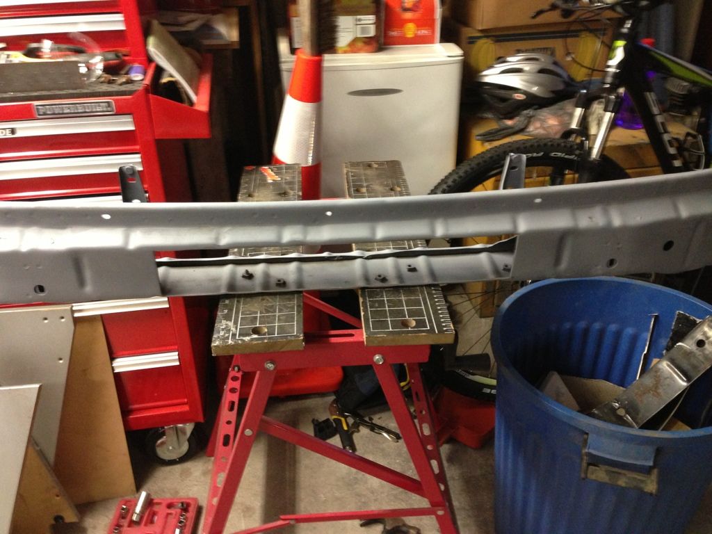

Have finished cutting the holes in the bumper skin, foam and now the crash bar!
Next step is to have some one fibreglass the vent in properly and have it all painted up :)

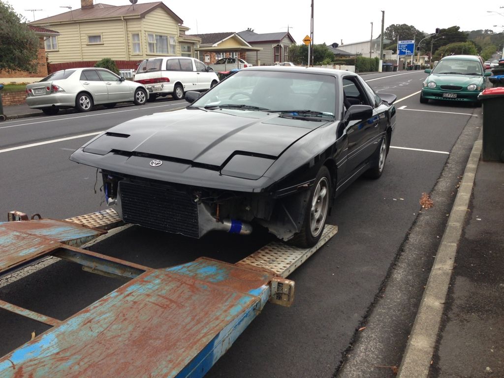

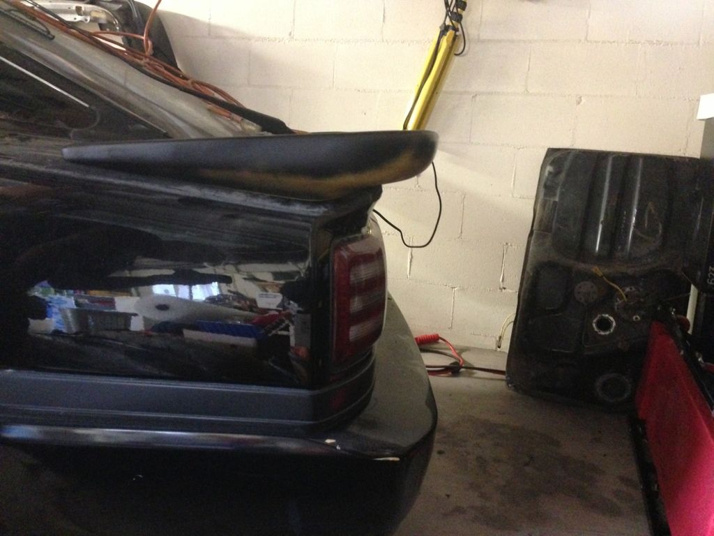

Well! It would seem things are progressing. I have fitted a Bomex Whale Tail to see how it looks - looks awesome to me! Just need to have the paint matched and fix permanently.

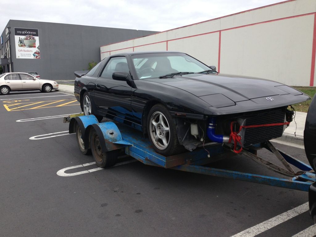

Today a friend and I loaded it up and dropped it off to have the front pipe done... Very excited!
mytmk3
Oct 16, 2007
643
christchurch
looks good mate you manage to find the wail tail locally or import it? wanted one of those for ages couldn't justify the $850NZD it would cost me getting it shipped from shine inc taxes
MrOizo
May 24, 2008
205
Aww cheers!
I got mine from Suze on the SCONZ list. I didnt think twice about it :p Just need to get it painted now.

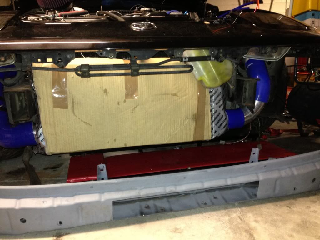

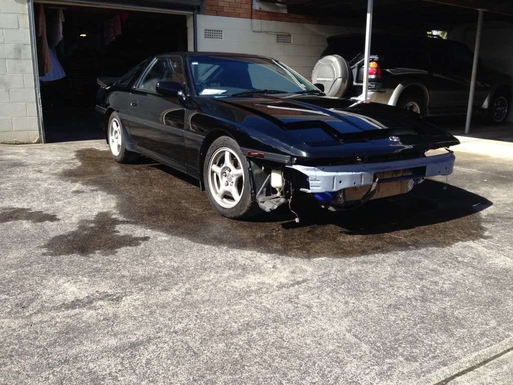

Well! Pretty sick today so seems like a good time to do a update.
nite b's work on the front pipe is so nice! Realised i havent taken decent photos of it. Will get them a warmer day :)

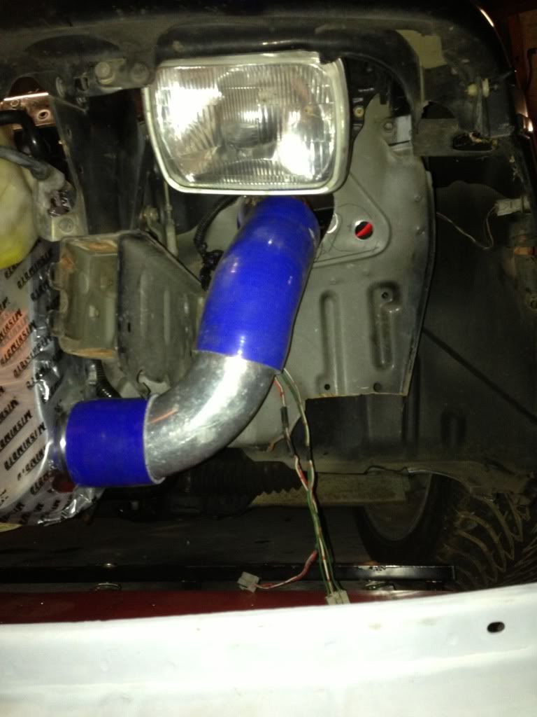

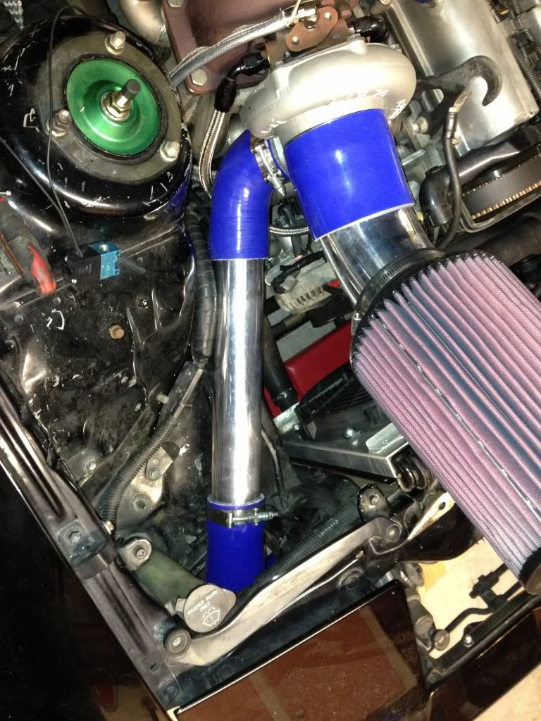

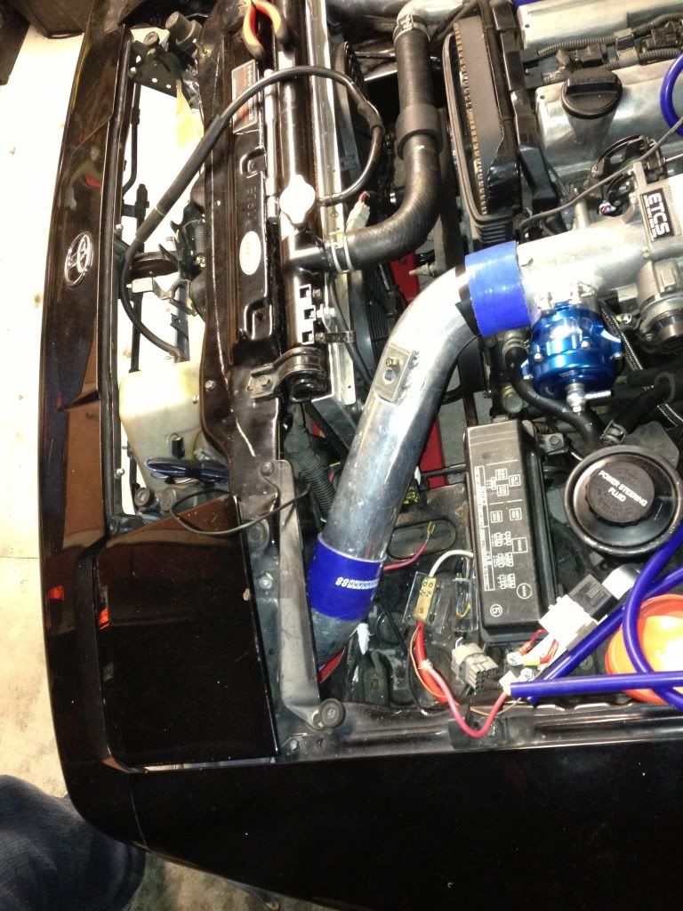

In the last two weeks, I got a new intercooler from 41! Before that had a friend around and he used a panel punch to cut a 4" hole below the LHS light - so easy with the right gears!
Started to dummy fit:
[/img]
Just need to mount the intercooler properly and can finalise the piping :)

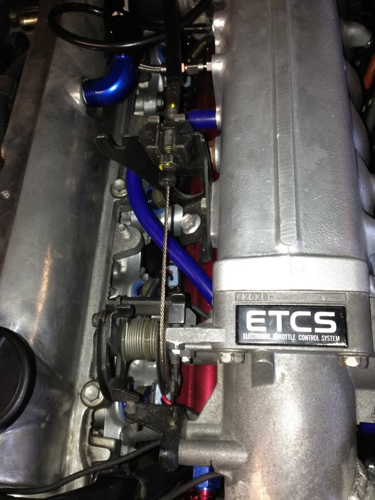

Long time no update.. Too much work and sickness getting in the way! :p

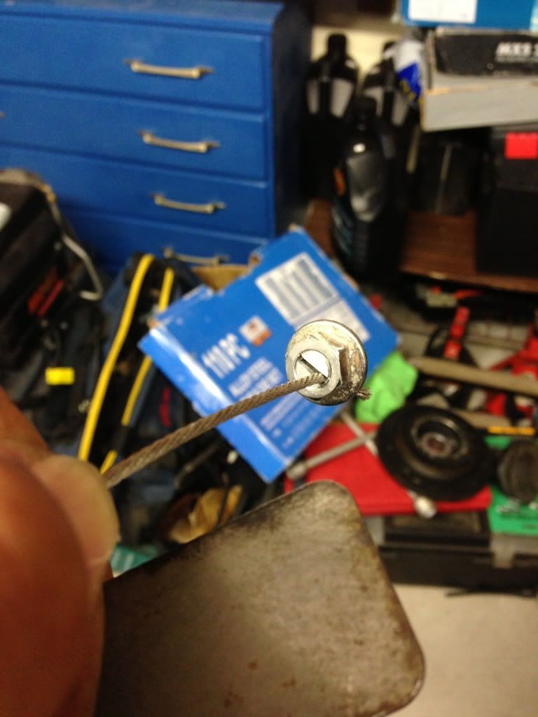

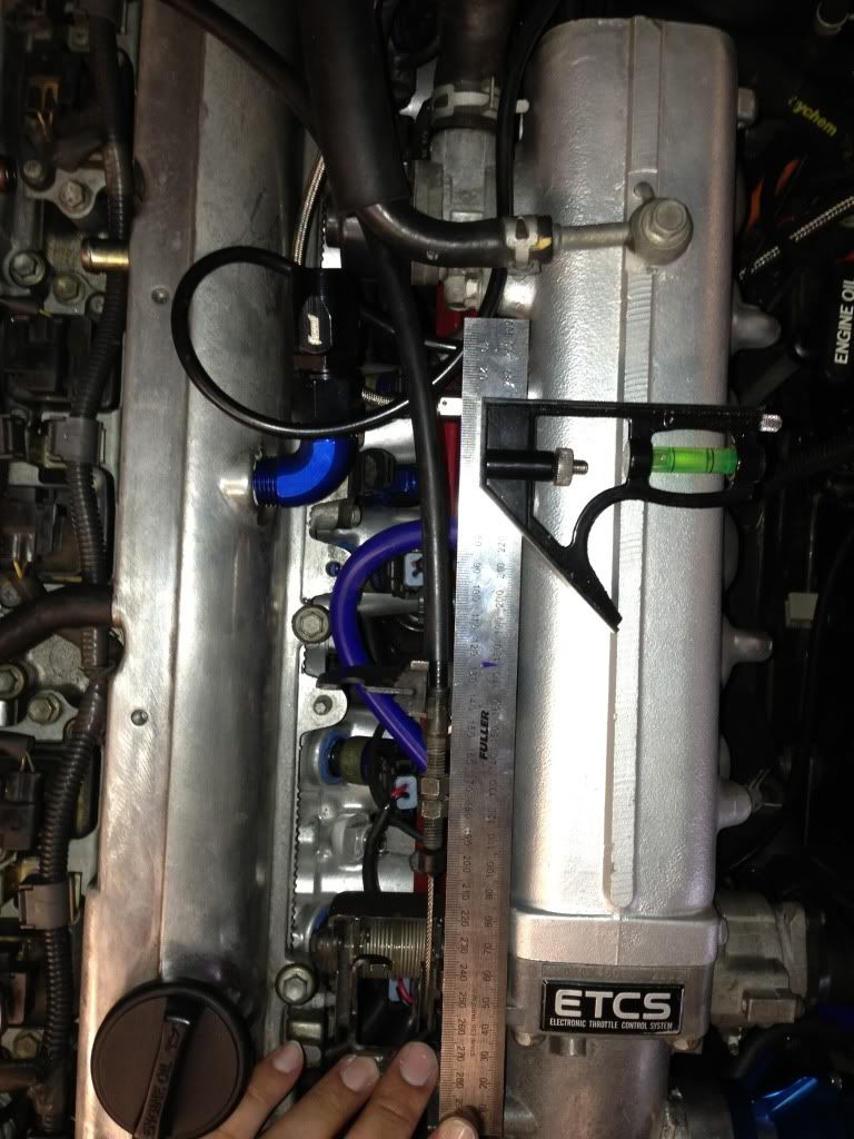

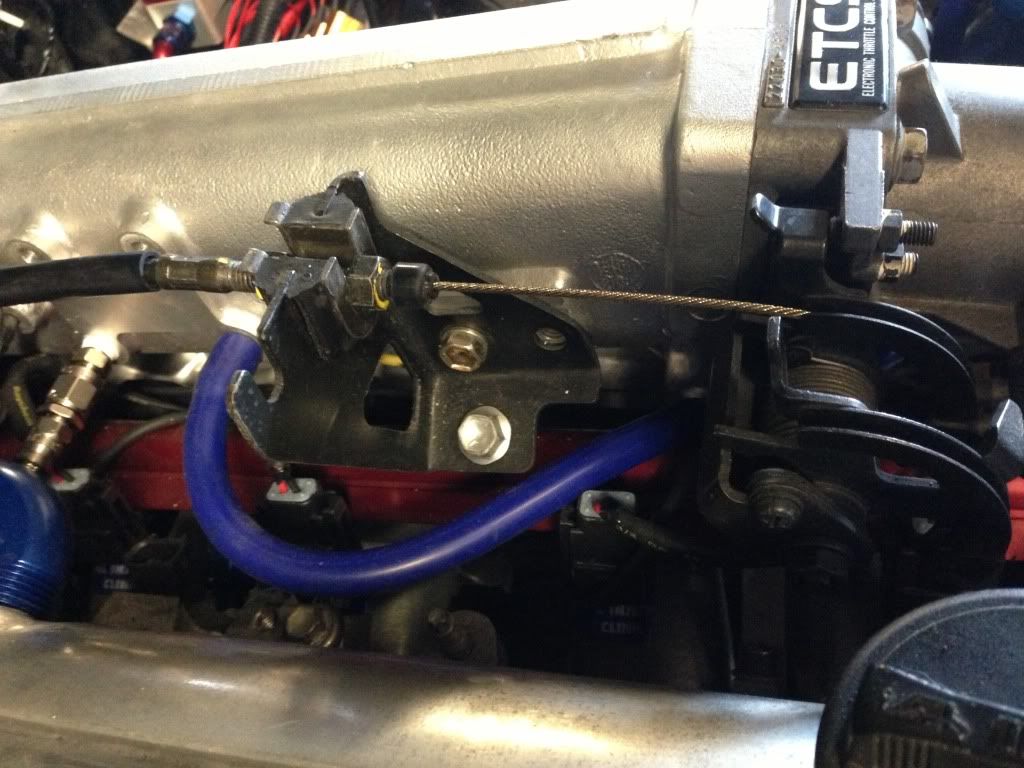

With the 2JZ in the JZA70 chassis the stock throttle cable is JUST too short to work properly. I know i needed the cable itself about 30mm longer.
I ended up with a throttle cable from a Camry from a scrap yard. This was about 400mm too long so i had the awesomest idea of using the cable from the camry using the stock outside cable (what ever its called)
After i cut the cable i needed to fix a stopper to the end.
Had an idea of using a nut and bolt combo - a cut down the center and having the flanges of the nut crimp the cable.
Chur to the choice!

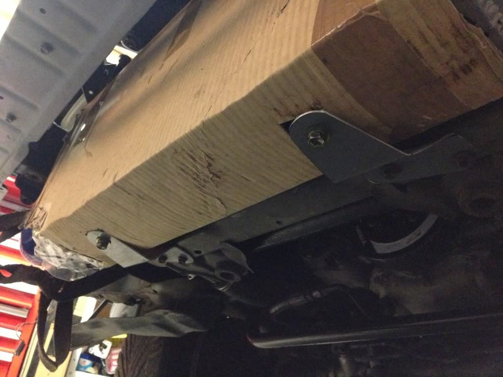

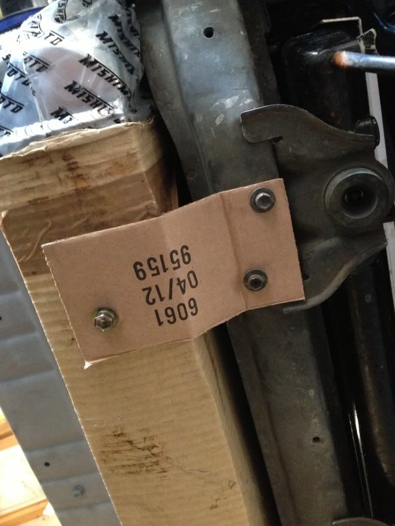

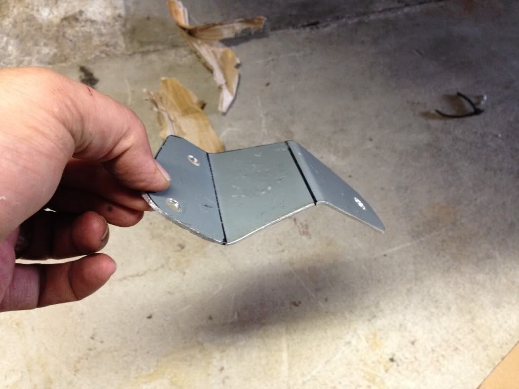

Another thing i managed to sort today was the lower mounting points for the intercooler.

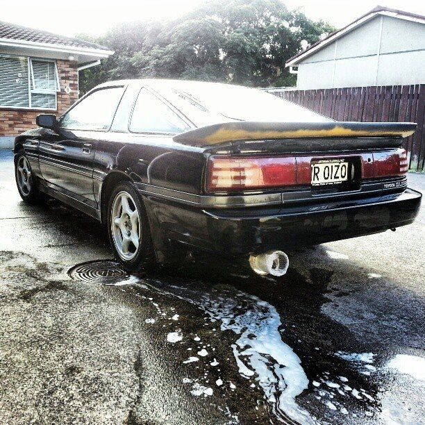

And earlier, i took it out for a wash! Whoooop!
